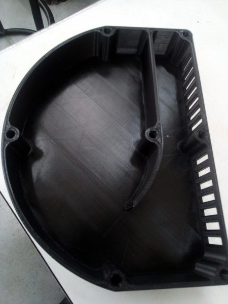

part is made out of solid glass filled nylon which is not a best material for a job.
ill call it sample prototype.
ill try and explain it.
air and water enter trough fins and hit a wall.
water is forced down while air goes up.

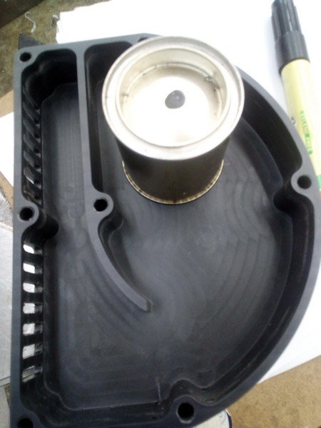

Post by Jadranko »
water is forced out trough holes at a bottom

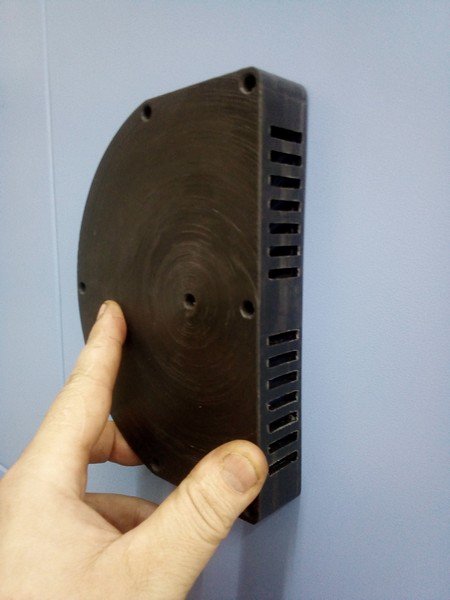

Post by Jadranko »
this is how it suppose to be mounted on a side of a canopy

Post by Jadranko »
this should be permanent fixture as its not necessary to open or close anything as on other-ones on the market.

this is printed version of left hand one.
it feels strong.
file ill upload soon
