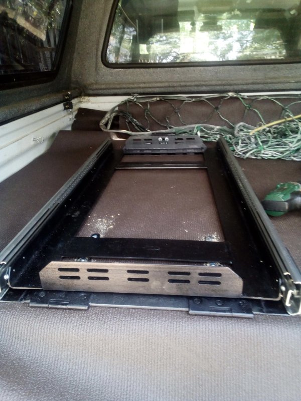

for 50l alpicool F/F on a top of drawer.
i still have to make/cut/install slide limit and tilt stop.

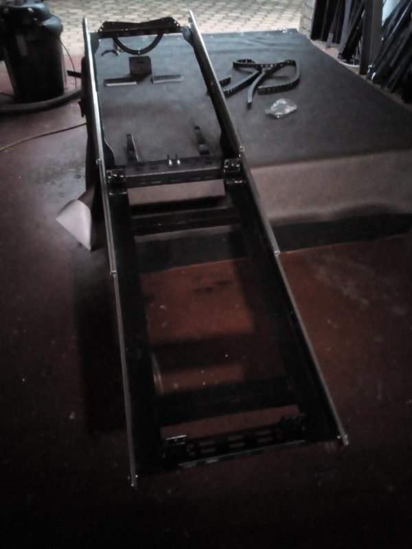

so far this is where i am

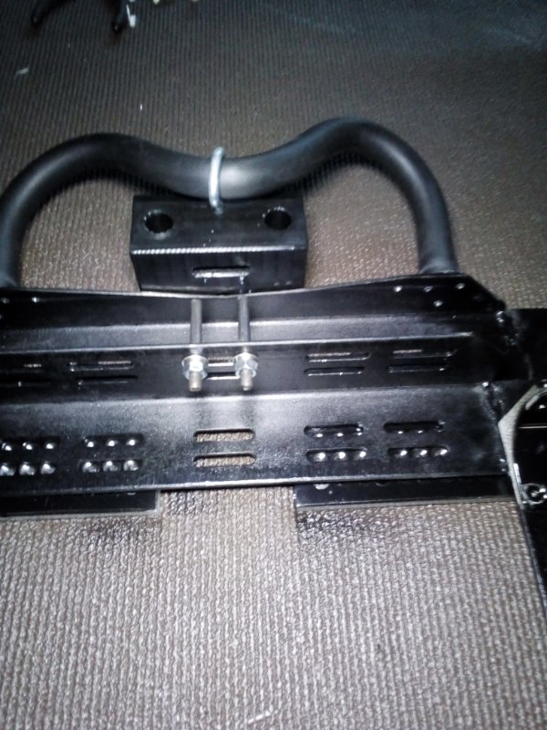

lock block, made out of polypropylene , to prevent any movement while driving.
speargun rubber(until i get struts)to limit a tilt and absorb shock while slide is opening.

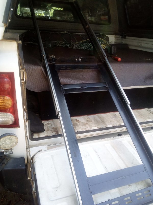

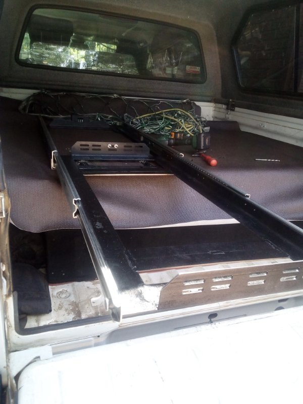

update:
almost done

Post by Woolf »
Like your drag chain
Jadranko
Has thanked: 92 times
Been thanked: 154 times
Posts: 305
Post by Jadranko »
i was given idea by some good people :D
