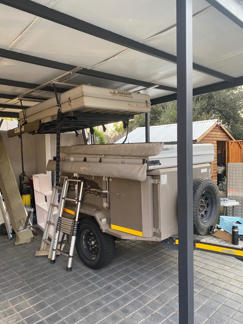

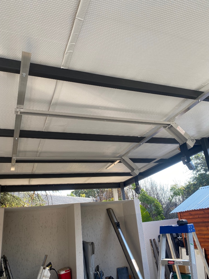

First was to get and install a Fredlin hoist to lift my Bundutop and roof rack off the car. Sometimes, usually when I travel solo I just take the RTT. If the wife comes with we often take the trailer with its own RTT so it is not necessary to have the RTT on the car. I have another roof rack that I put on the vehicle when I take the trailer to carry my solar panel(for the car’s dual battery), Jerry cans, mount my shower cubicle and awning and pack wood if necessary.
The installation was fairly straightforward and the system works well.

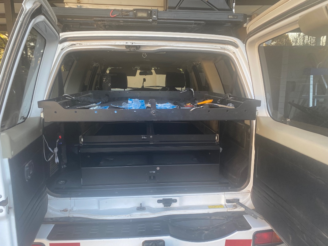

I am a great fan of drawer systems. I had a Frontrunner 6 cub box system with a sliding cargo top. I felt that a double decker system would be better so I removed the system with the sliding top and installed a 6 cub box system on the base of the vehicle, then refitted the 6 cub box system with the cargo sliding tray on top of that. This leaves enough space on top to pack bigger items like chairs and ladders which can be lashed down. The sliding top also makes it easy to pack. I like the cub boxes as everything has its place and can be reached very easily. Some boxes I leave the lids on others I just leave open to avoid the need to remove each time I need something. An added advantage of having a few boxes with lids is that they can be used as a table to make a quick coffee or lunch.

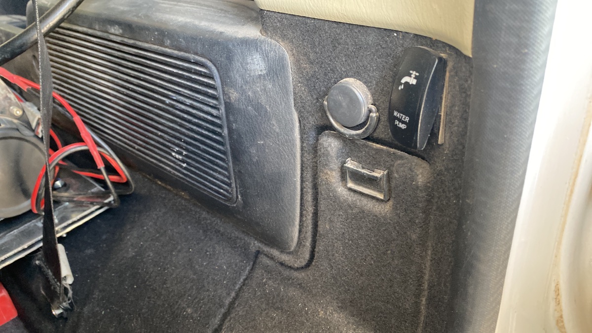

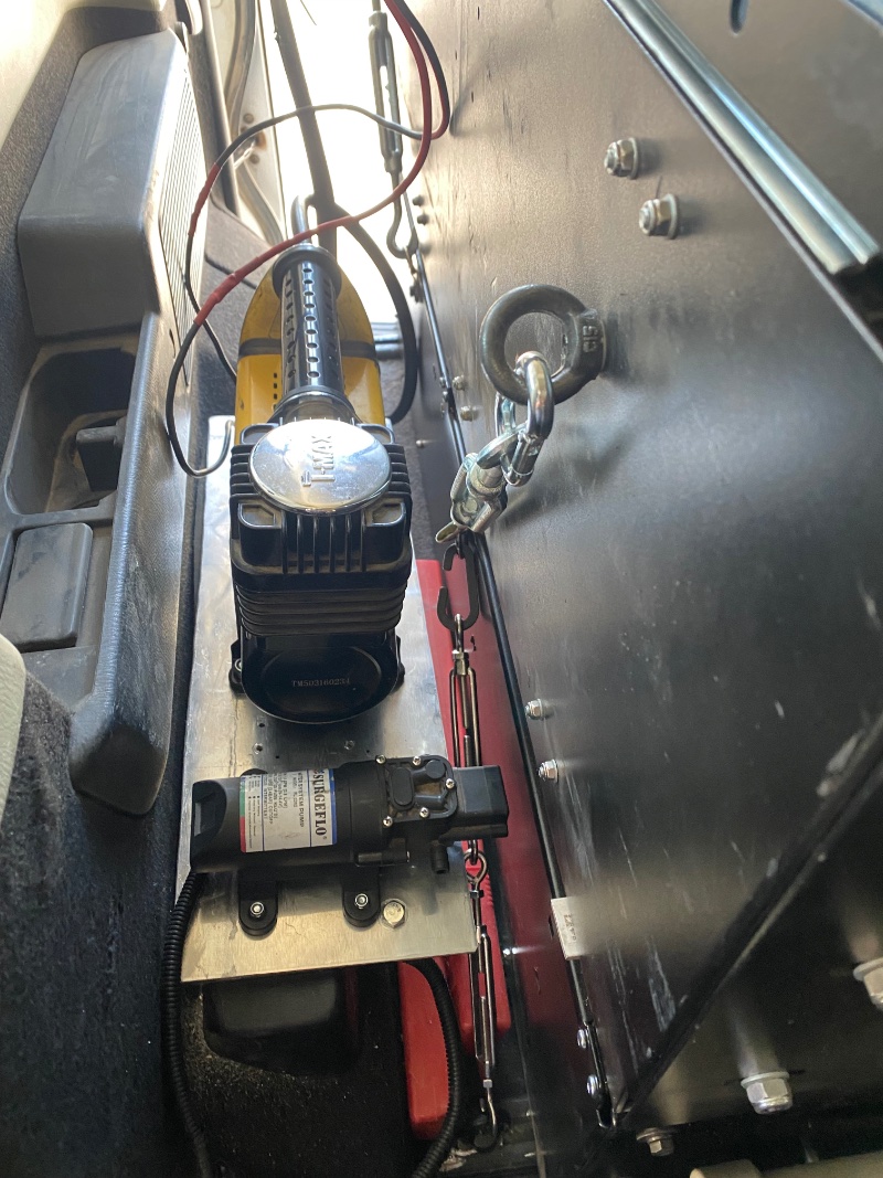

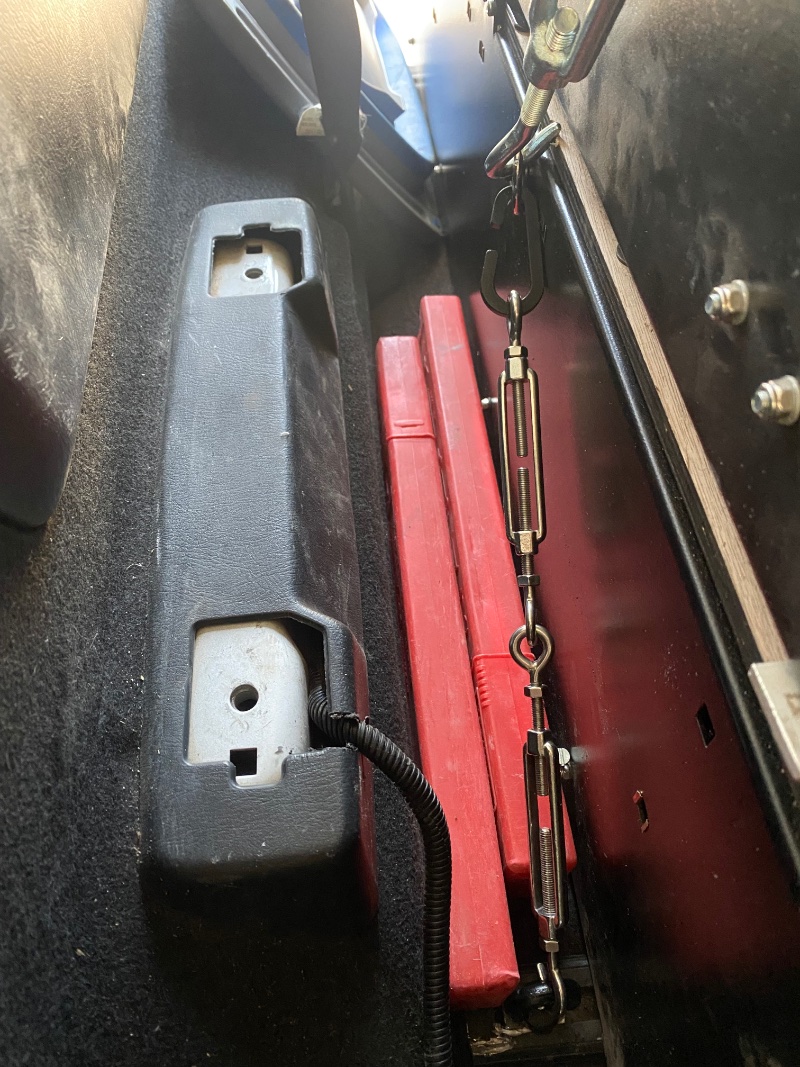

Lastly I’ve always wanted to mount my water pump and air compressor in the back somewhere convenient. I made a platform to fit onto the anchor points for the third row of seats between the side of the car and the drawer system. The water tank sits on the floor behind the front seats. My rear bench seat has been removed and that is where my dual battery and fridge are permanently mounted.
