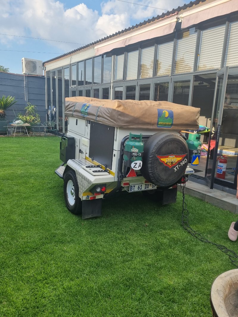

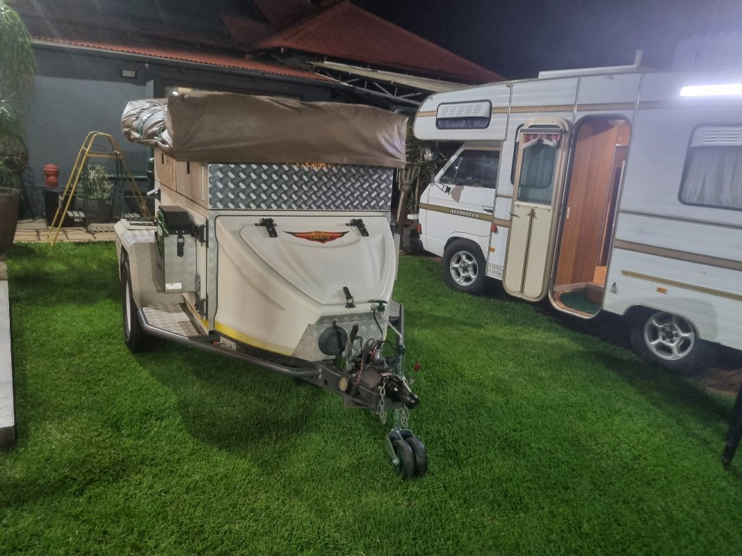

We Decided the cost and time it would take to upgrade the Challenger trailer it was easier to just buy one with our wishlist items
So Meet
Shadow (It's a Shadow in the Touaregs rear view mirror :D )
A Jurgens XT 140
With pressure pump
2 water tanks
A Hansen gas/220v built in Geyser
Duel compartment 90L National Luna Fridge freezer
Flip.down gas stove
Drawer system and
The

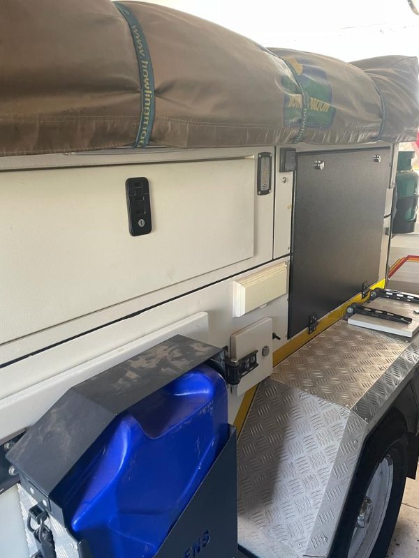

One point that was On.the top.of the Priority list was the TTT with the room part of the Sleeping Area so you.do not need to climb out of bed in to the open as the Roof top tent that was on previous trailer

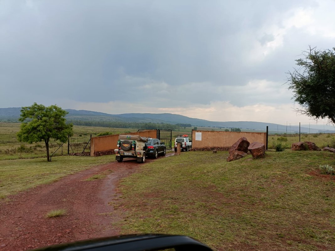

We used it to the YEF 2022 and arrived in the rain and set up in the rain
It has the large side canopy area but will Un zip.this as I still want the Set up time as short as possible
And this eliminate 6 poles and ropes
The room side and Kitchen side have small but useful shade if need be

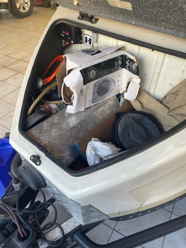

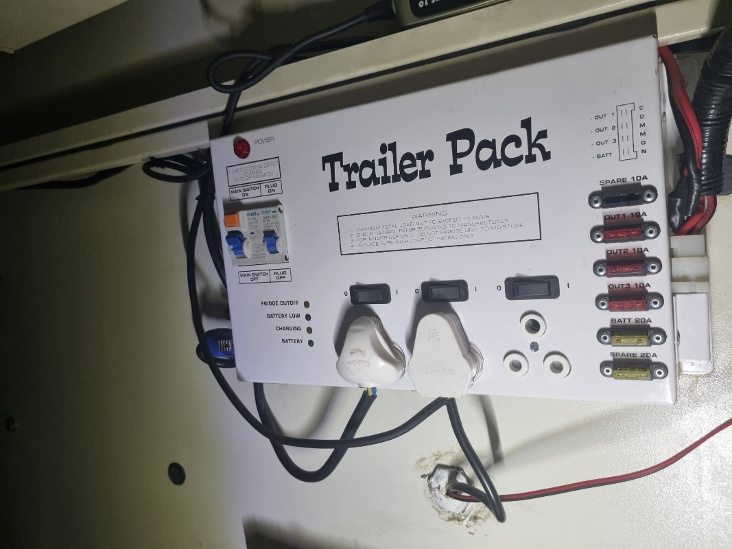

The Elecketricks needs full do over
Trailer power pack.220v -12v dc charger is not working and previous owner just installed a 8a Cteck
I managed to track down the company in Kzn that manufacture the power box
Sent them a email requesting Info
They Relied with
Owners manual
Full circuit diagrams and Bill of Materials
I'll remove the power box and see if I can check what is blown as I am a Qualified Electronic Mechanition got some experience to faulting
With the 220v plug connected on certain areas on trailer if you touch the trailer a certain way
You get a soft shocking tingling
This seem there is a slight earth leakage and will check that out aswell

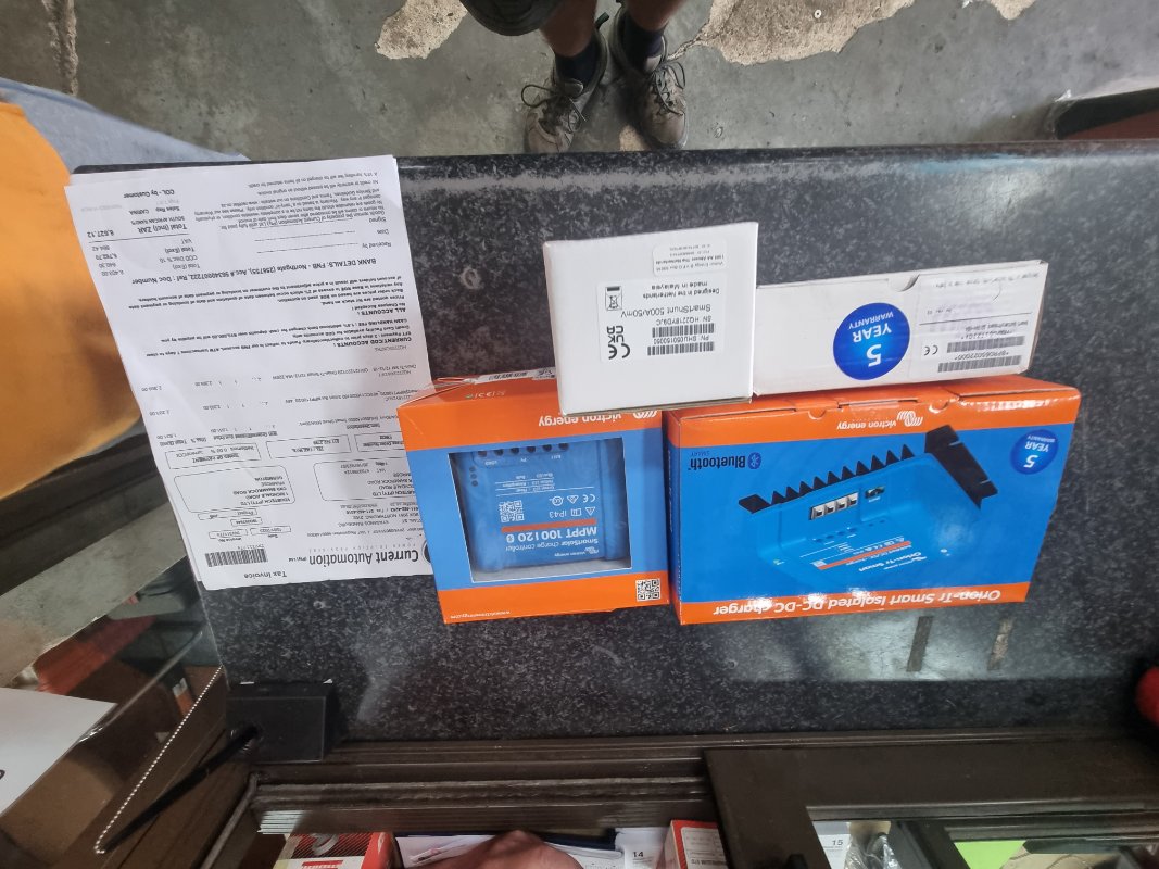

Orderd
Victron smart Solar charger
Victron smart DC- DC charger
Victron Smart Battery protector
Victron Smart shunt
Was hoping to have all the Victron equipment to install over the festive season but waiting on the battery protect and Smart shunt
So this installation will wait for early 2023

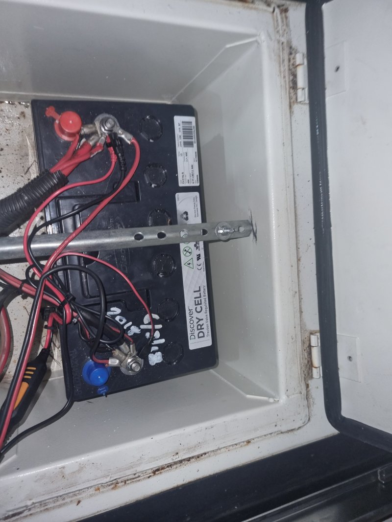

Currently there is 2 oversize battery cables running from the battery in the trailer battery box to the tow hitch on a Brad Harris plug to charge the battery on long trips
That will be replaced with 6mm Silicone wire from Touareg to the dc-Dc charger in trailer

Currently (there is a pun there somewhere) I just run the fridge from the largest crank battery I can find which fits in the NL battery box. It has worked well. My current (there it is again) aux battery is a Dixon and has lasted about 5 years. This is a good innings for a battery - especially for an auxiliary battery as they normally are abused a little. It is on the way out now though and I need to replace it. If it were not for the solar panel, I would have had warm beer at Lekwena a few weeks ago...
I've got to relook at my power set up in the truck. I'm contemplating moving the NL battery box to the trailer and putting in a DC-DC charger with MPPT and deepcycle in the truck. But I'll get there one day.
With a little inconvenience a normal crank battery is best economical choice for running appliances in your car. It's cheaper and no DC DC charger required.
Yes you can only discharge to 75% of battery charge left, but I have lived with that for many years.
I have nothing in Fearless other than a (fused) cable running from the battery to the rear of the vehicle.
This cable splits to 2 Brad Harrisons.
I can run the fridge in the back if I take it with on 1 BH.
The other BH charges the trailer battery when towing.
The trailer has a 104Ah High Cycle Lead Acid battery.
In the trailer I have a Meanwell 20A (AC to DC) charger that charges the battery with 220v - if available.
I also have a Solar controller (think it's 15A) that charges the trailer battery if I plug my panels in.
That are it.
No Shunt.
No Blueteeth.
No DC - DC.
No Isolator.
No Battery Protector.
No problems.
I think we tend to over-complicate things.
Mine are about the same.
Only I have longer solar panel cables than you. Much longer.
I have 2 Sno battery boxes I used as Axillary power packs
Both had the largest car battery fitted I could find to fit in the box
Both have solar MPPT charge controllers mounted on the side making it nice and Mobile
With Brad Harris plugs to double up in my vehicle system
Or stand alone
For me this did work as battery's were cheaper But did not last longer than 2 years due to not often used

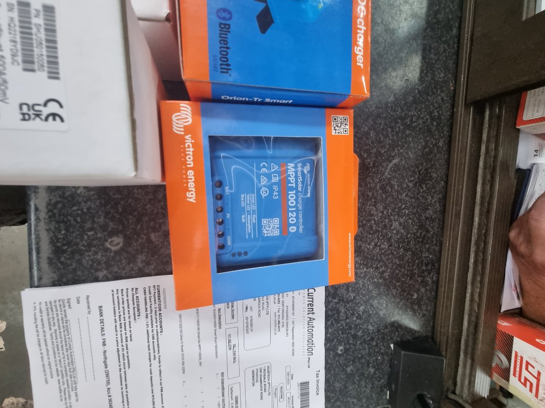

Today my Victron kit was delivered
Dc-dc
Solar Mppt
SmRt Shunt
And
I did buy a few thing in December for the installation
Isolator switch for cutting off the battery power to complete system
I'm contemplating to install all my power equipment in the nose cone
Or fit all the equipment on a back board then I can just fit the board inside of the trailer and the battery in Nose cone
