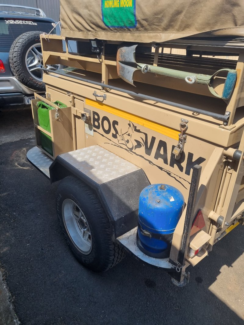

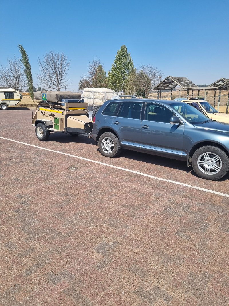

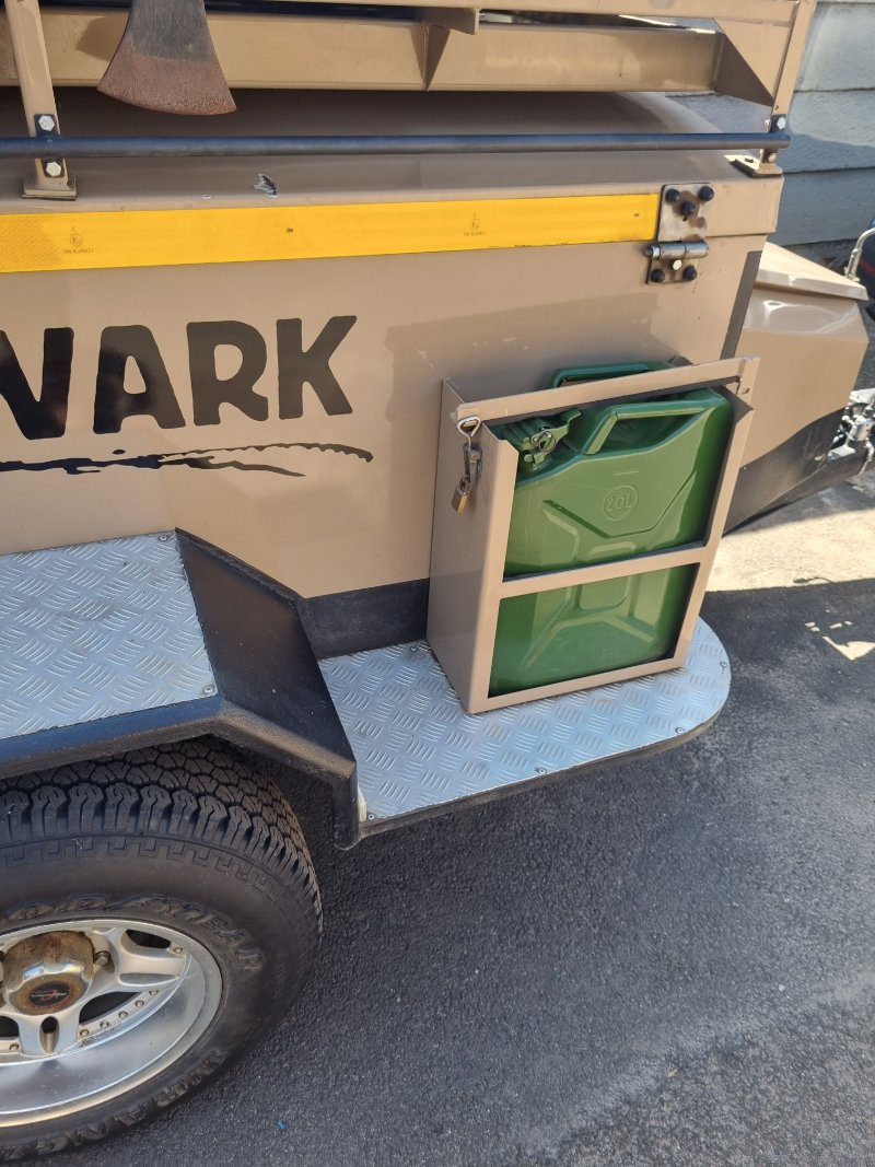

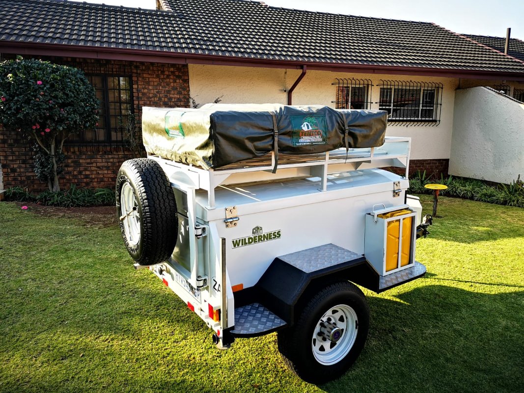

So I found a old 2003 Naboomspruit Challenge
Inv said
Challenger Bundu Basher
Stickers say BosVark
The other ones I looked at had Wilderness stickers on.
So who knows what the correct description is?
Maybe our Forum members could assist with the correct naming.
So Henri said it is a Wilderness

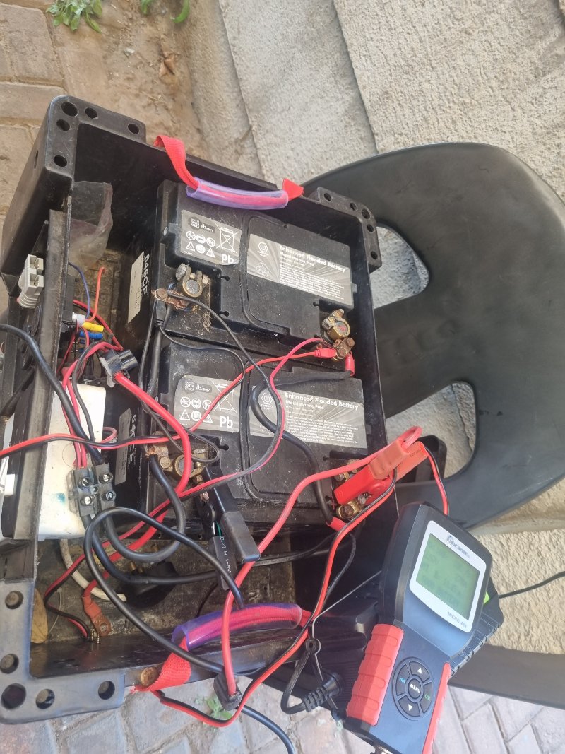

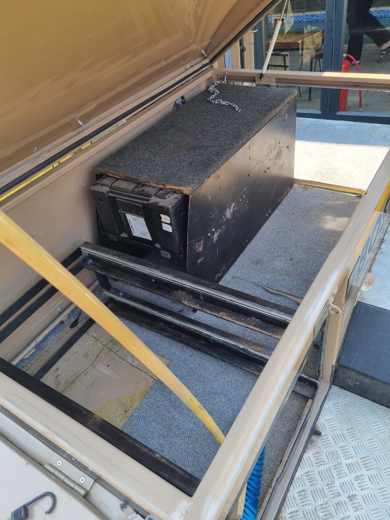

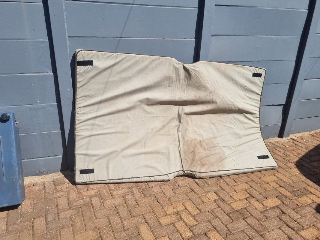

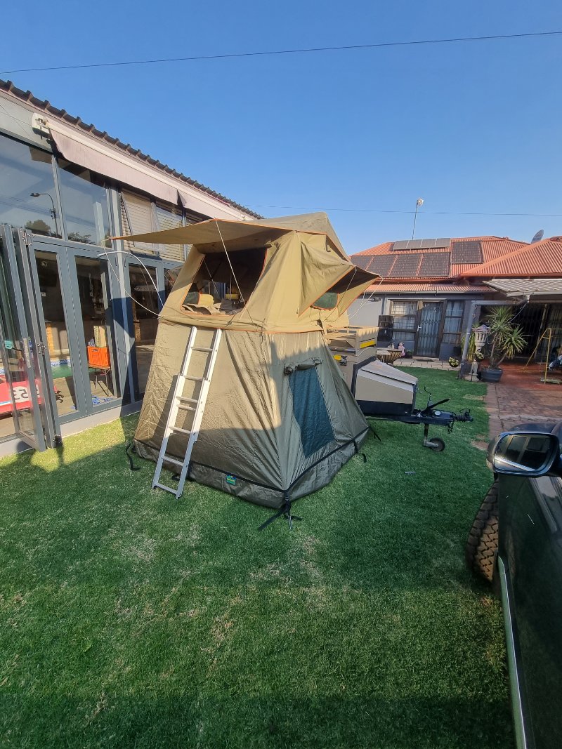

So I pitched the tent today and had a look at the setup.
Mattress will be replaced with new cover.

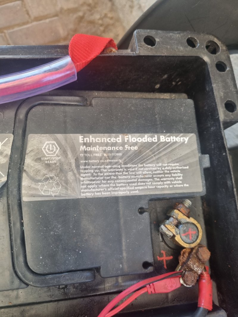

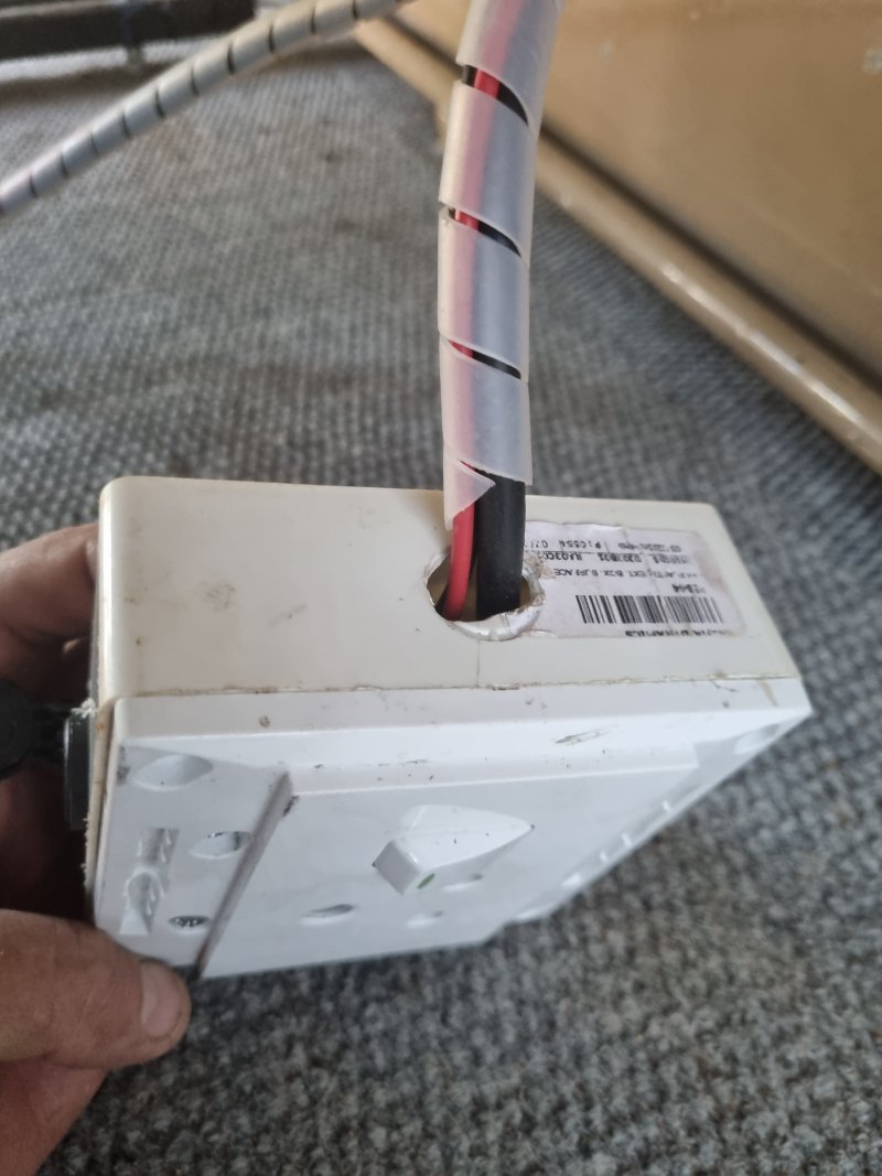

Who ever wired the trailer lights and charging system had no clue what they were doing.
12VDc and 220Vac in one plug box.
Even the 12V dc was connected to a 220v plug socket
So chances on making a mistake urging a 12v 3pin.plug in the 220v is not accessible

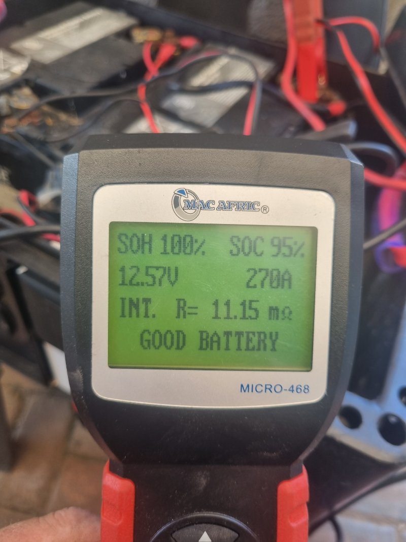

I used my Battery tester and the Batteries are in good shape.
So some upgrades will follow.
Idea is to go camp at the Family Weekend in FouriesBurg
Then look at changes but before the weekend I will do electrical system
Bought some White and Yellow LED lights I will be installing and Brad Harris plugs aswell
Current smart charger is a 8Amp
What I think should be ok to keep the 2x62Ah batteries charged but will add smart charger Duel input

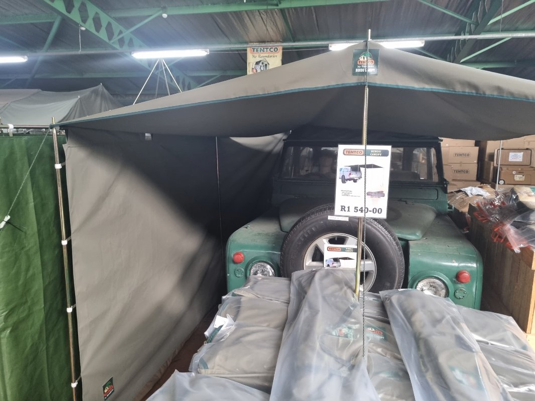

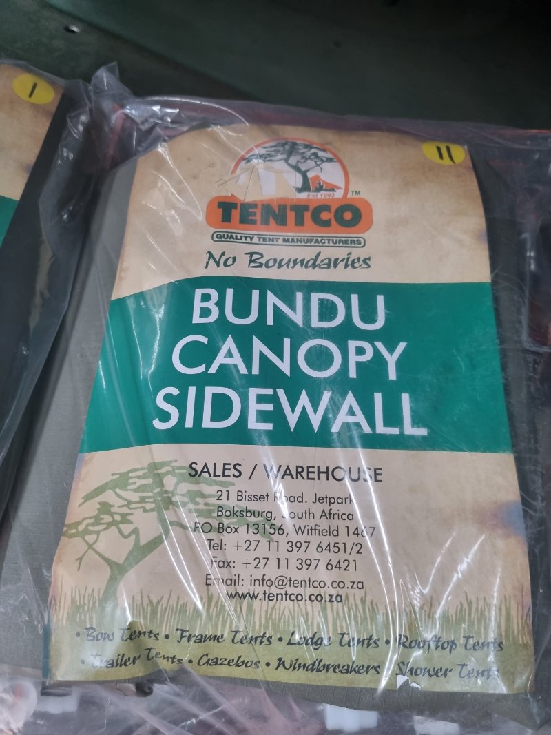

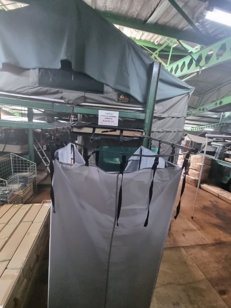

Stopped past TENCO just now
Holy Moly but they got some nice stuff
Bought some sides for my Bundu Awning
And had a look At there 270Deg awning
Not badly Priced Shower Cubicles

I love Tentco. I'm sure I could spend the whole day there. Also have sides for the Bundu awning. Makes a hell of a difference.

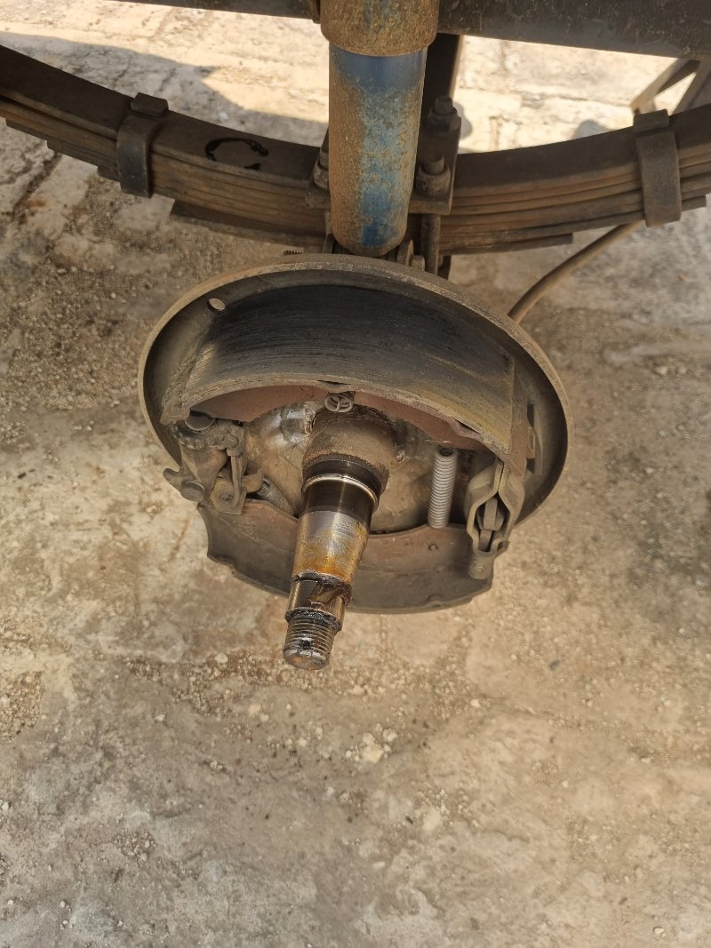

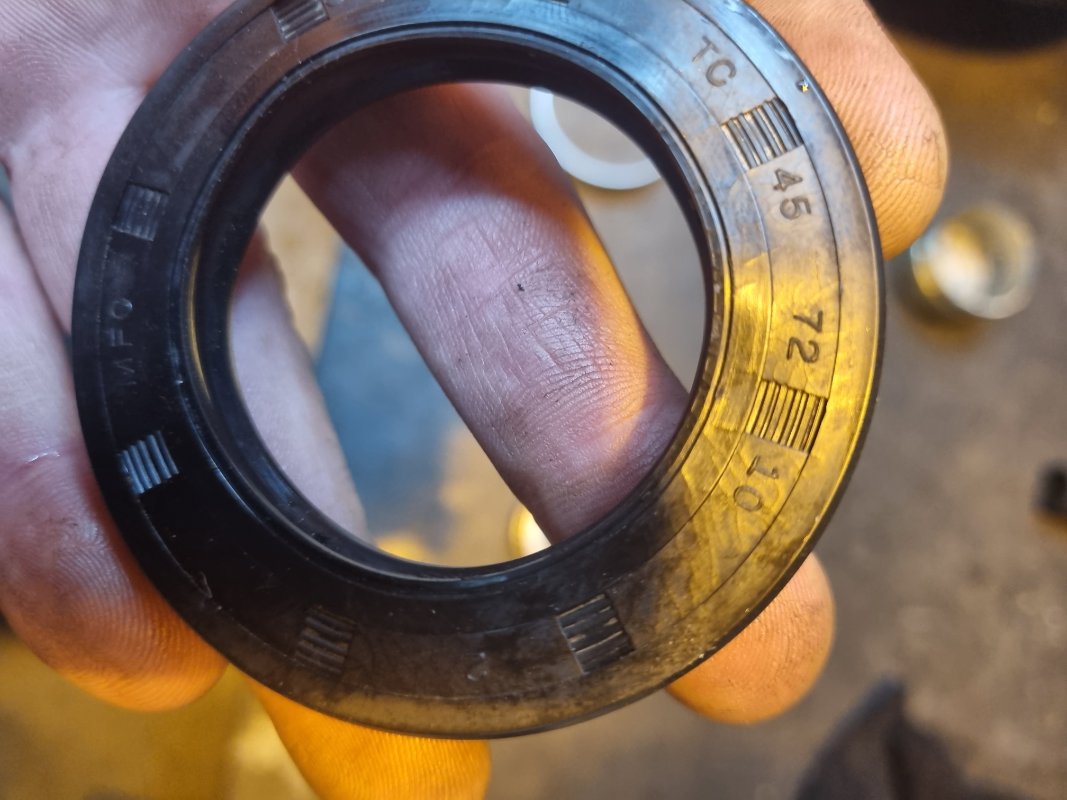

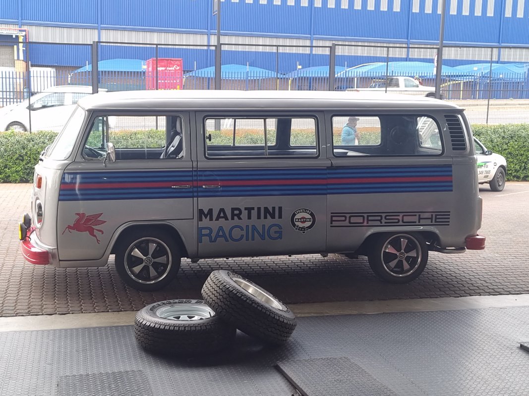

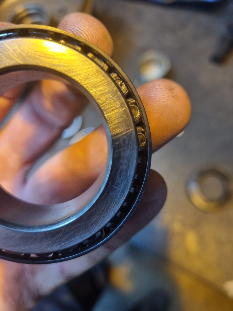

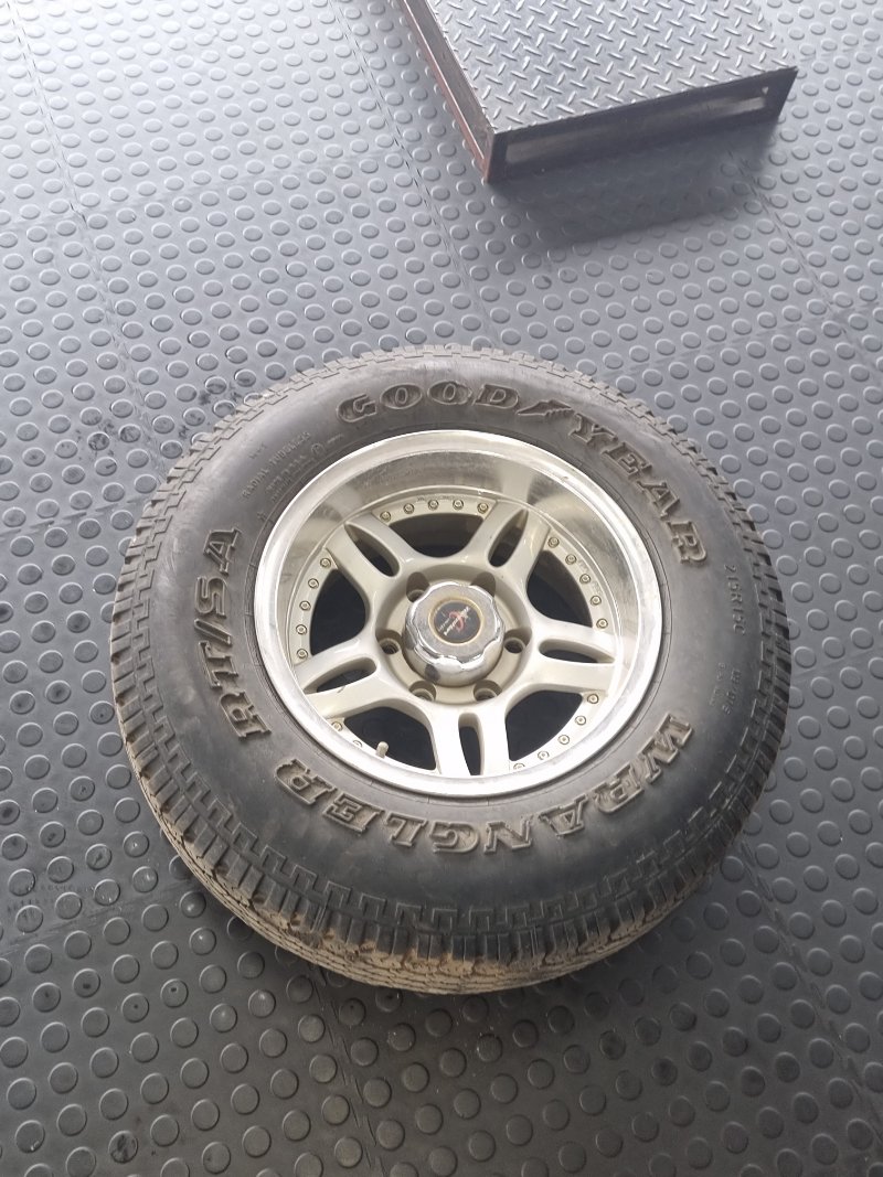

So removed all 3 rims and tyres
Removed the 20 year old tyres and fitted 3 smelly new ones without cracks
Removed the Brake drums to inspect the brake linings and wheel bearings
Tell you what the Axle is not your normal small Venter trailer type
Quite a beefy piece of Iron and large size bearings
Brake linings still good more than 60% life left
And wheel bearings still looked OK but I opted to order 3 new sets to fit new and have 1 in the trailer for stock. Don't think I'll need it in a hurry.

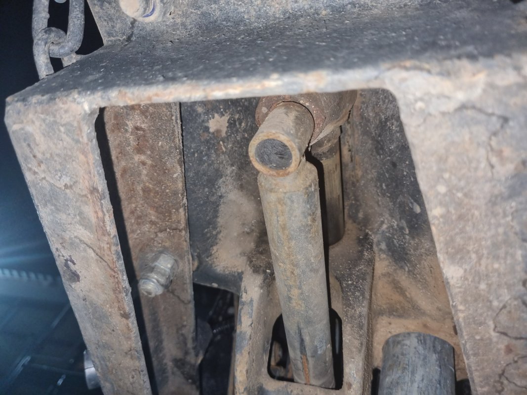

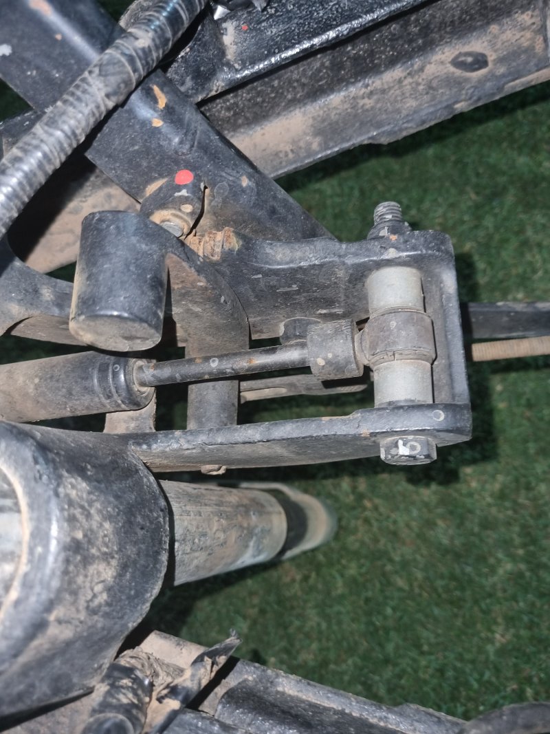

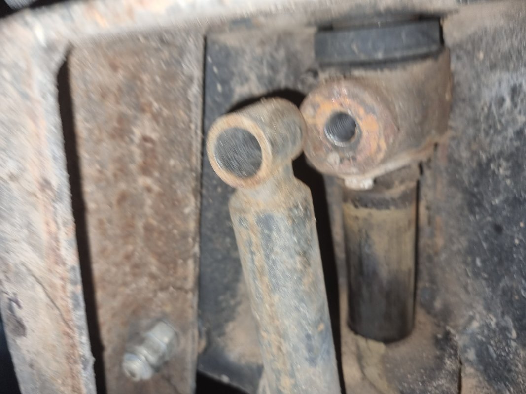

Ok New wheel bearings fitted and tyres
While towing the trailer home from Mbombela.I felt a hard jerk on Acceleration so after I stopped everytime I pulled off quite slow to avoid this and my instinct told me the damper shock is kapoet on the Tow hitch
Had a look at the shock and found a easy fix
The front bolt holding the shock were missing in action
Found a replacement M12 bolt and problem solved

Bugger - that damper shock is Fubar - replace it...
