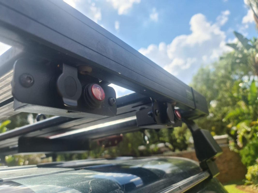

I spotted the new roof rack power points from Front Runner a few weeks ago (https://www.frontrunneroutfitters.com/e ... point.html), and ordered one to see what it looks like. I hatched a plan and ordered a second set before ripping their guts out and modifying them so suit my purposes. I've added switches and they're now wired up semi-permanently to the battery pack in the boot of the truck. Semi-permanently, as the cable is not always plugged in. Now, when we stop to camp, I plug the roof rack in to the battery, plug the RTT and awning light into the Hella plugs, and then we can switch lights on and off as we need using the switches on the power points.

I like the idea! Be sure to post more pics later when you test it!

Also closing the loop on this. After having complete my last walkabout, I am happy to report that my setup works flawlessly.
No photos of the light setup - thought it would be rather pointless. But everything is painless...

The wimmin is control of all the lights she needs from there on just by switching the relevant toggle switch on or off - without having to bother me about plugging cables in and out. :)
