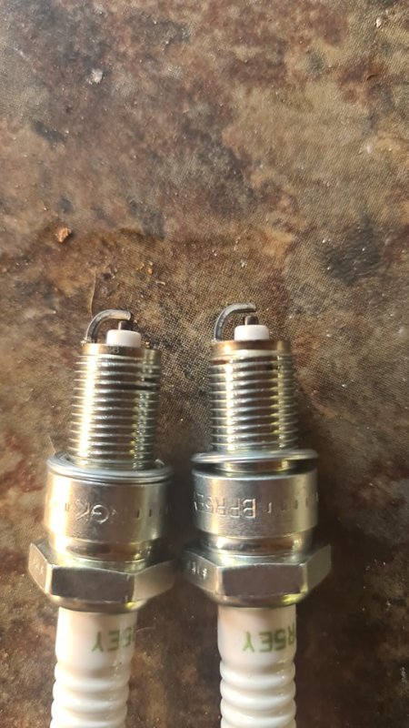

30 minutes later, all was done. And I start the vehicle. But it does not sound lekker - definite miss. Re-check all the work I did. Later on, pull out the HT leads for the plugs and measure resistance. Of the four plug cables, two were in-spec and the other two were waaaay different. So I headed out to the spares shop and got a new set of HT leads. The problem persisted, and I scratched my head figuring out what it could be before giving my good connection, Anthoney Forgey, a call... He mentioned plug gap. I mentioned they were dealer-specced plugs for the vehicle (the top of the lid even mentions 1.1mm gap). After a few questions (for example: I had cleaned the engine prior to the service) I thought perhaps it was moisture on the coils and let the vehicle stand and dry... Later the afternoon, took it for a nice burn along Solomon Mahlangu to get to temperature and the problems persisted....
So, I pulled the new plugs, and put the old ones back in.... And the vehicle worked a charm.
Investigation shows that, whilst three of the plugs have the properly specced 1.1mm gap (right hand side), the one plug is virtually a dead short (it probably has a .1mm gap)... And so problems solved.
I reckon the take away here, is that never trust the plugs - even those provided by dealerships - and a set of feeler gauges costs less than ZAR100 at Midas (I know - I bought a set this morning)...
Yes. I'm a moron. But this post is merely to (hopefully) prevent somebody else's 30 minute job becoming a full day long one...
PS: Anthoney mentioned that he always checks plug gap on servicing vehicles. Even on OEM pre-set plugs, he find an incorrect gap set on about 1/3 of the plugs he uses at his workshop...

You didn't bother to eyeball the plug gap before installing? Eish.
By the way, the thickness of your thumbnail is just about the right thickness for most plug gaps........by experience from many years of two stroke bikes, 1000cc Minis and various old Ford engines.........

Nope - I didn't. Having bought supposedly properly specced plugs - and also never ever having had this issue in the past - I did not think it was necessary... So we learn... [emoji38] [emoji38]

I am sometimes guilty of that too - I assume the plug gaps are set correctly. Live and learn as they say.
Luckily Ian did concern himself with my secondment of buying a new pack of coils [emoji38]
