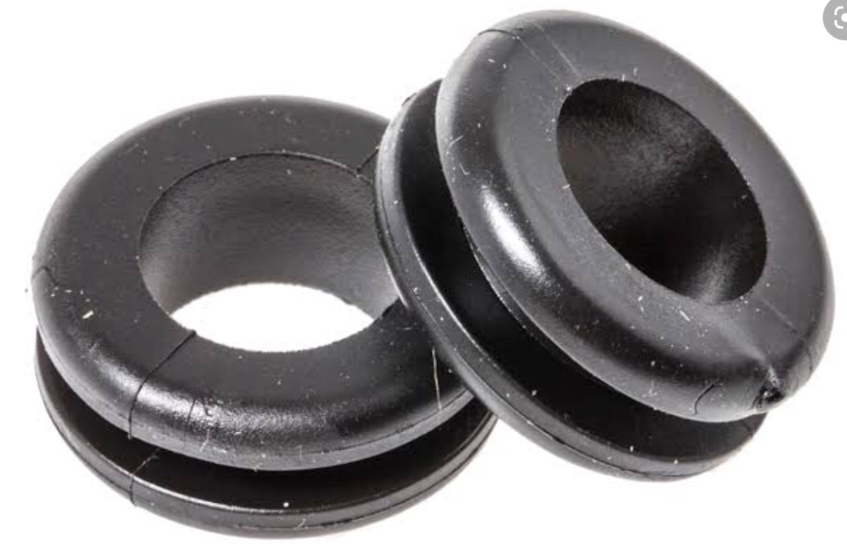

... nice layout Grips, though I might recommend using grommets
if it’s practical to retrofit them ... esp where there’s a few amps etc
‘Builders Express’ etc sell a selection of them at quite reasonable price.
Has thanked: 107 times
Been thanked: 239 times
Posts: 1272
#74
Thanks at time of the built I could not find the correct size grommets in Kathu.
Have since got hold of a kit.
For precaution all those holes are chamfered. Chances are little that the high grade pvc insulation will shaft through.
If I have spare time I will fit the grommets for extra piece of mind
