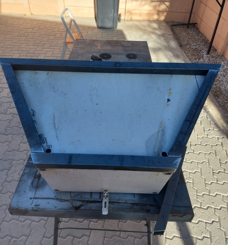

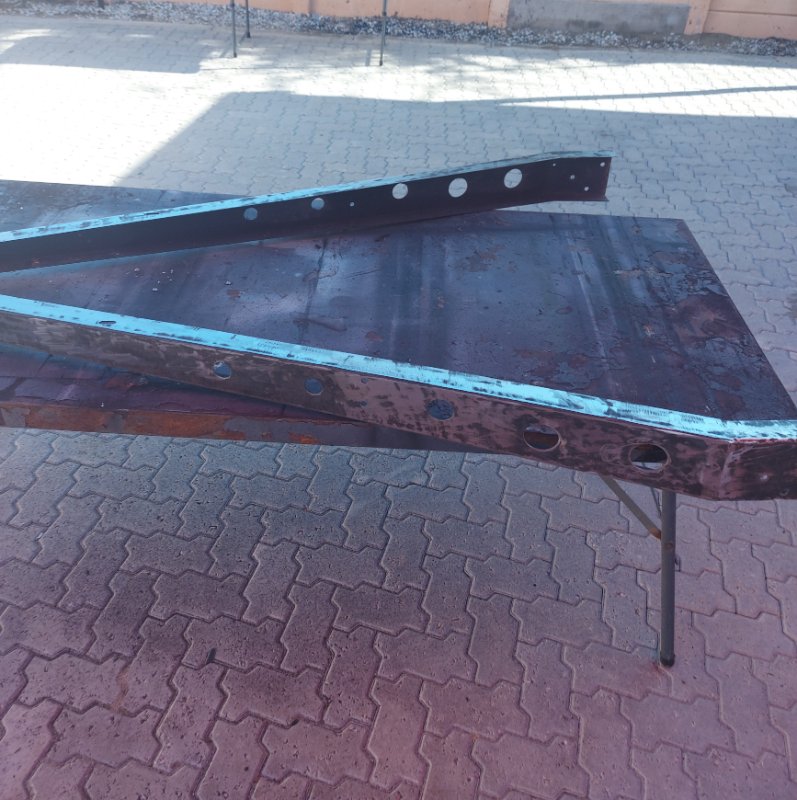

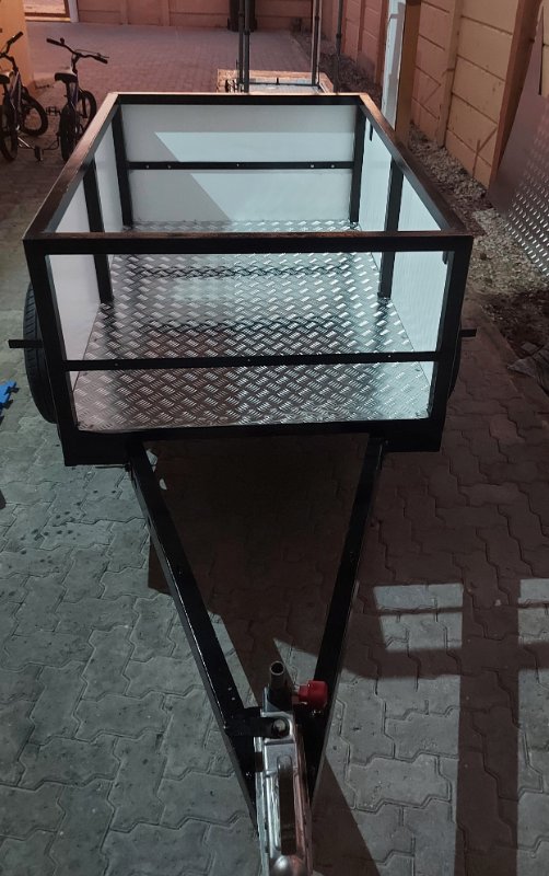

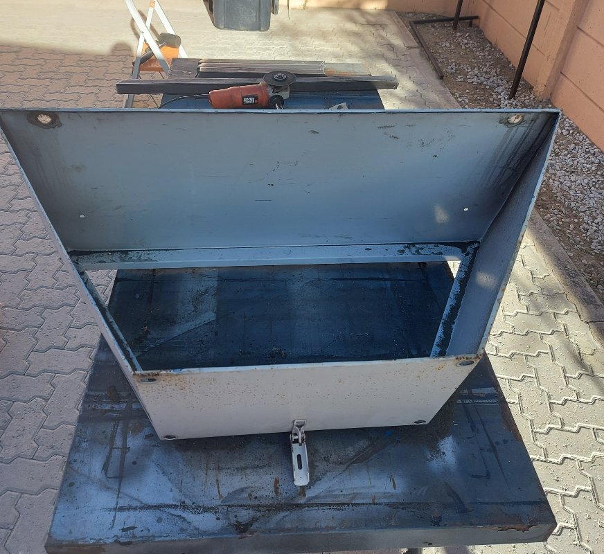

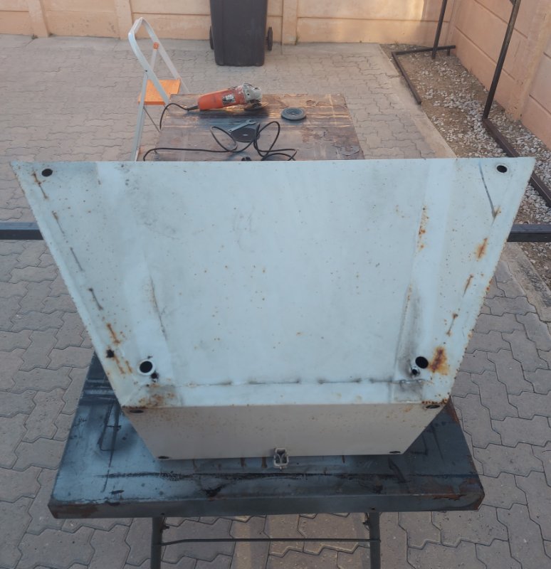

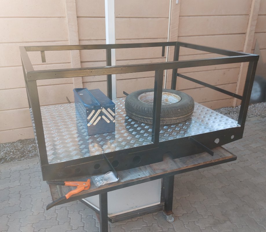

Some progress:

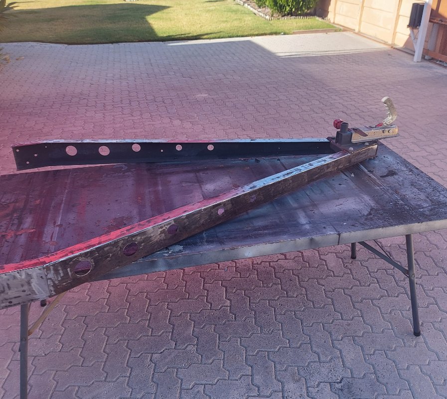

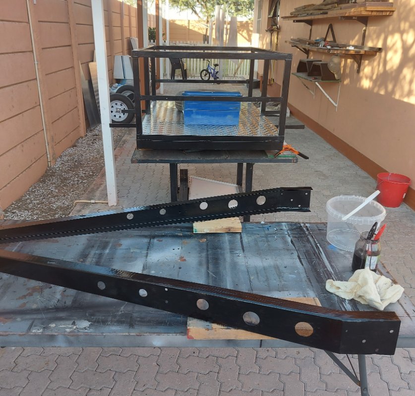

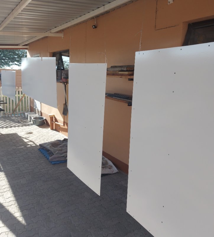

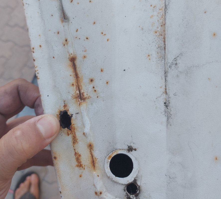

After welding and painting the frame, I noticed the nose cone's floor was also rotten through. I had to cut it out and weld a frame to which I can fasten a new aluminum floor. I then removed the paint from the a-frame, cut out the panels and started painting. When I painted the galvanized panels, I scuffed it up with 12grit sandpaper and then (being Scotty the Scotsman) etched it with vinegar. After painting it with primer, it started peeling so I had to first remove all the primer again and then properly etch it with the correct chemical - I lost two days of progress that way.

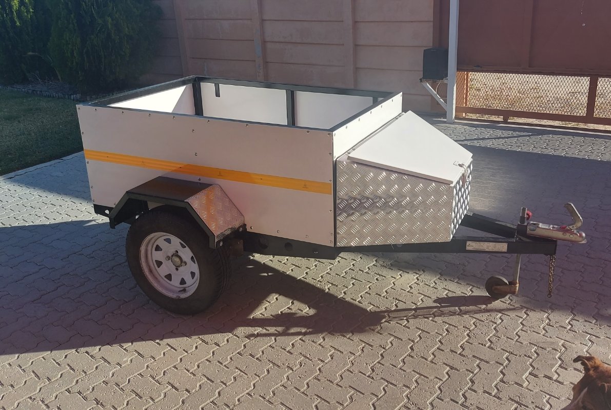

I feel it prudent to requote a sentence or two from my first post. Seems it was quite accurate :lol: :
"In 2014 I bought a Jurgens luggage trailer - the infamous BT547. For those with Agnosia (like most Toyota drivers), the 547 represents the dimensions of the cargo bin of the trailer."

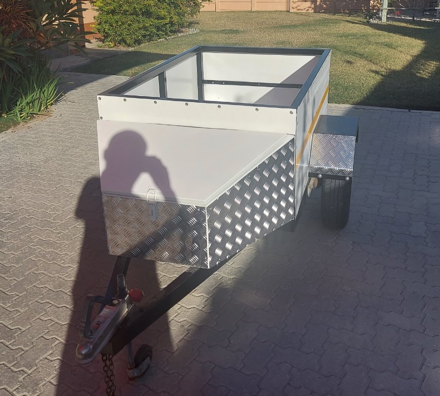

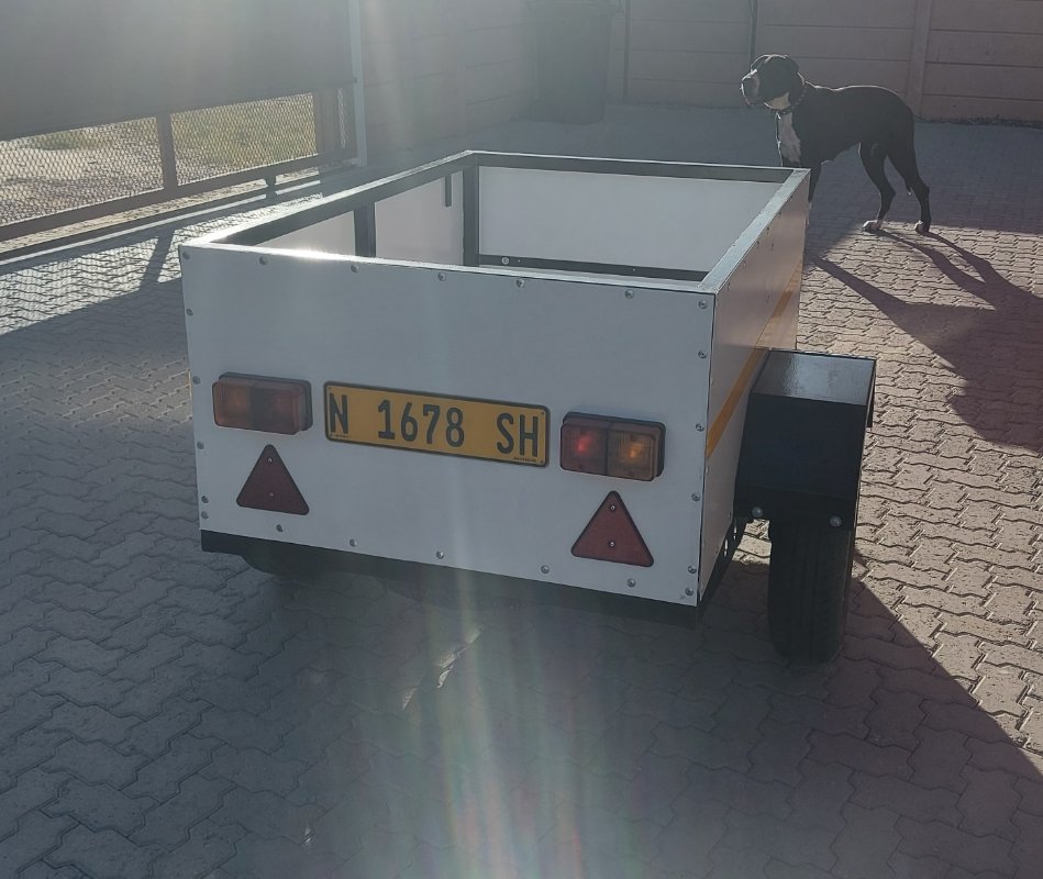

Nose cone and mud guards done and fitted.
Now I need to sand down the main lid, paint it, fit it, do the wiring and seal the joints of the under-carriage. Oh and replace the bearings while I have the time.
Then it is done.
