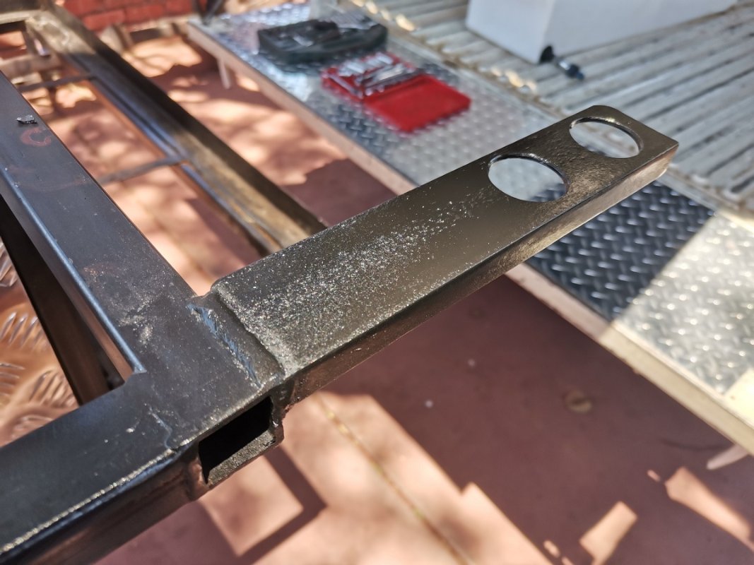

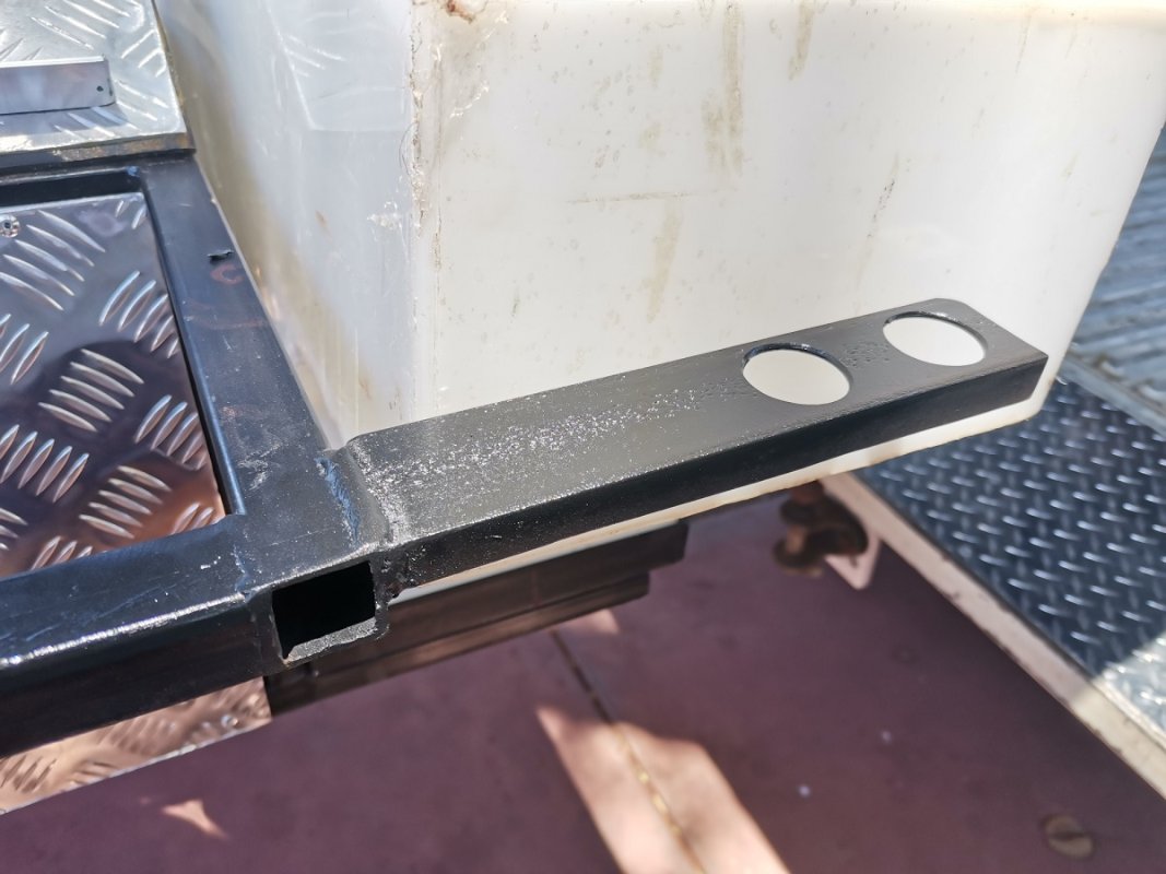

Made brackets that bolts down the drawer system to the Canopy. I can take off the whole lot when lifting off the canopy. Easy to store the combination.

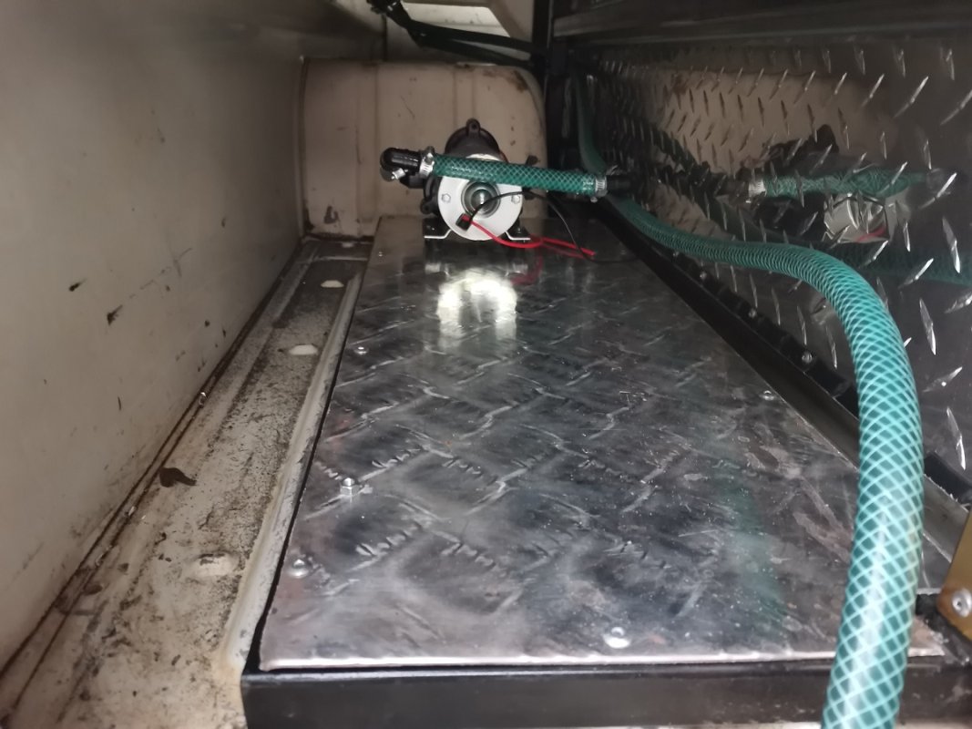

Late Saturday afternoon I managed to install the pump. Will post some pics later.
Made brackets for the water outlets and did all the pluming. Bracket for the geyser also completed but still needs to be installed.

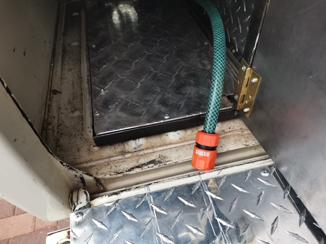

Gravity feed outlet should something goes wrong with the pump
Pump installed. Battery to join pump in the leftover space

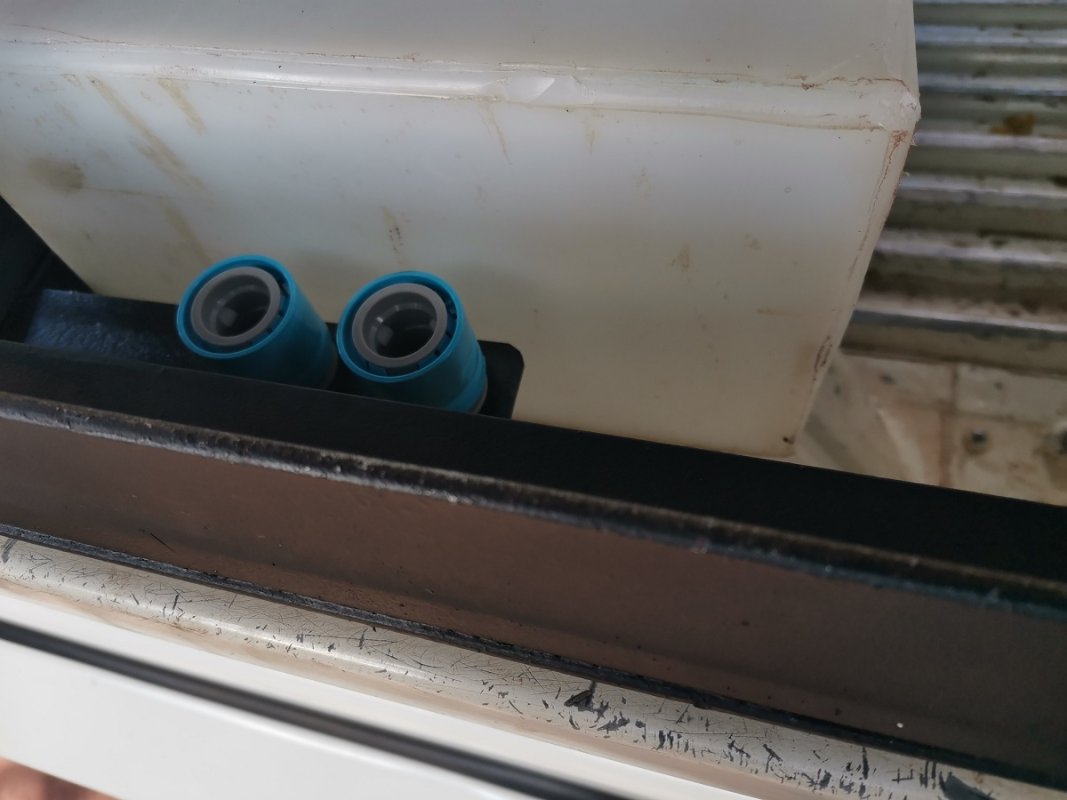

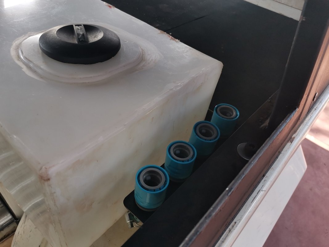

Brackets for water outlets attached to drawer system
Geyser hot and cold water supply with hot and cold water outlets
Outlets for shower on the other side of the Cruiser,
When you don't get fittings but you have a lathe, you make them [emoji12]Image
