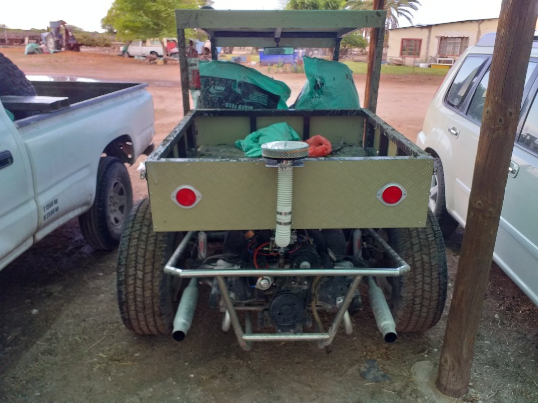

Update:
The buggy's filter kept on getting clogged with that fantastically fine Namibian dust and after giving the carb a proper clean for the umpteenth time, I made and fitted an impromptu snorkel - which works really well.

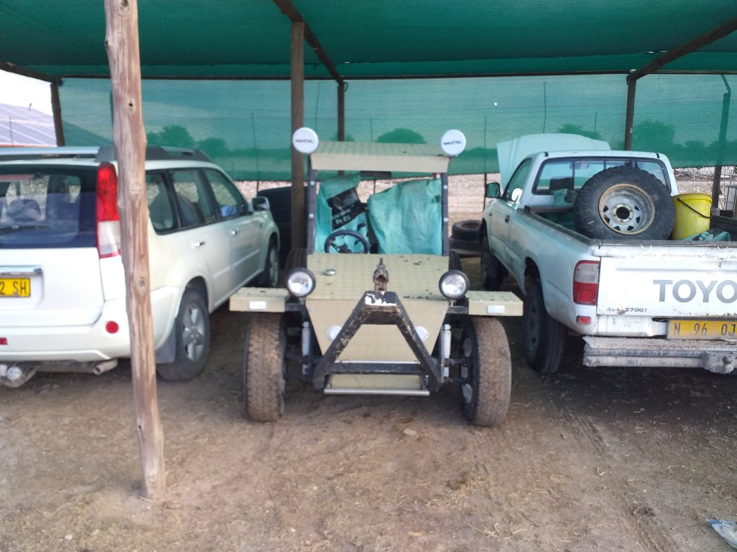

#266
Standing proud between two legends...
