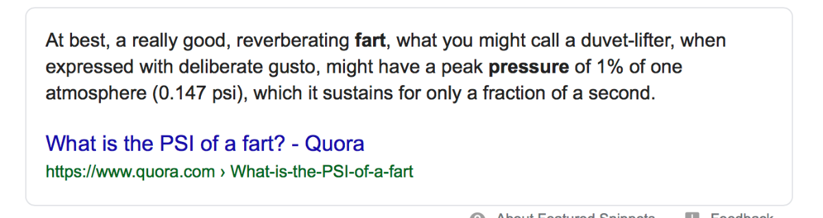

The fuel pressure isn't the problem.... you can blow at around 0,1bar (1,4 psi) ...Ricoffy wrote: ↑Wed Oct 02, 2019 8:11 amThank's Wooky.
I still think the pressure is too high, so it will only be a matter of time before I have the same problem again. The second washer is only a temporary fix.
Seems I have to import a pressure regulator from SA. Such a device does not exist in the whole of Nam![]()
Do you have any recommendations as to a reputable auto shop where I can source one? Preferably in the Gauteng area - arranging with DHL there is much easier.
If you pushed the float level down by adding a washer and the problem has gone away, either the needle is worn or the tag on the float is bent or the float shaft has worn badly.... fax that and stop farting about with micro fuel pressure adjustments!
Hmmm... you could probably fart harder than that pump now I think about it....
