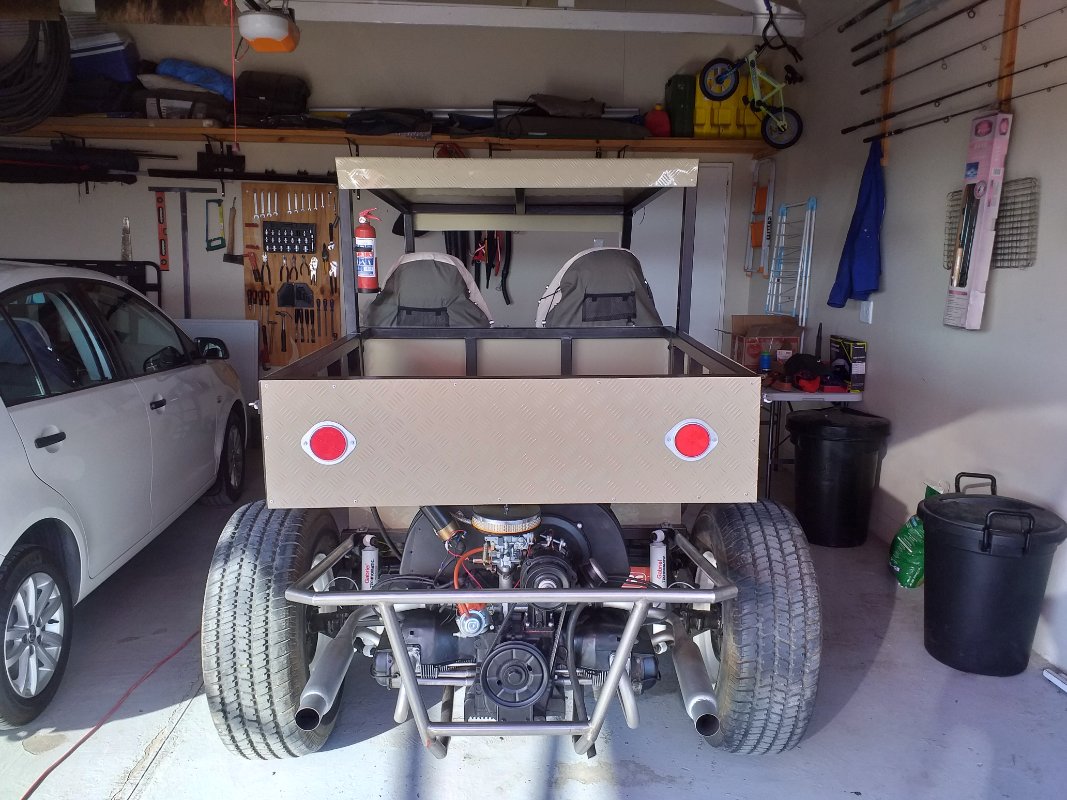

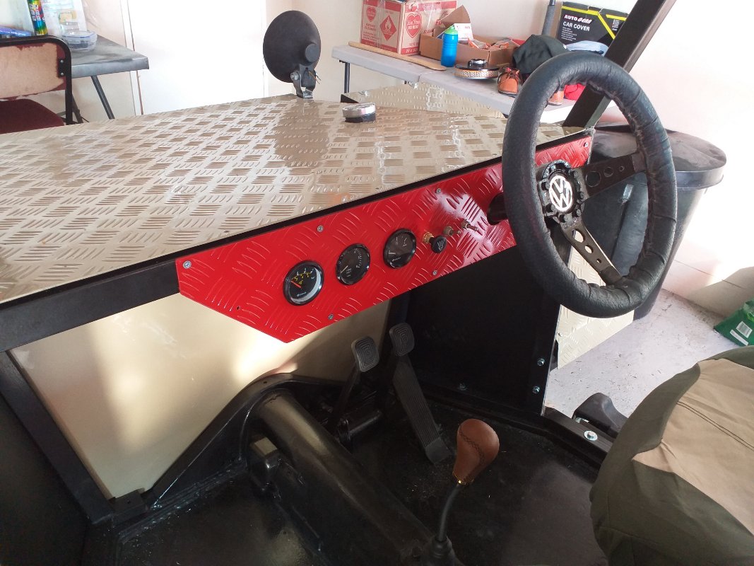

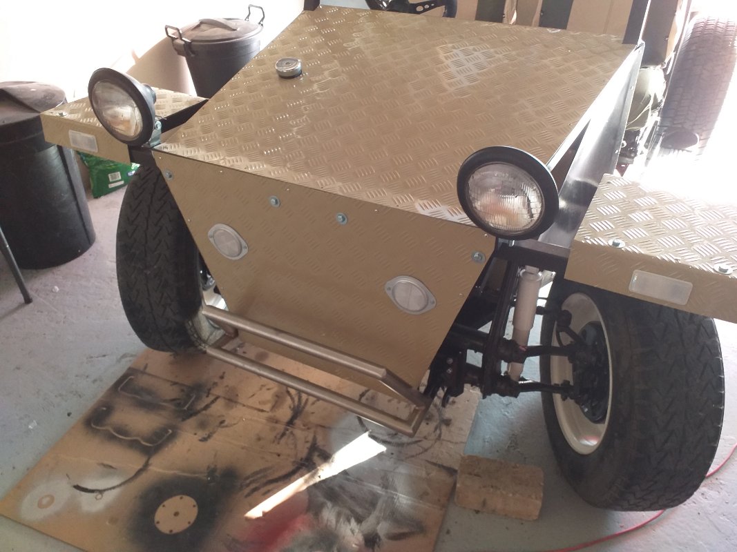

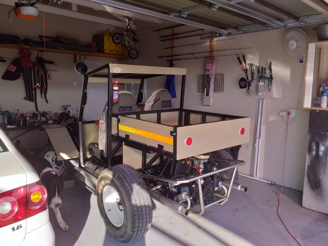

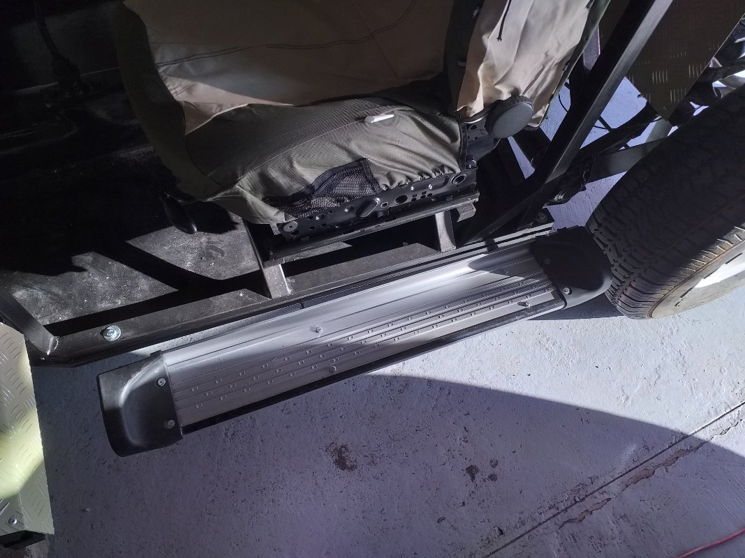

Some bobs and bits added

Apocalypse wrote:
Mon Sep 16, 2019 2:45 pm
looking pretty good! Spray can or brush?
Thanks Apoc.
Frame was painted by brush - hammerite.
Alu panels sprayed with two coats of etch primer, colour (land cruiser brown :lol: ) and clear coat each time.
The dash I did with a alu spray - glu devil I think (same MO as the panels).
Posts: 1765
