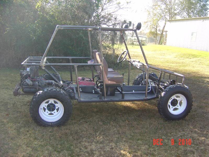

Had something like this in mind:

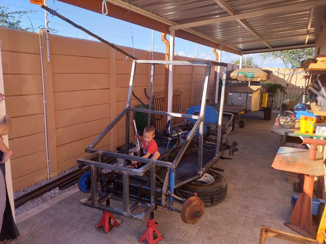

Just came back from the hardware shop.
Decided on 38mm x 38mm x 2mm to fabricate the frame.
Got two sheets of checkered alu (1,5mm) for a whopping R980-00 per sheet - bargain.
Progress pics for Easter?

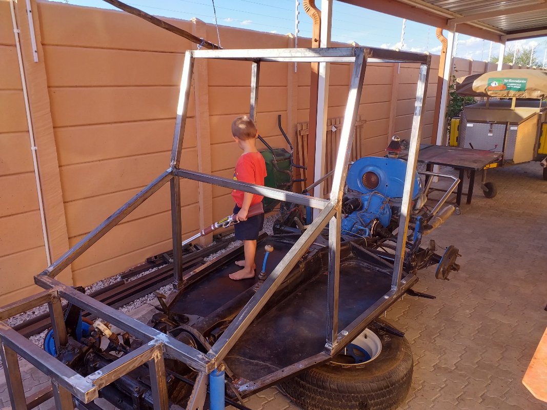

Started with the front end of the frame. Square tubing is a bitch...
Pipe would have been much easier.
Got the engine to run (finally) - sparkplug cables set in the wrong order and replaced the condenser.
Its supposed to look like a cruiser (my father in law always wanted a cruiser)
If you were wondering, the big carrier in the front will be for a jerry can amongst others
