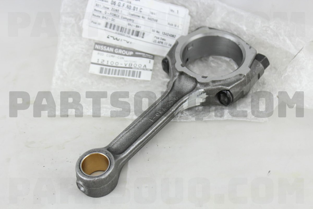

Right. Just to get back on the con-rod issues. I stand corrected - the con-rods are interchangeable. But, stock con-rods do not share the same part number.
TB45 - 12100VB000
TB42 - 1210003J00
The substitute for both is 12100VB00A.
However, stock TB42 / TB45 conrods are no longer available, and I can not find photographs of them to compare the differences. I am unsure whether the newer con-rod (the substitute part number above) is the beefier con-rod that people upgrade to when turboing a TB45 correctly.
This is a photograph of the newer one. I'll compare it to the ones I removed from this motor.
The push rods - and in fact the entire valve/cam mechanisms differ quite dramatically between the two motors.
In short: Perhaps the original TB42 con-rods were beefier than the original TB45 con-rods. Perhaps the updated substitute part, although interchangeable between the two motors is beefier than the original TB-45 con-rods. There are definitely differences in the push-rods and the entire valve / cam section.
Whatever the reasons, I can guarantee you that I would not turbo charge a stock TB45. Whereas I would consider doing so on a TB42. I've spoken with various people about this matter.

I invoked some of my haxory photos, and have tracked down some photos of the original con-rods as installed on TB42 / TB45 motors as they were assembled.
This is 1210003J00 - the original con-rod for the TB42 motor:
This is 12100VB000 - the original con-rod for the TB45 motor.
The TB42 rod appears to be beefier in both the clamp on the big-end, as well as the shaft of the rod leading to the gudgeon pin.
Both parts were superceded by 12100VB00A which just seems to be beefier throughout.
