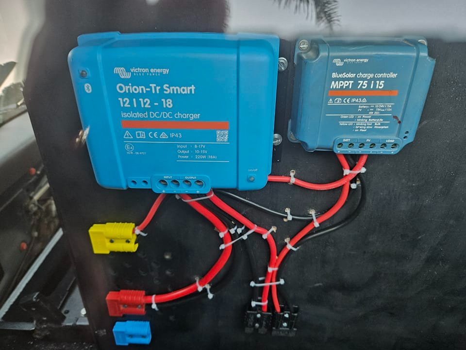

Wired up charge controllers over the weekend - it is a little messy (I await Manny's disparaging comments) but I'll neaten it up when I remove the panels again for carpeting after this trip...
The packing system is done, but I am rebuilding my aux electrical system at the moment. I'll post more details on it when I finish it, as I do not have much time before I leave.
I've colour-coded the plugs so that it is idiot proof. Well, I presume it is idiot proof. I've still got to find an idiot to test this theory with though...
Yellow == PV input.
Red == Alternator input.
Blue = Fridge output.
Black == Output from charge controllers to aux battery.

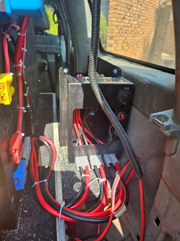

Since I've now got the DC-DC charger, my NL battery box was redundant. It's also been annoying me. The plugs and everything are on the side, so it's always been a mission plugging things in etc. It's also massively big. So I acquired a Voetspore battery box - just the bare box with no internals... It's nice. It has lugs for bolts - so I've bolted it to the steel from of the packing system. And the place where the plugs come in fit on the ends. Even better - the side the plugs are are interchangeable. So you can decide which side you want the stuff on. It has space for a hella plug, a lighter plug and three brad harrisons.
I wired it up over the weekend. Naturally, I've got a strip fuse as close to the positive as possible, a positive bus and a negative bus. Two of the BH plugs are wired to provide input from the MPPT and DC-DC chargers. The other BH is output for the fridge. It's super basic currently - no controller bits so I will need to rely on the fridge settings to prevent it from discharging too much etc. Overall, I am happy.
When I get back from this trip though, I'll make some changes to the setup. I need something to prevent running down the aux battery too much. I'd also like to include a few USB charging ports and a voltmeter. And I must also neaten up the wiring on the side of the packing system.
