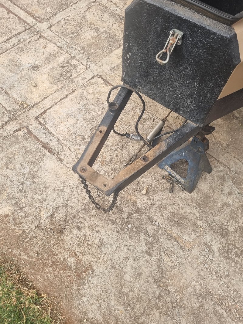

I'm upgrading

That trailer will be all new soon...

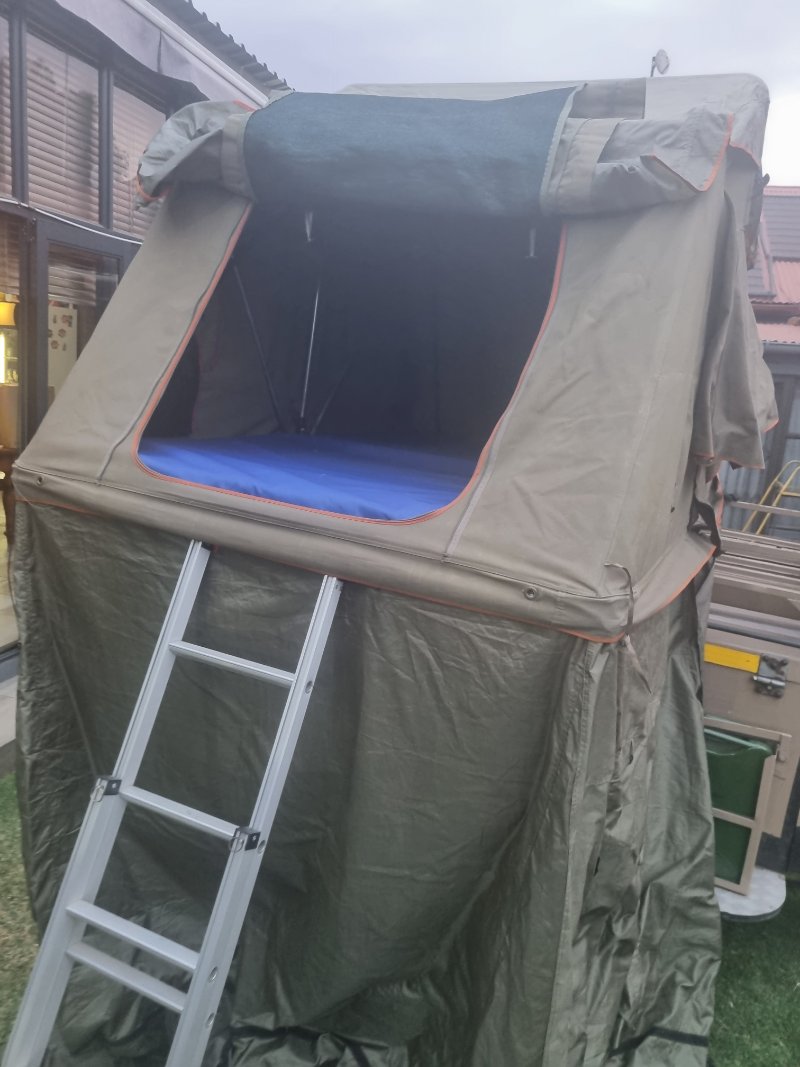

Rags to Riches
Foam cover removed and Nice new water resistant cover made

So, you fitted new:
Brakes
Bearings
Tyres
Lights
You've refurbished
The tow hitch
The wiring

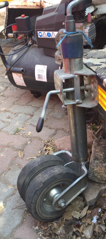

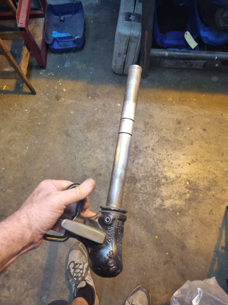

... if you ever see the need to replace your Jockey Wheel
then just pay the extra 1 or 2 hundred to get a 2-wheeler
... stabler, roll easier, better in sand mud, prestigious etc
Stand ' above and beyond ' the Plebs and Cretins etc
who persist & ' live a life of quite desparation '
in boring single-wheel commonality ...

Chas I do need to replace the Jocky wheel
Will look at your Suggestions of Duel wheels
Do not know if it will fit inside the a Frame.

The twin wheel jockey works very well. Consider removing it when towing. I fitted an extra clamp on the A frame of my van, but you may not have space on the trailer A frame, so consider a clamp where you have removed rhs jerry can.
