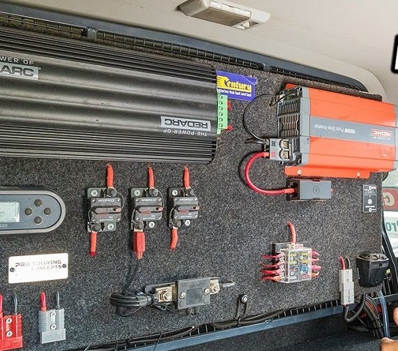

Where have you, or will you, place all the electrics?
I would mount all the power items on the back wall above the Snomaster fridge.
That the Solar controller, DC-DC charger, battery state display etc.
So you can stop & easily see the state of charge, the charge rate etc.
You could then have assorted power points there & place the items (cell phones, lap tops, cameras etc) on a shelf above the Snomaster (while stopped).
Something like this...

Thanks Manny nice layout. That is more or less the idea I have in mind. I am still not sure if I am going to combine the batteries in parallel or have two seperate systems. Still need to do calculations on the capability of the OEM alternator.

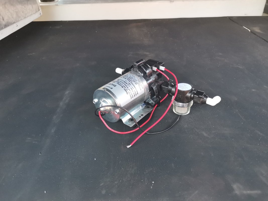

Time to pump
Plan is to have 3 cold water and 3 hot water connections. Currently have a gravity feed tap at the back. One hot/cold connection at the back. One at the kitchen and on right front for the shower.

Christo ek gebruik omtrent die selfde tipe 12v water pomp as jy wil en hy werk baie goed.

Shurflo are good pumps ... I recently re-did
my whole trailer water system and it had a cheapo pump that only does 2L:min ,
but after testing, thats enough .
Was going to upgrade then thought :
better the pump , higher the pressure,
faster the water tank empties !
Car and Trailer I carry about 175L but at
much more than 2L/min would not last long !

Cheapo pumps failed me on two occasions. I will have a gravity feed outlet incase of a pump failure.BushWacker wrote: ↑Wed Nov 18, 2020 9:51 pmShurflo are good pumps ... I recently re-did
