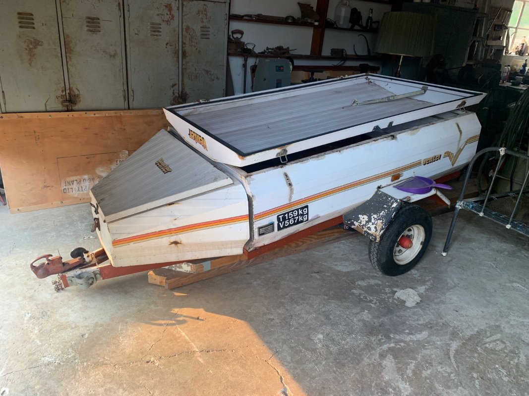

As many things in life, starting with an innocent visit to my uncle (downscaling his house), offered me his trailer, with papers still in order, I had a quick overview looking with beer glasses and said, "That's nothing, I can fix it up quickly" ended up taking up my garage for a whole month, working after hours. Man! What a waste of time, something I am glad I did, but would prefer not doing again in the near future.

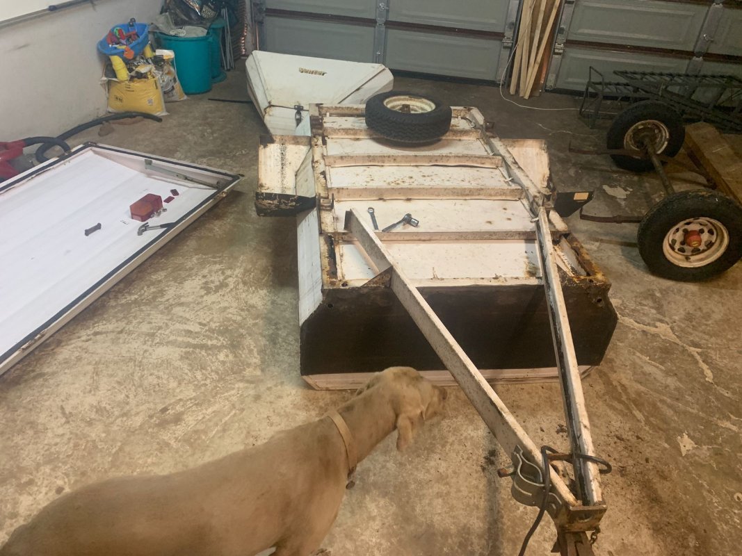

So here it goes, staring off with an innocent looking trailer, until you look underneath:

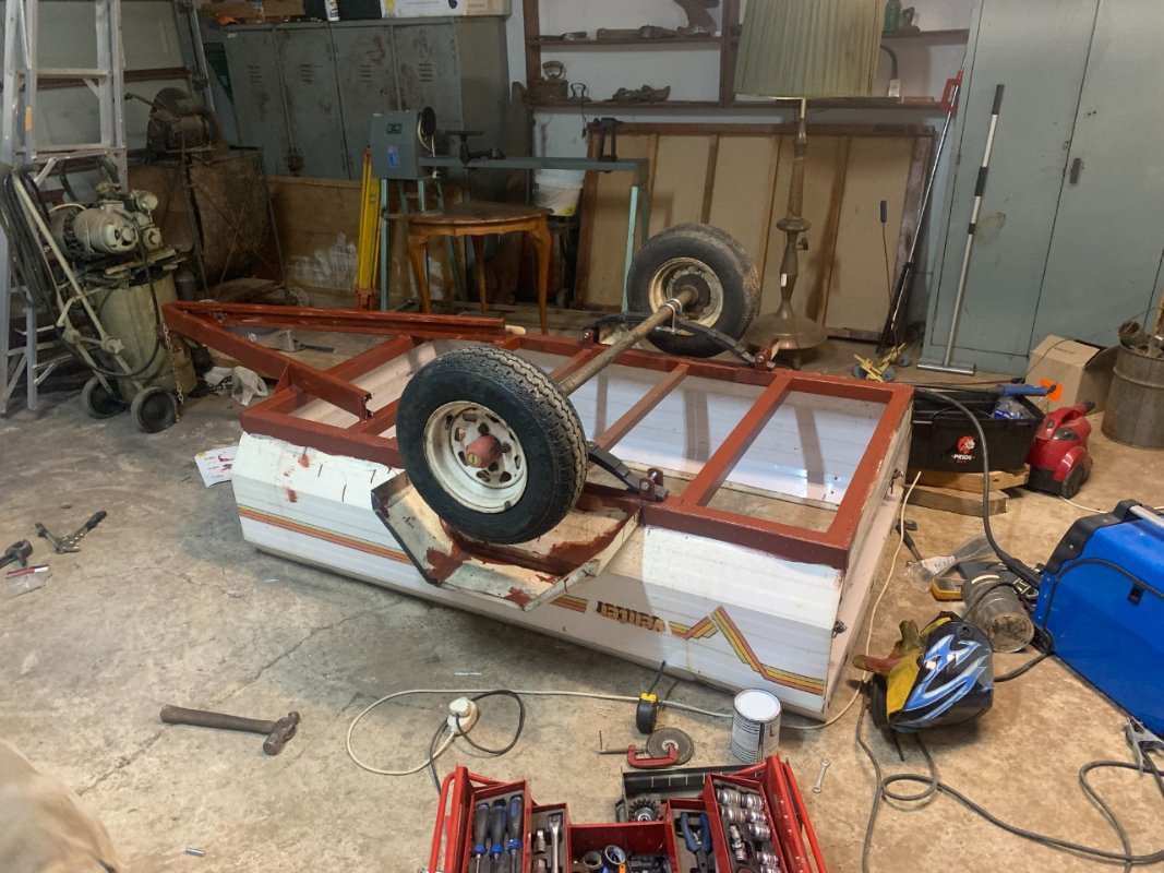

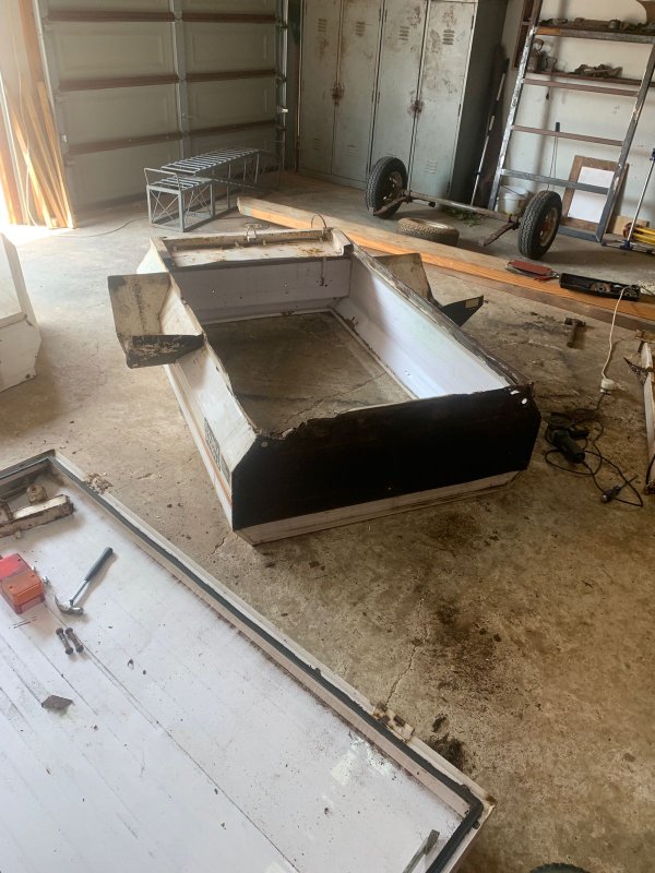

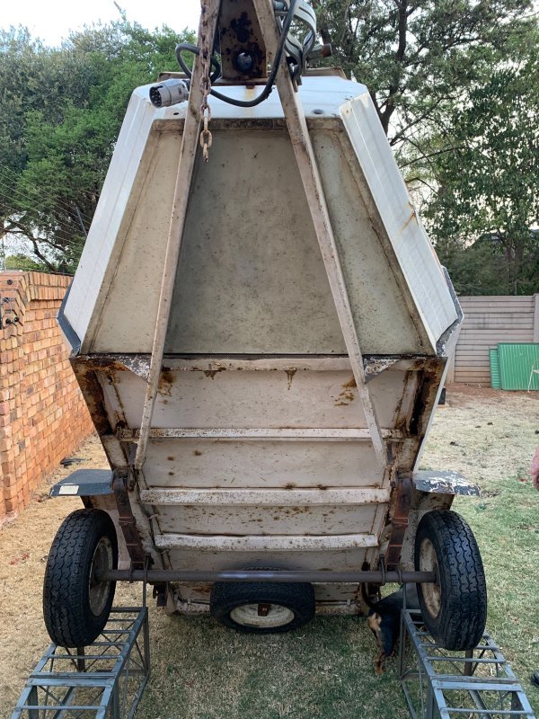

So flipped it around, bolted off the small bits and pieces only to find more and more rust. Removed the axle with wheels and leaf springs (560kg spring load)
Looking at various options to either to fix up the rust bucket or only create a quick fix and drive until the wheels fall off(too late I believe)

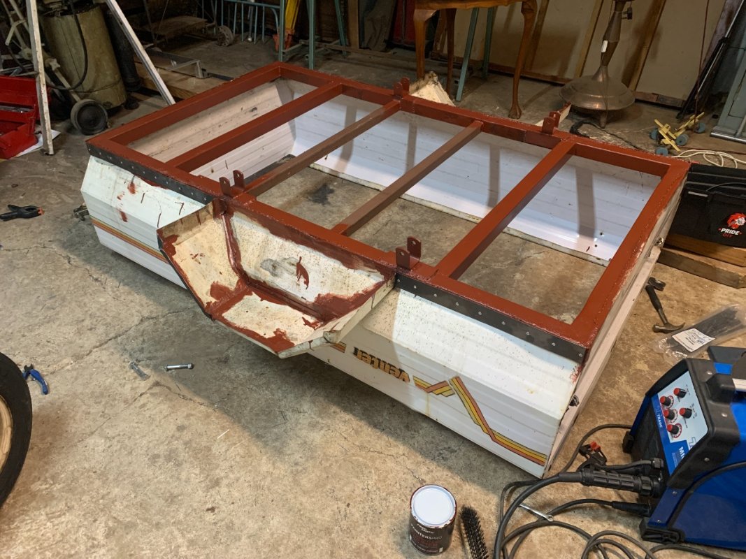

I decided to go ahead and cut out the complete bottom, because I decided to make my own ladder frame Chassis (50x50x2), cause why not...
Now started the fun part to Mig weld the body to the ladder frame... 3 days Later. Also having to mention that I used a product called "End-Rust" everywhere I did not cut out old sheet metal to prevent further corrosion and followed that by some red-oxide.

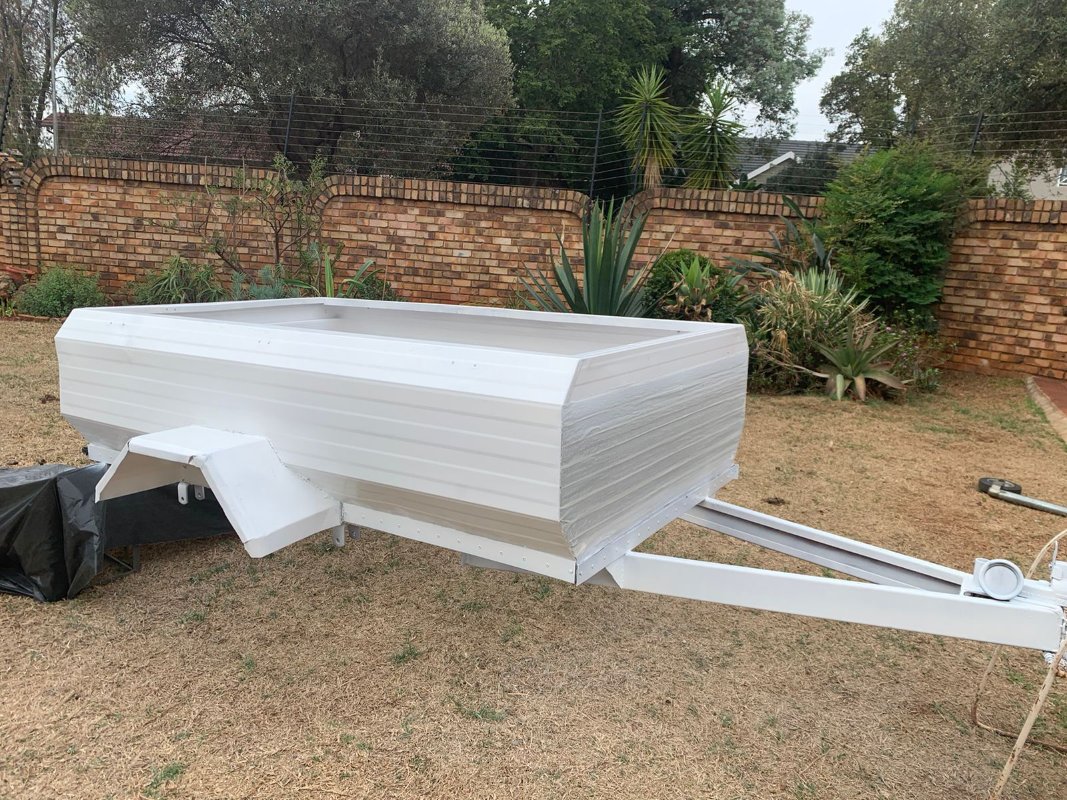

Now time to check if the alignment was done correctly from the tow-ball to center hubs and bolt it all off again to be sprayed.

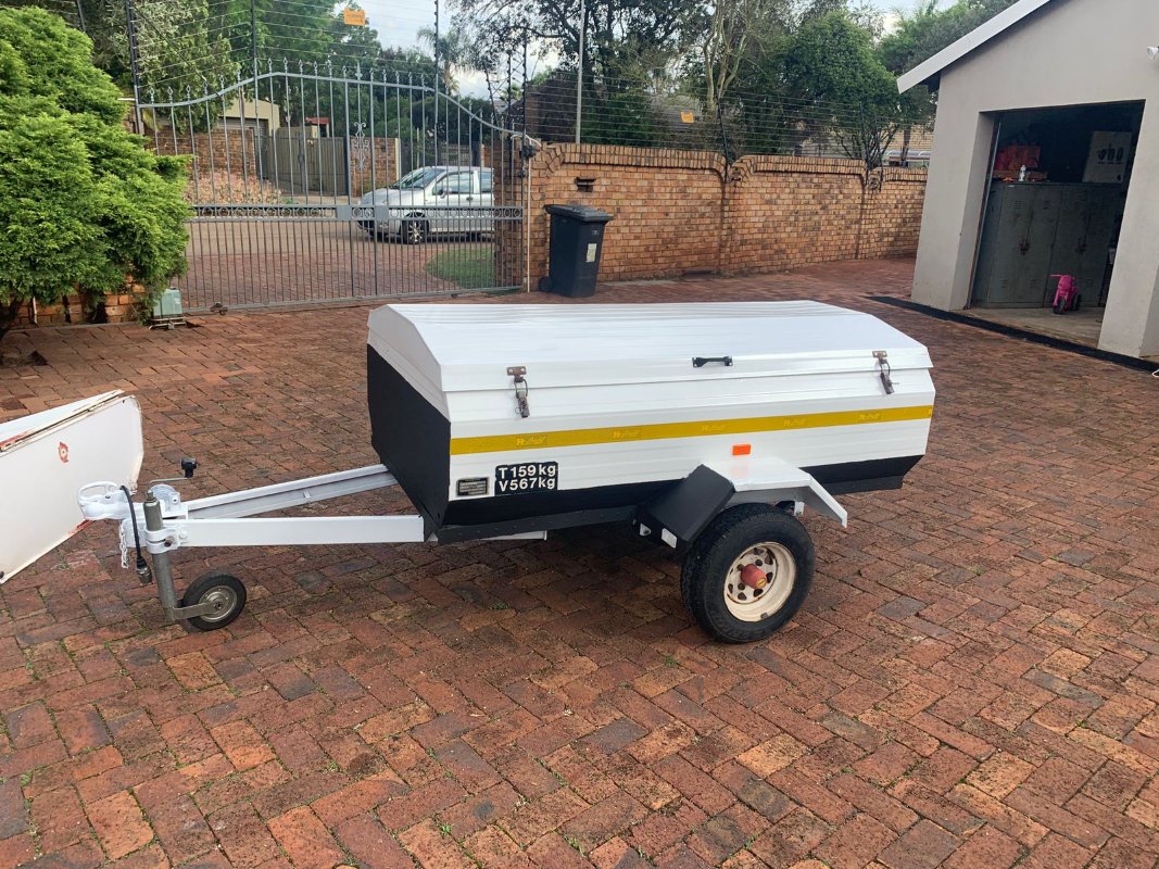

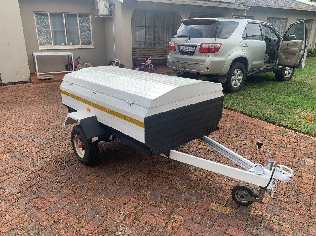

Using and orbital sander and taking off the hideous venter stickers, everything was prepped and sprayed, (Yes I sprayed the towing knob as well, because I was lazy)
Taking some bakkie liner I painted the front and the wheel arches to avoid massive stone chips.
I decided to sell the nose cone, I have other ideas for the front, and did not bother with painting the rims, as I am still on the lookout for some secondhand 13 or 14 inch rims.

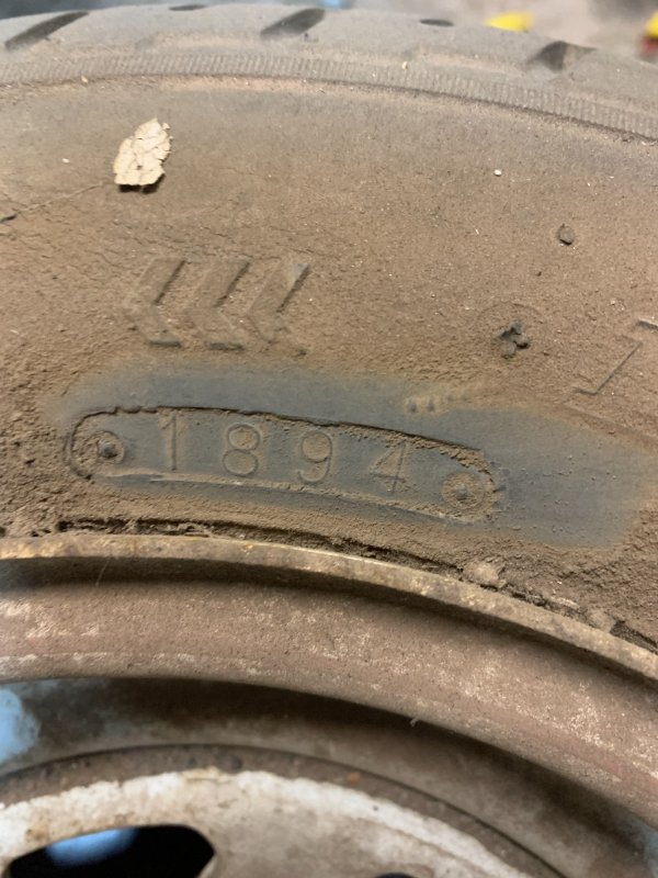

Also I might need to replace my spare tire (18th week 1994) would not trust them.
Anyway, all wired up, took it for a test run yesterday, running well. Lets see if it will last another 30 years...
