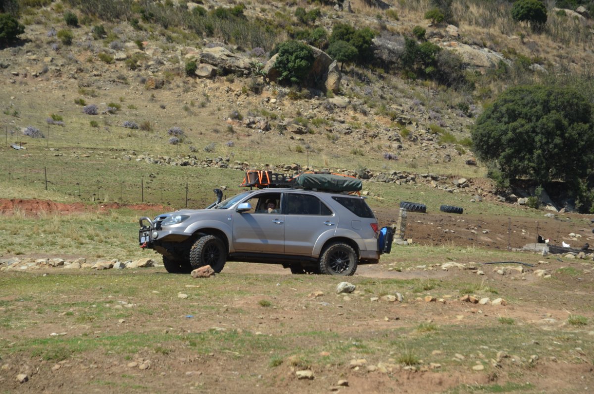

Wessel, as I mentioned to you at DVR, I fitted the Iron Man Foam cell , fitted via TWT Springs, honestly speaking, I have tested EFS, never again, Old Man Emo, very good, Ransho's very good but impractical. The new shocks is serviceable, and really compensates very well.
Considering how heavy my Fortuner was loaded on this trip I honestly rate them very high.
All my Liebherr 4x4's get ordered with the same suspension, and they run with 1 ton plus everyday.
Cost complete with both upper control arms being replaced is around R35k.
