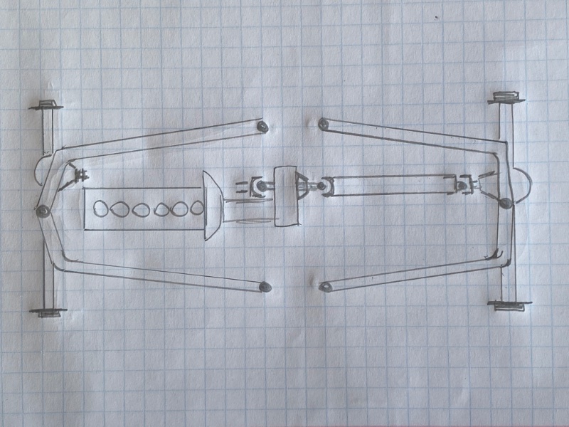

It really depends on what you can get out of it in terms of the motor length . Did you decide on steering yet? Steering box with drag link plus pan hard rod or full hydraulic with 4 link ?
Full hydrolic
4 link
Measure up and make a sketch. thats what will determine the wheel base.
If you are going full hydraulic I'm thinking you should go with an A arm (well a U-arm) to get around the length of the motor with a single top joint at the front - which means you'll need the same at the rear to keep the roll centres happy.
Quick hand drawn sketch of top ‘U’ frames - if it makes sense .

big ball joint is fine, but not great.
I'd prefer a big spherical joint pressed into a housing on the diff side myself.
but it will work!
