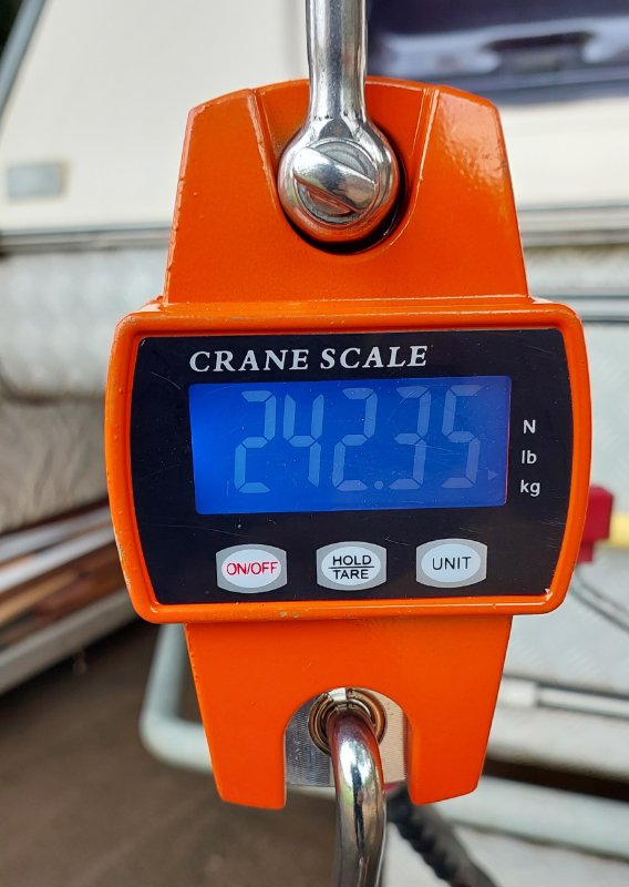

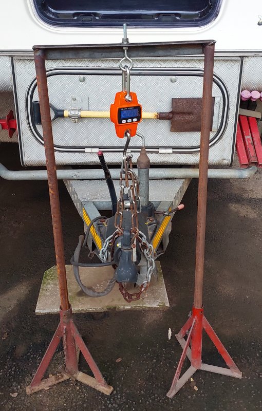

I'm reviving an older thread here rather than starting a new one with a similar topic.
I recently bought a digital pull scale that was needed for another job that I was doing. With it's range up to 600kg I thought I'd used it to check the coupling weight of our Xplorer caravan. The Xplorer's are known to have a heavy nose weight in standard trim so I interested to see what I found with our one. I built a frame to hang the scale from with the hitch at about the height it will be when hitched to the Disco.
The first reading I took was with the caravan setup as it had been left after we unloaded it after the last trip. I didn't move anything to it's normal stowage position before taking the reading which read 242.35kg.

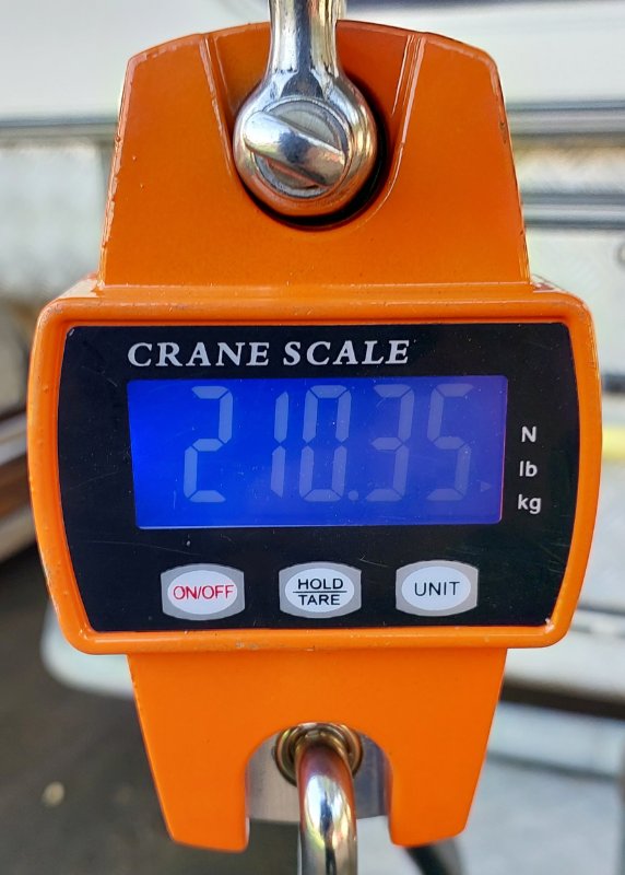

The next reading was taken after I'd put a full #7 gas cylinder and a Cadac braai with a cast iron grill plate in its place in the right hand after stowage under the bed. This gave a weight of 210.35kg which shows how much of a change in nose weight you get by adding weight at the opposite end of the caravan. The gas cylinder and Cadac braai definitely don't weight 32kg.

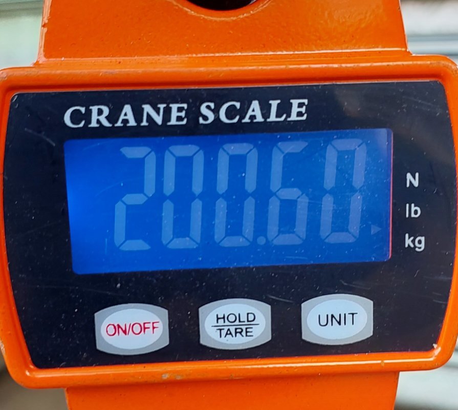

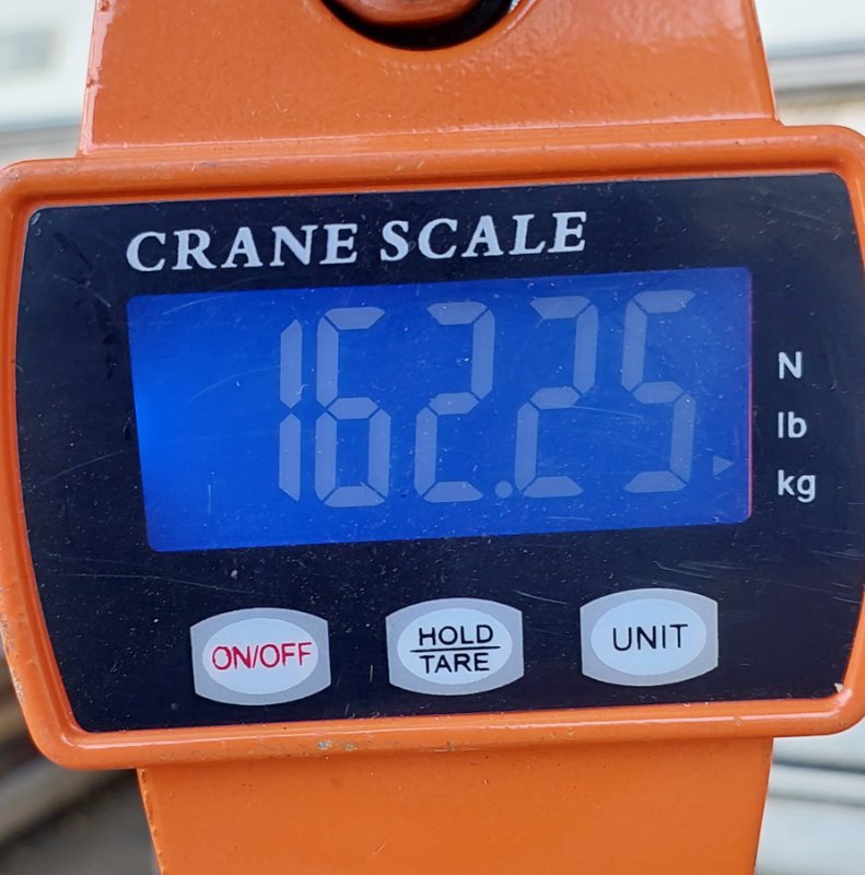

I have finished loading everything into it's correct place for our trip. The full tent that we only take along for longer stops is loaded on the floor over and just behind the axle.
The first photo is before I started loading all the additional items with all of the normal equipment in its place.
The second photo is after I've finished loading and the van is ready to be hitched up to the Disco.
This is as close to the "legal" 150kg that I can get without redesigning the Xplorer. I'm happy with this hitch weight.
