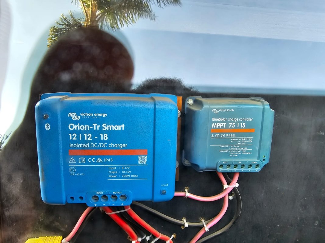

1. Victron Orion 30A DC to DC (R3200) plus Victron MPPT (R1200) (R 4400) ~ IanDVL
Two devices. Bluetooth functionality.
Onree & Bushwacker agree (sort of).

If you don't intend to do so now, you just need a DC-DC charger and later when you want to fit solar, do the MPPT.
I would go Victron.

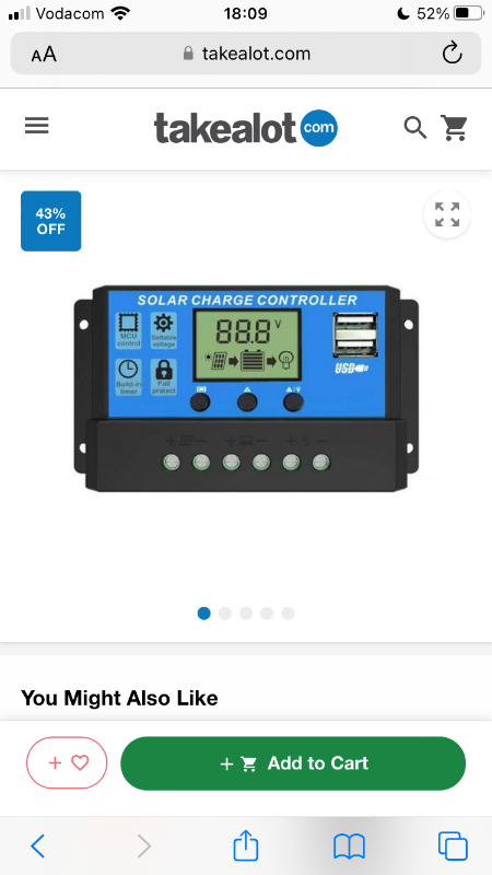

A simple solar charge controller is way cheaper than
an MPPT which is however dynamic and deemed a bit more efficient esp for changing cloud cover etc.
and
Get the Victron DC-DC which is called Orion or something.
IMO
( … not sure if depicted example works with Lithium Battery )
