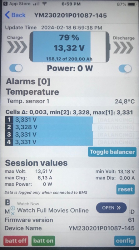

… yes … like some above I also think many of the
Li battery Brands have fairly standard and common cells
but cant comment on the merits or performance of the BMS software between them.
Below is screen of my Fong Kong one ,
shows cell balance , SoC, Temp etc
and evidently has some protective capability.
