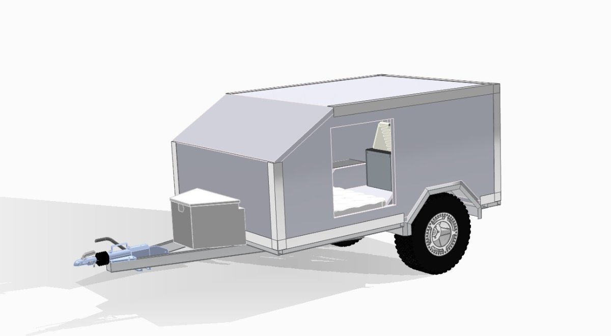

We will be releasing Uzushi LX-01 Off-road Teardrop Camper before the End of this year for Less than R100,000.00

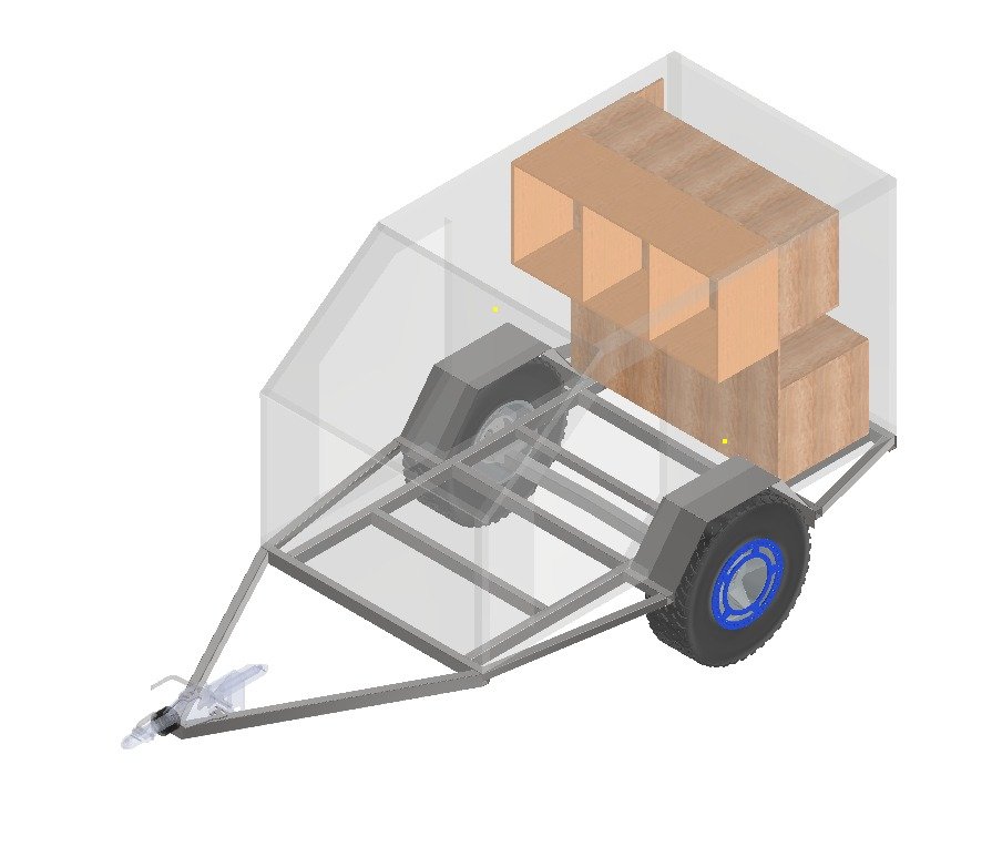

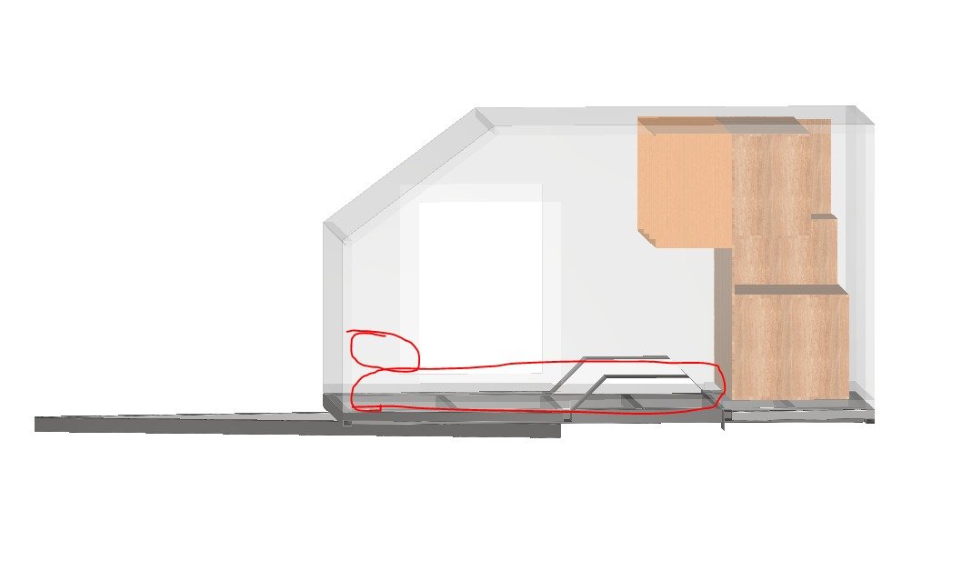

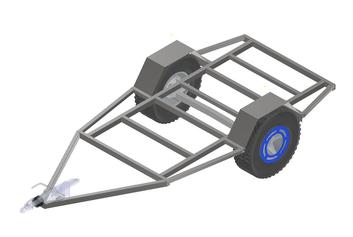

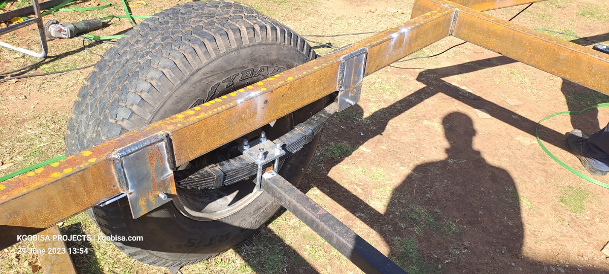

Update on the UZUSHI LX1 Offroad Trailer Build:
UZUSHI - (Zwahili word for Fabricate), LX1 - (Limitless eXplora version1).
Started with the design from Scratch, after buying a Rolling Chassis only to find out it has limitations, New Chassis designed, the Axle, brakes, Coupler and most components will be taken of the bought out Chassis and use on the new Frame. The box will be Expanded Polystyrene (Sandwich) Panels 50mm thick, Kitchen, 16mm boards. This is going to be very Slow since the budget is not great. Expect a long wait before my next update.
Data:
Box: 2800 x 1500 x 1500
Weight: To be updated later, Still adding more stuff.
Data:

Target Still Less than R100k.

LX, if you struggle with the chassis or manufacturing- I can manufacture for you (Registered MIB - Kammatech). If you need some help or advice just shout, will gladly help.
Good luck with the build, looking forward to the end-result.

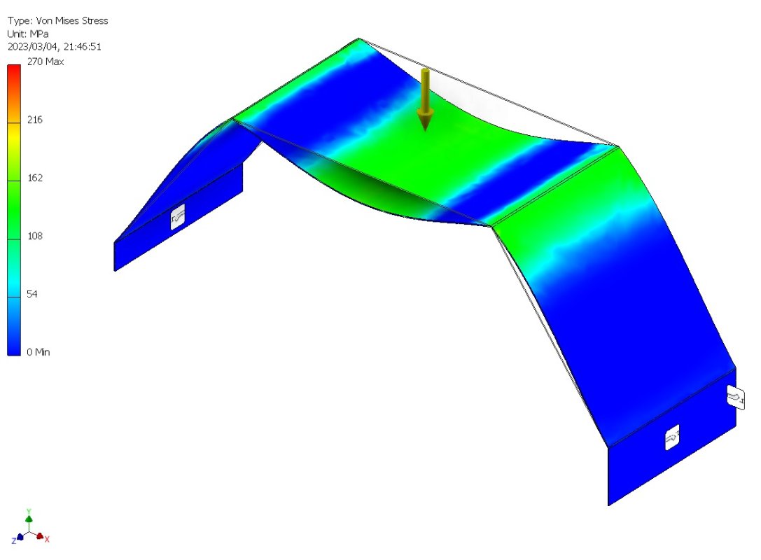

Attached my wheel arch I use on my trailers. Welcome to use or change as required.
Looking at your design, the body will be covering part of the arch -this will add significant strength to the arch.

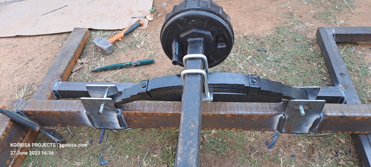

Fabrication of the LX1 Offroad Camping Trailer has started, but I'm still messing around with design iterations.
Mr LX

Alex,
What section steel are you using for that wa?
Cheers
- LX
- Has thanked: 62 times
- Been thanked: 42 times
- Posts: 269
50x50x2 in places.
