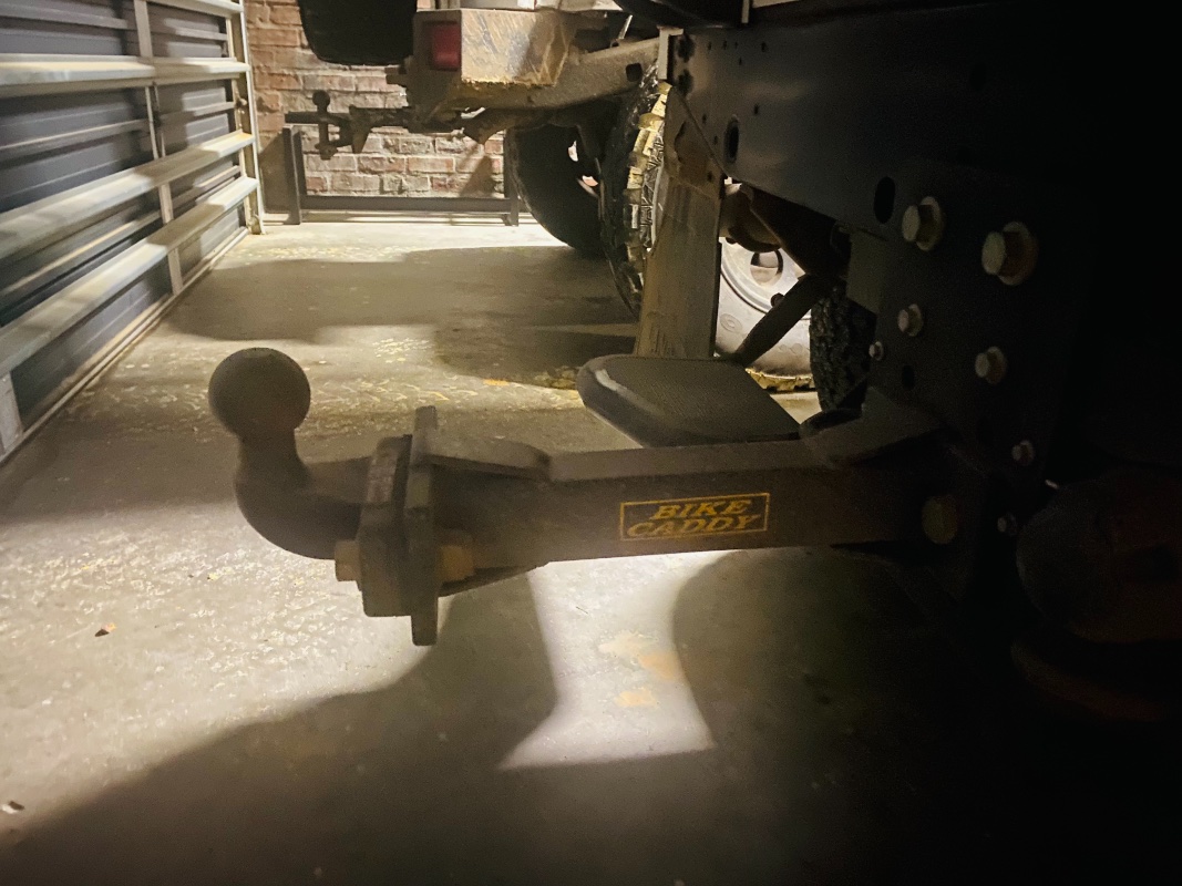

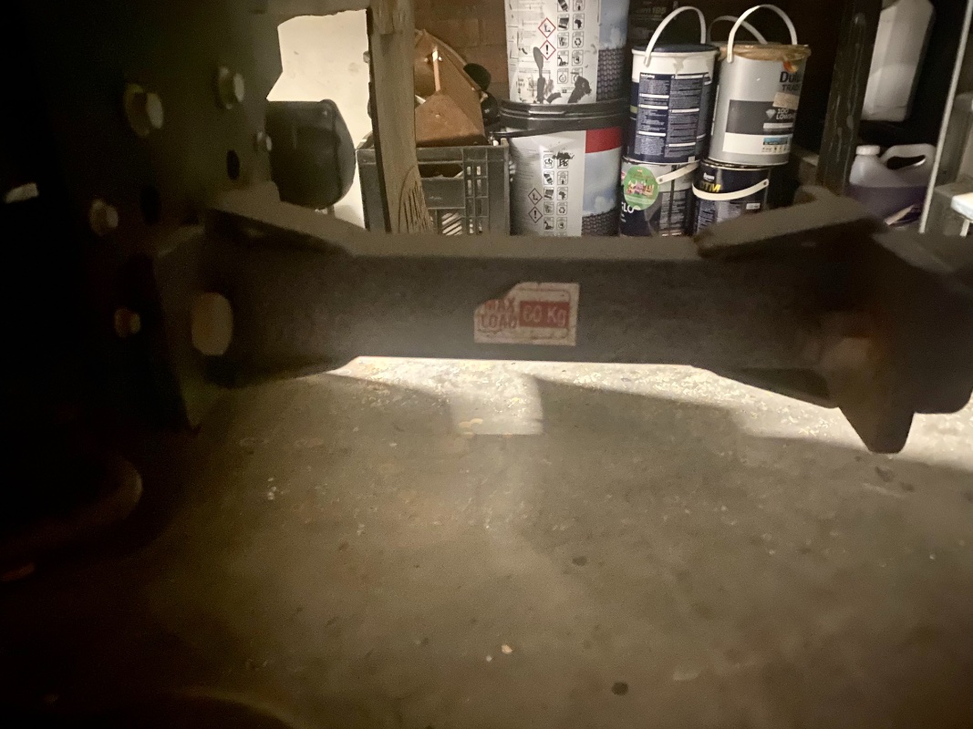

He’s old .
Henri’s towbar is the one in the opening post
The one with the extension on was posted by paul saying it has a 3500kg rating . I pointed out that the extension is only rated for 60kg vertical load as it’s designed to carry a bike rack only .
I have one on the defender because it came with it , and it makes for good rear protection .
But it reduces the rating of the tow bar.
I think Chris, like myself, gets a bit up tight over the Kak chancy second rate juggernauts that people create with bad, substandard and dangerous towing arrangements .
They kill people . As far as I’m concerned it’s pre-meditated murder when these things let go and kill someone .
#57
The bike rack extension fitted to the Defender.
The Defender tow bar is rated for a 6500kg drawn mass- not sure of the vertical load - to be safe at that load, it needs proper brakes and to be in low range .
With the extension fitted it’s rating drops to the 60kg that the extension limits it to .
Note the gusseting as a matter of interest - that’s properly placed to spread the load
You’ll also note that the Jeep’s towbar is in the ‘road’ position for those rear Enders…
