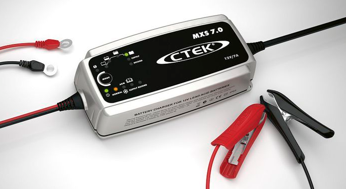

As said - I have lost three C-Teks to date.
Surely there must be something out there that kills all these super intelligent chargers? The answer is 'dirty' electricity.
Most of them are designed to endure conditions in Europe and Japan where you have very stable power generation.
What is dirty electricity? Electrical networks are suppose to absorb stuff like lightning strikes, spikes in voltage, over and under voltage and unstable frequency to mention a few.
We all know the state of Eskom. All the switching to accommodate load shedding creates all sorts of stuff like mentioned above.
Most of the campsites are fed with overhead lines which are vulnerable to lightning strikes, voltage drops with sudden load requirements.
Remote campsites run gennies in time frames to power the sites. Do not trust these types of power supply.
Electronic stuff is usually protected with sophisticated power supplies that are designed to absorb dirty electrics.
Intelligent chargers lack this type of protection as it will make them bulky and expensive. To save your fancy charger you can run it through a UPS which is made to absorb voltage spikes, over and under voltage. That means the UPS taking up extra space.
I am currently investigating a second option and that is the use of chargers that you find on Gensets. They are industrial type of chargers that have the ability to withstand dirty power. They have trickle charge functions that keep a battery at charge for months with no ill effects. They also do not harm vehicle electronics like ECU`s if put on charge without the battery disconnected. Gensets have complicated tronics and these chargers are designed to protect that. They are also well priced.
I have a charger that is 30 years old. Plain simple transformer, diode bridge, smoothing cap and voltage regulator. Its simplicity will make it last another 30 years. But without trickle charge and other fancy functions I will not use it on a battery connected to a system. But boy that thing supercharge batteries.
There are also killers lurking on the output 12V side.
Most important if your charger is fitted with a temperature probe that it is installed in a way to make good contact with the battery. Intelligent chargers read the battery temp via the probe and will adjust charge rate to the temp of the battery. Cold batteries charge at higher rates. If the probe is not in good contact with the battery you will not charge at correct rates as the battery warms up. This can ruin your charger or the battery it is charging.
Short circuits. Most intelligent chargers have protection against short circuits and overload. Running them in these conditions for extended time will damage them. Make sure you have a proper installation to prevent short circuits. You charger also needs to have the capacity to deal with the demands of your system.
Do not stress the charger trying to revive dead batteries. Intelligent chargers have battery reconditioning functions but cannot wake up the dead.

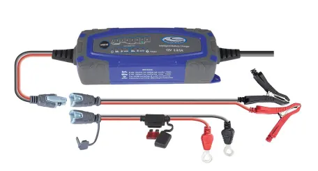

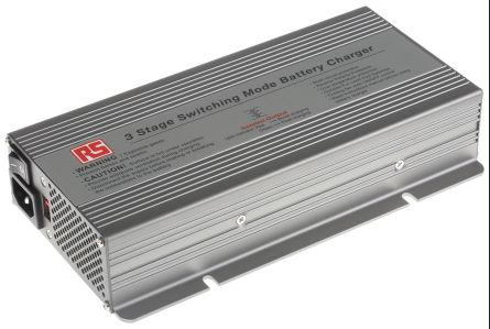

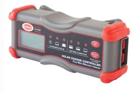

If MadMans Ctek is not viable to repair, here are some options:
Option 1: National Luna 5A charger - R1599 - It will do the job, but maybe a little low on output, so will take long to recharge 1 x 105ah Deep Cycle Option 2: C-Tek MXS 7A - R2599 @ Takealot - Personally, I love the Ctek stuff, never had an issue, higher output than the NL, so will charge the battery faster Option 3: Mean Well 12.5A charger - R1650 @ Bush Power - Conqueror use this charger in their trailers & caravans from about 2012 onwards, has a decent output for the price, seemingly a good buy for the amps delivered, in the Conqueror's it charges 2 x 105ah Deep Cycles, so will do the job with ease.

When I bought my Conqueror the "home-made" Conqueror internal battery charger had died, as they all seem to do on the older models. The seller gave me a Ctek MXS 25A charger which I have now permanently mounted inside the standard DB board replacing the std job, and its plenty to charge the 2 x 105Ah High Cycle batteries I have in there.
On a side note, in Jan 2019 we were camping in Kosi and when the 220v power is on, its irattatic, so in the 4 hours or so you have to charge your batteries the power still goes on and off a few times.
Avon's & my Ctek intelligent chargers did not really like this, as every time the power comes back on the charger restarts the charging cycle.
Another mate camping with us has the Mean Well charger in his Conqueror Compact II, it is a more basic charger, and did a better job of topping up his batteries than the "intelligent" ones, it seemed to just continue to charge from where it left off as opposed to restarting the charge cycle every time.

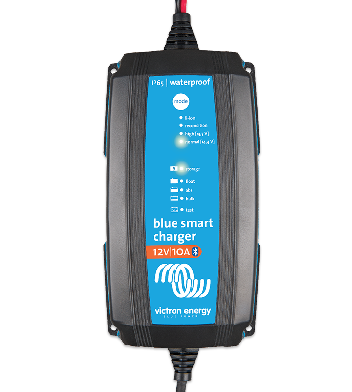

Just looking around, this Victron is a 10A charger with blueteeth, so you can connect your phone to monitor the battery condition/level:
Battery Charger Victron Blue Smart IP65 12/10 + DC Connector, on Takealot for R1913
I'm still leaning to the Mean Well if it was my decision, but another option to look at.
