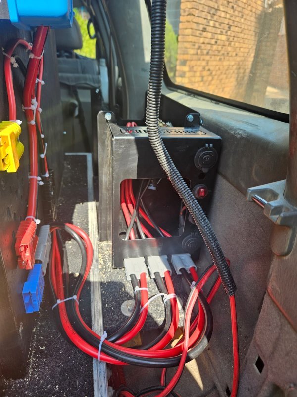

Edit1: Although I used one for many years, I'm really not a fan of the NL battery boxes anymore. The remote monitor never gives a proper reading unless you wiggle the cable. They take up too much space. I disposed of my NL box and build my own battery box using one of the "voetspore" battery boxes when I decided to go the DC-DC charger route.
Edit2: One of these. This is the only photo I have of it currently and here it was still work in progress.
