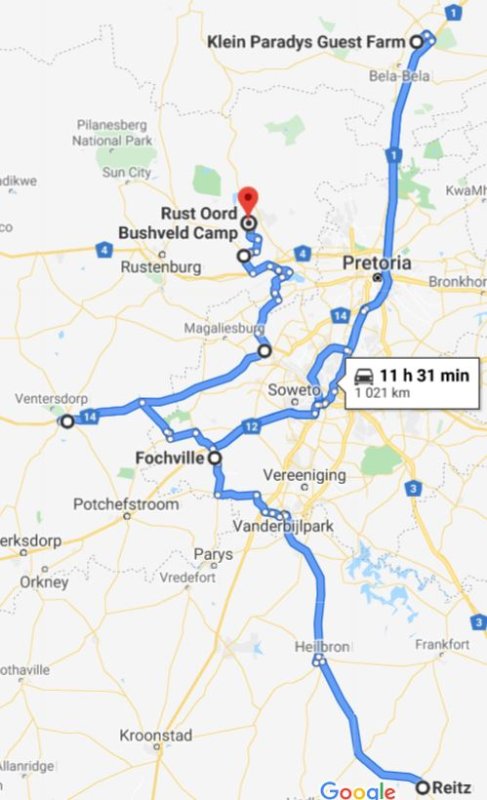

These are the roads we already traveled with the Nayela as from the 6th of Dec 2019
