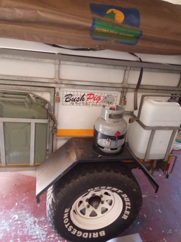

Post by Jadranko »

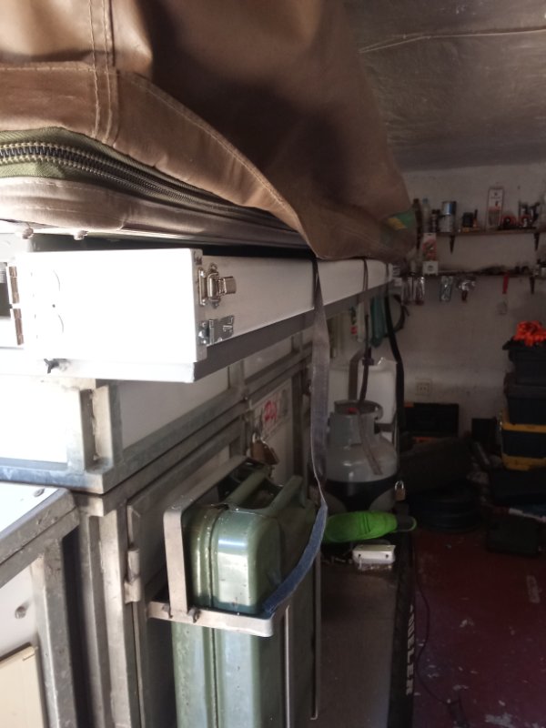

Original right side (with gas bottle )and left side with kitchenette instead gas bottle.
Previously both were same.

. fridge with drawers in front and storage under the fridge accessible from opposite side only.

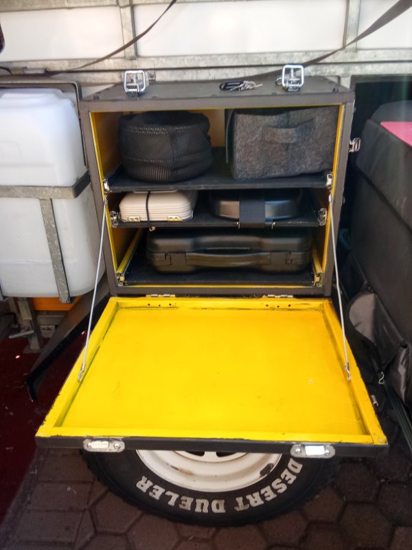

Post by Jadranko »

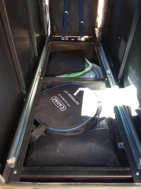

. kitchenette.
Every level is full extension drawer

Post by Jadranko »

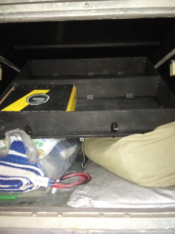

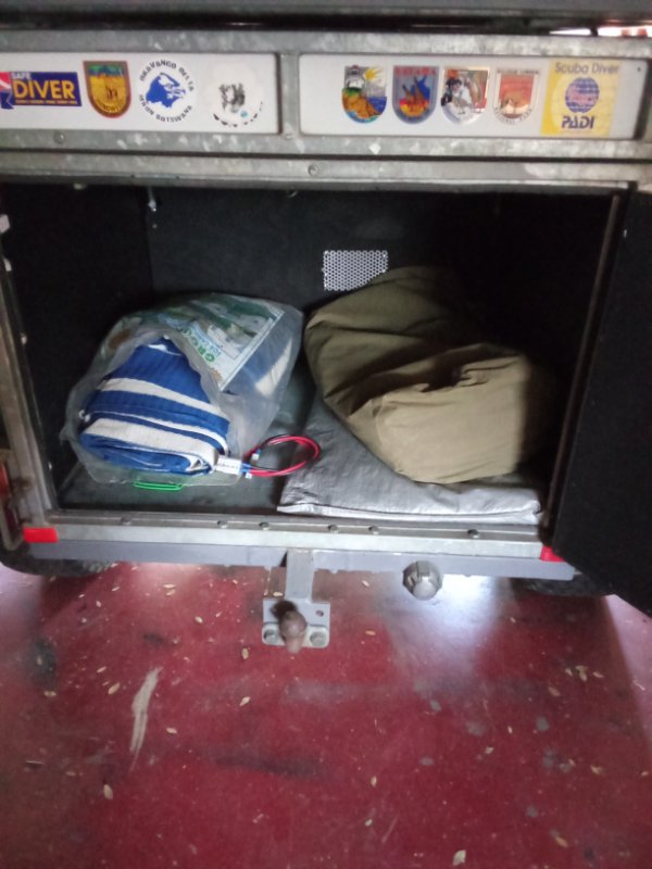

Back door access storage.
It can be accessible from top but I find it non practical lifting tent and all.
Apologies for quality of photos.

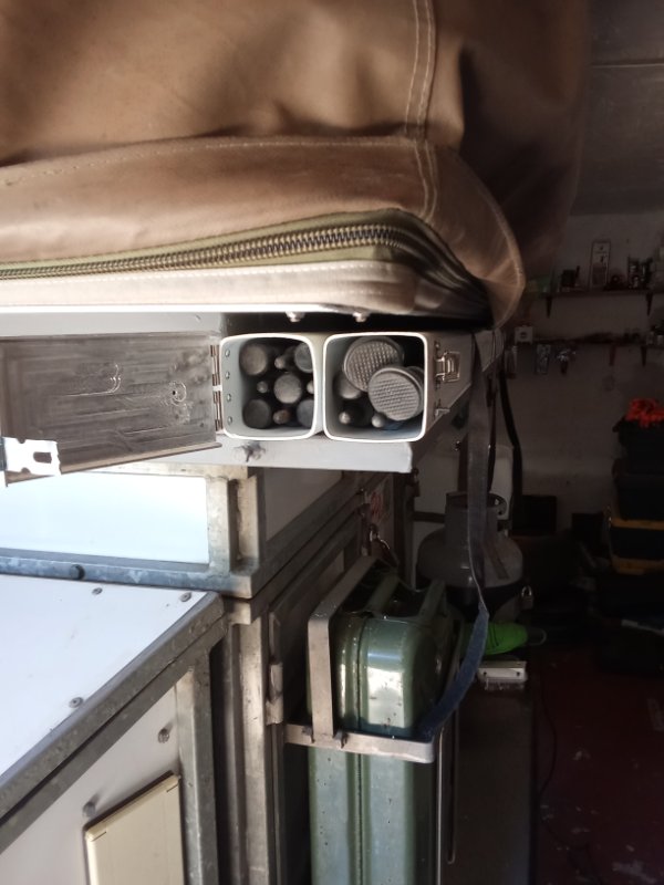

Last weekend project to store tent poles.
Until now poles were transported on top of the tent in a bag.
Diy aluminum door,75x75 PVC down pipe,latch and hinges.
Few plastic L brackets under and 2 diy aluminum clamps in a shape of 2 pipes when together securing everything to trailer frame.

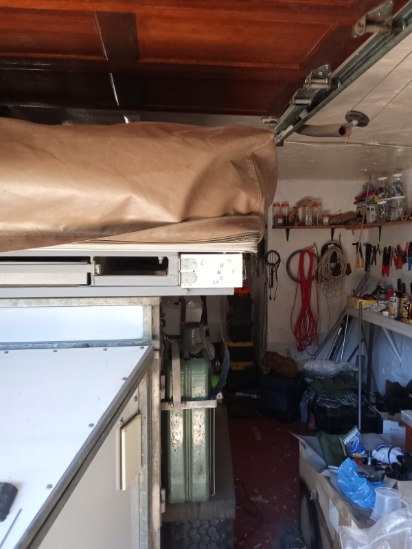

In photos 1 and 2 previous owner great idea can be seen.In a same level as down pipe ,to the left, there is catering table in it's own pocket.
Table came with the trailer,all I did was to sand it down a little and give it some hammerite.
I made a similar thing using a 110mm plumbing pipe. I closed the one end using a plumbing stop end and the other end I fitted a plumbing collar with screw on stop end. So all plumbing stuff.

unfortunately i had no space for round pipe.75mm square fits just right and there are no 75mm square pvc plugs available.
back side is closed with polypropylene plugs for steel tubing.
slight modification was required.
