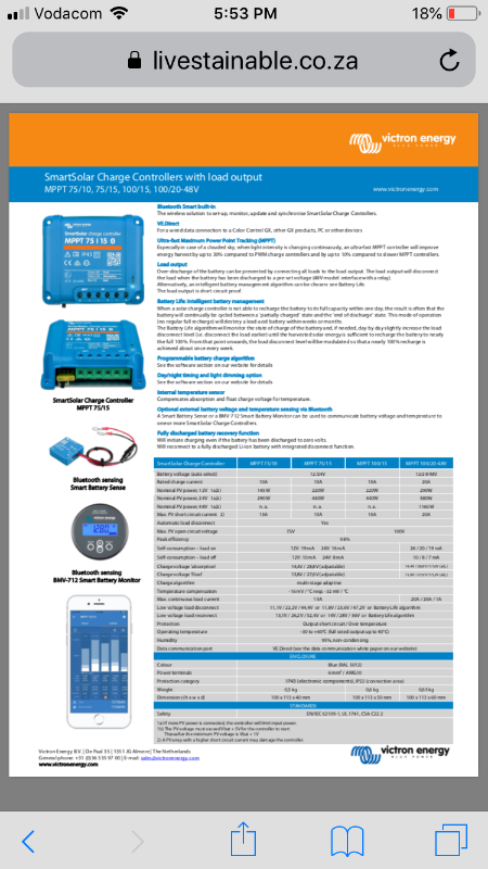

So my plan is to
Buy an 80AH Blue Nova (~R8k)
buy a Victron SmartSolar MPPT Solar Controller
(See attached specs) (+/- R2k)
and heres the humble plan ...
Make or buy basic transformers to feed
20v at 5 A to the solar controller
from either the alternator or from an existing
old unintelligent charger (mains)
Ie solar or mains or alternator will variously
Be made to feed apprx 20v@5A to the solar controller
... so I avoid also purchasing a
Dedicated Li compatible Intelligent charger
Dedicated Li compatible DC-Dc charger
for the alternator/charge battery feed.
If successful that solarcontroller will think the
Sun always shines and my BlueTooth monitor
Will keep ever informed of state of charge etc.
Will it work ?
Will it be a viable tactic ?
See the spec sheets in this site below:
https://www.livestainable.co.za/product ... ontroller/
Chas, I really wanted to post a helpful reply, but I have no idea what you are on about.
It seems you want to go Lithium but want to use a Clusterfcuk way of charging...
You want to use Transformers to force juice into the Solar Controler?
WTF?

Oom Chas... you want to fit Land rover parts to a Rolls-Royce...
Dedicated Lithium chargers are not that expensive. You are spending R8k on a battery but not using decent charging methods.
No its a bad idea to do the setup like that.
Instead of the Victron rather get a Ctek DS250 for lithium and you dont need to do weird connections that will just cause you to lose a vehicle when it burns...

You not going to like what I say but, do it once do it right. It will save you money in the end.

As has already been pointed out on this thread, that would be the correct way of doing it...
