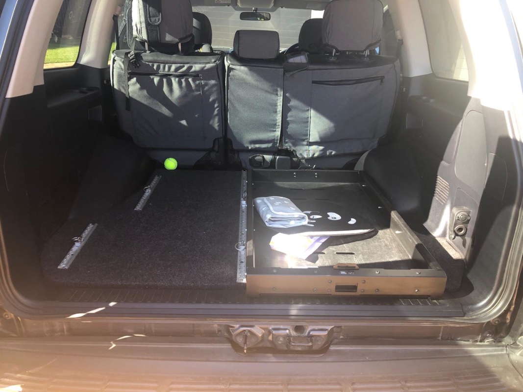

2. Frontrunner drawer system:
- Generic drawer system with 2 drawers (6 Cub boxes) and sliding top (my 1st choice so far as it is value for money at R 10500)
- Dedicated Prado 120 drawer system (6 cub boxes) but no sliding top. (not my first choice as it is R3000 more expensive with no sliding top)

*Drawer system ... refer my prev post on this matter ... get a welding/braising guy to build a appropriate set of drawers ... to your design, ... thats adequate for your needs rather than those of a Sherman Tank Commander.

As far as drawers is concerned. The systems that use up the entire width of the boot area, always leave a problem as to what do you do with your fridge. With the drawers taking up the width the fridge has to be mounted on top of them. This leaves the fridge very high and access is compromised. Yes you can get drop down slide for the fridge but that is added expense. The tilt slides are rubbish in my opinion.
I like the ones with drawers one side and fridge on the other side, with a sliding platform with tie down points across the top. Would probably have to be custom made but worth looking at. Custom made you could also sneak in a built in compressor. You have a certain area ( width and Height) to work with, you got to make the best use of it.

Anthony Forgey must be consulted to build your drawer system. He can make it custom and I am sure at a good price because he’s a nice guy like that.
Go and have a chat with him, he’s in Jukskei Park.
PS - forget about ammo boxes, they are kak. Get proper drawers, they take a lot more and are not frustrating like the lids of ammo boxes.

4. Drawer system - as others suggested - get 4Gee or some privateer to custom manufacture one.

I had a FR drawer system in my first FJ and hated it. It took up way to much space. So reverted back to ammo boxes in the second FJ. It works better for me.
In the 200 I’ve got a fridge slide and I pack ammo boxes next to it which gets tied down. Again. It works for me
The only time a drawer system worked for me was in the bakkie.
