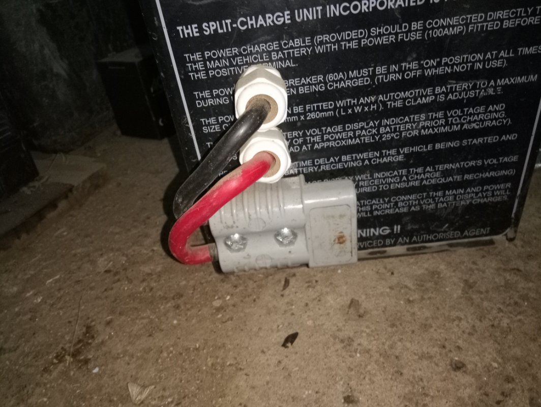

According to my National Luna control box. Red is power in , Grey power out.
- KurtG
- Location: London
- Has thanked: 11 times
- Been thanked: 13 times
- Posts: 2405
Okay, explain this then:Martin de Jager wrote:According to my National Luna control box. Red is power in , Grey power out.
A red and a grey plug don’t plug into each other.
The plug that charges the trailer from the car is power out, the plug that is on the trailer is power in.
Which colour do I choose?
__________________
- Martin de Jager
- Has thanked: 47 times
- Been thanked: 157 times
- Posts: 1119
Your choice, mine is grey on grey, dont over complicate matters,
