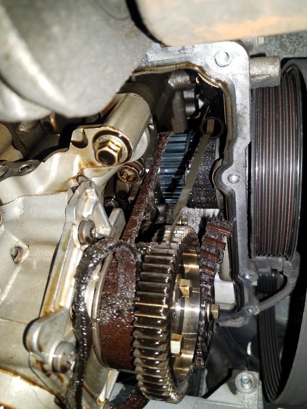

Just for interest sake, I’m on a German Mechanic forums with some REALLY knowledgeable people… someone posted this.
30k km Service interval. 55k km on clock. Peugeot Diesel motor. Timing Belt runs in oil.
Say what you want. 5000km or 7500km oil changes are not going to hurt your engine. Maybe the wallet, but definitely not your engine.
Posts: 7185
A PeeJoe would look like that even if you changed oil daily..
