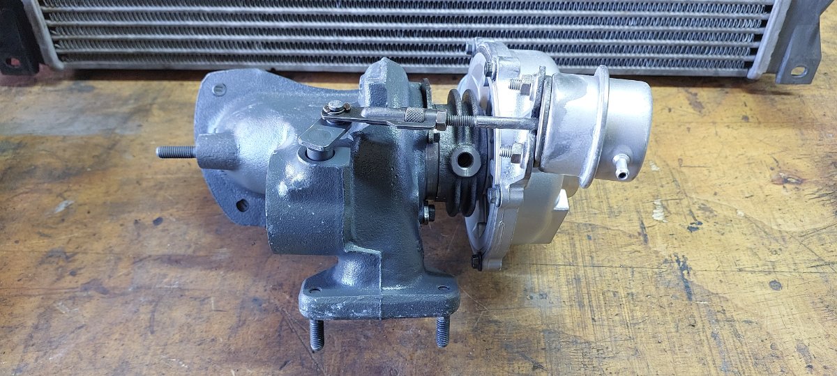

Here's the next installment in the saga of the Disco's turbo.

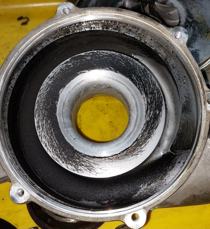

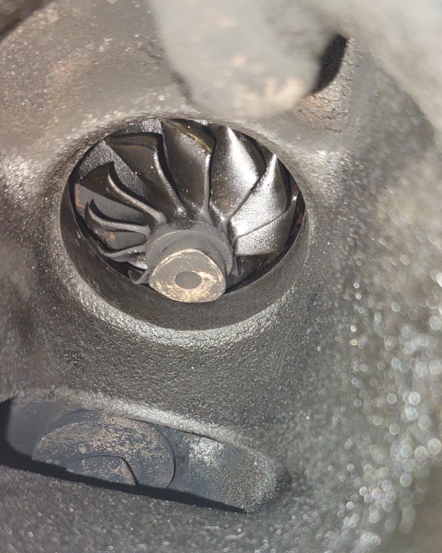

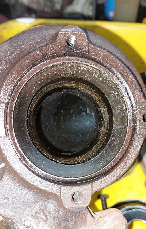

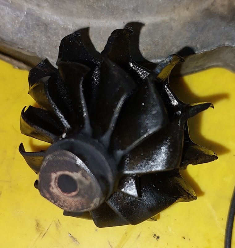

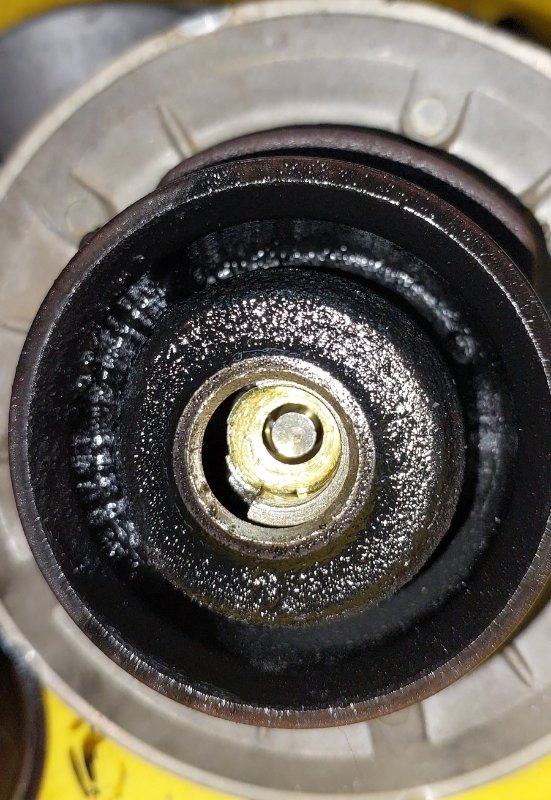

I phoned around looking for an off the shelf turbo that I could buy. This was because when I stripped the turbo out of the Disco, the damage to the hot side of the turbo was significant. The turbine wheel was completely free floating inside the turbine housing. You could see pieces of the bearing carrier through the oil drain port. Most of the places I phoned didn't have one in stock but said that they would phone me back, none of them have.
I took Manny's advice and phoned Mike Steyn at Turbo Smart. He didn't have one in stock but said that I should take my one in and he'd see what he could do. They did a strip down and confirmed that the only casing of mine that could be reused was the compressor (cold side) casing. The center section was scrap and the turbine casing was damaged from the turbine wheel not being attached to the shaft anymore. He said that he could build me a reconditioned unit for R6000 which was less than half the price of a new one from Goldwagen or buying one in the UK. I paid him on Friday and collected the replacement turbo yesterday (Tuesday).

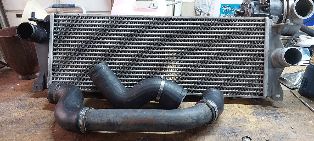

While I was waiting for the turbo, I stripped out the intercooler and pipes up to the intake manifold. There wasn't a lot of oil after the intercooler so I decided not to remove the intake manifold. The glow plugs have to be remove to take off the manifold and according to quite a few different sources, the wiring loom to the plugs becomes brittle with age and the heat and is liable to break. I didn't want to add to my expenses so I've left it alone.
I found that the lower right side of the intercooler had a lot of dust and old oil clogging it. It was easy to clean this with the intercooler removed. When I checked the the radiator, the gearbox cooler, and the aircon radiator they were also clogged in the same area. It was a challenge to get them cleaned without removing them but with the help of a few home made tools and half the day I got them clean.
Tomorrow I will start putting it all back together.

Manny we have looked at the most probable failure path of the turbo and ruled out the chance of it being caused by foreign object ingestion. The compressor impeller doesn't have any damage and is still attached to the shaft into the bearing housing. The damage on the turbine impeller is also not consistent with FOD. The outer edges of the vanes are curdled over from it coming into contact with the exhaust housing while spinning at extremely high speed. This indicates that the most likely start of the failure was the shaft failing. It didn't seem to have seized from lack of oil because of the oil that was pumped into the exhaust.
