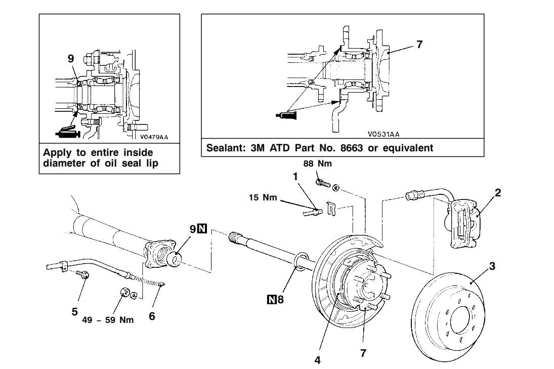

I am with Appoc that water does not get by the seals easily. However in depends on the rear wheal bearing setup. In some setups you have a side shaft inner seal, then a pocket or space for the bearing then a side shaft outer seal and hub flange. In this case the bearings are not lubricated by oil from the differential but by grease packet into the pocket. I have seen water present in the grease on numerous accounts.
Make sure what the setup on the Pajero is and have it checked.
