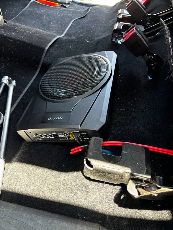

First things first, ran a 10mm2 cable from battery (with a 100A fuse and Fuse Holder) into the rear of cab. As mentioned before the sound is dog awful, but we fitted a Flat-Sub/Amp under the seat that has made a huge difference. Earthed into the chassis through the Seat Bolts, and Amp is hooked up with a standard 50A plug. If I need it for something else, I can just hook up to that plug. Since it isn't isolated from main battery, I won't ever go this way, but it's good to have options.

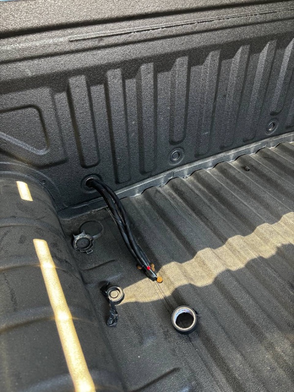

Now for the actual interesting bit... Ran Wiring into the rear of the bak, through the grommets between Cab and bak. Earthed at Chassis where the Fender bolts into the frame.

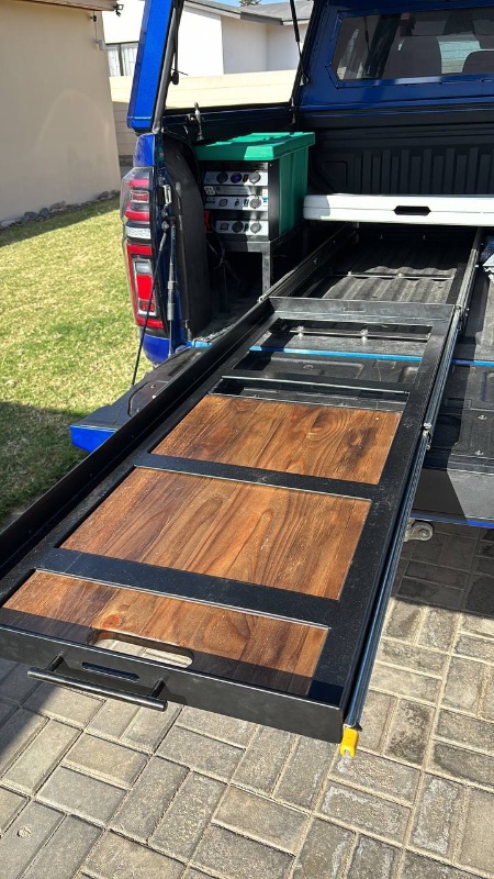

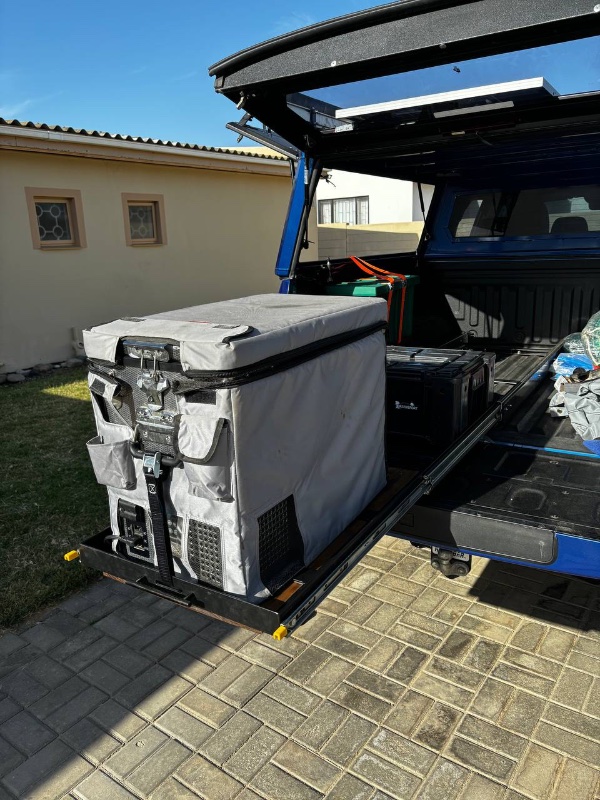

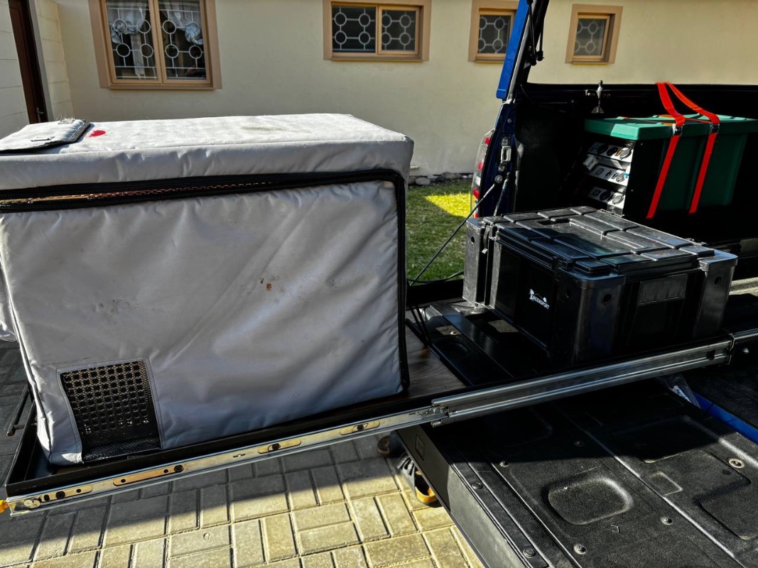

Next step, I had a Fridge Slide + Battery Tray fabricated by Juka Engineering in Swakopmund. 1400mm slides, 180kg weight rating. Slide is built to load the fridge and two ammo boxes stacked on top of each other. As an extra feature, I had a solid Wooden chopping board fitted to the slide, can pull out once fully open. Rock solid and very well designed.

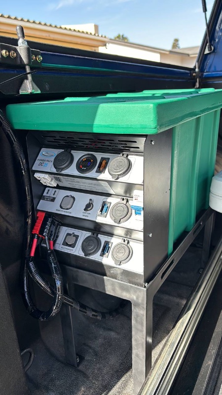

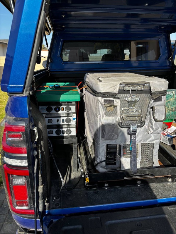

The battery Bracket is designed around the NL DCDC 25 Powerback, bolted to the tub and also mounted rock solid. Running a 100A Gel battery, so far it has gone 4 days between charge running my SnoMaster 42l.

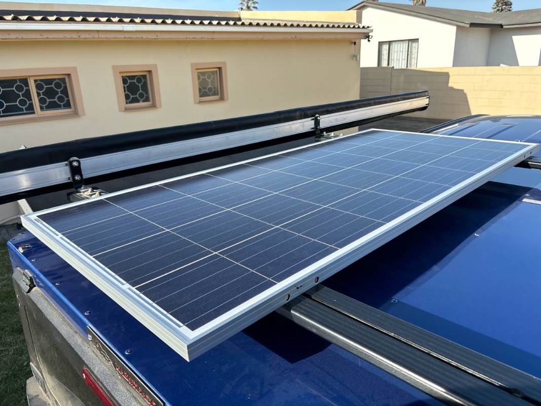

Lastly, I fitted a solar panel and some lights inside the canopy. Solar panel came out great, 150W unit mounted to Front Runner Loaders. Drilled through the canopy roof and filled the gaps with Sikaflex. Has been waterproof without any issues.

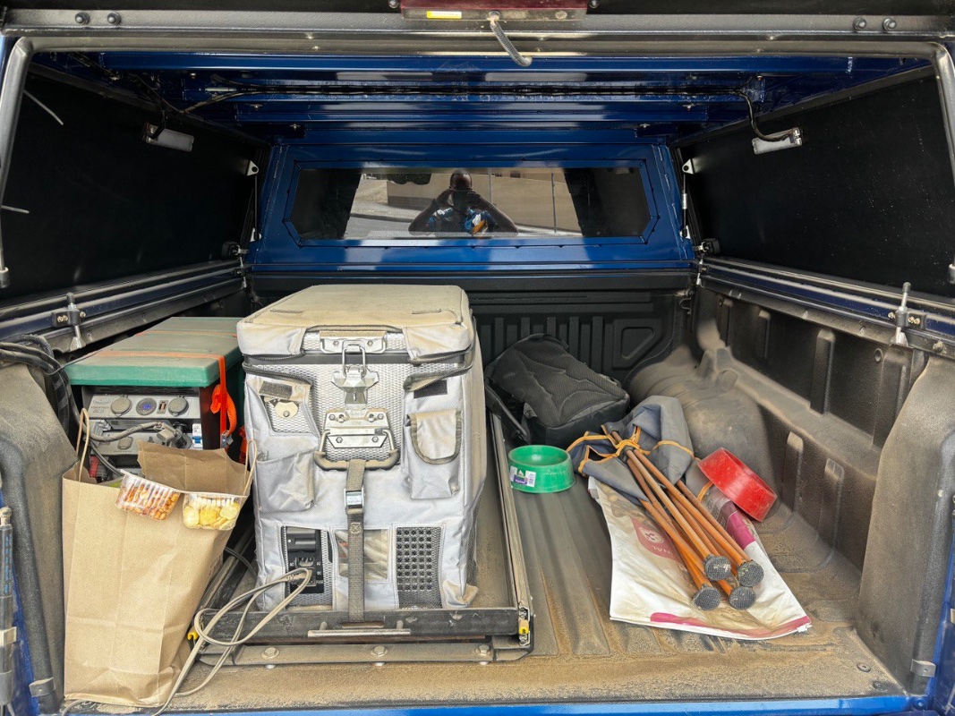

Next Steps:
Dust proofing the canopy. We do a lot of gravel travel, so it gets a little wild back there :D
The wiring is a mess, so I will be running all cables along the side of the slider using some D-Clamps to get the cables neat and out of the way. The wiring for the lights needs to be reworked. if you look closely, you can see that I originally glues the wiring in place but the paint of the canopy was done very poorly so it came apart very quickly... (another issue for another day)
Overall, I'm happy with the setup and how everything works. We've been on 4 trips so far and I've never had beer go warm.
Has thanked: 377 times
Been thanked: 275 times
Posts: 1526
#94
Nice setup that you have done. The only thing that I'd do differently is to run negative cables to each power point instead of relying on the body for the negative conductor. I've never had a problem with doing installation with two cables but have chased bad earths numerous times when working on vehicles that have an installation like yours. There are just too many places where a slight bit of corrosion starts and you start getting a high resistance area. Normally if I have a problem with a system like that, the first thing I do is run new negative wires which fixes the problem straight away.

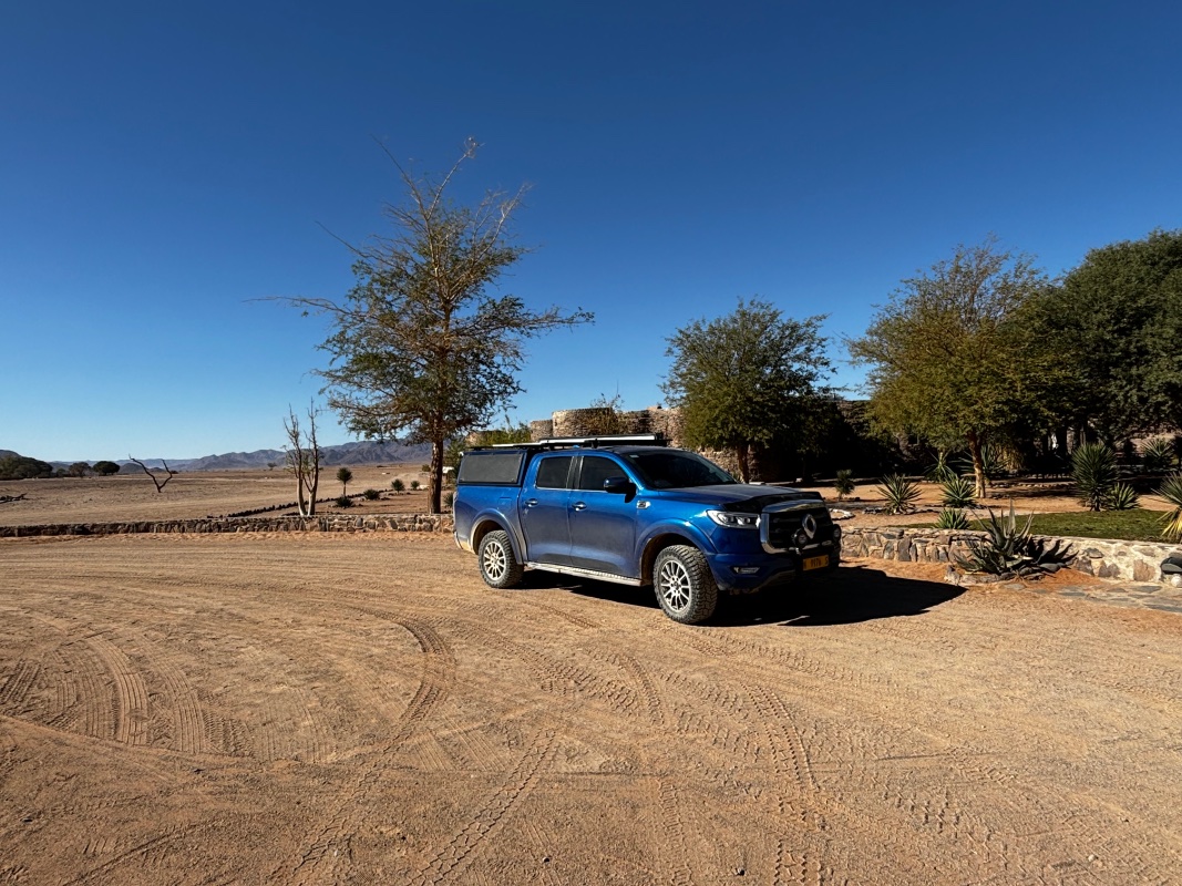

Manny threatened to visit me for a weekend if I didn’t share my latest update, so here is a quick check in.
Currently sitting at 32,000km, and still going strong. No oil leaks to report :D . One annoying thing however, are the wiper arm springs that seem to have gone limp, making my wipers bounce when parked. Not a train smash, but still annoying. :?
Did a quick trip to Sossusvlei in July, and again I’m amazed at the gravel ability of this bakkie, it’s really comfortable. Sand driving in Sossus was easy peasy, tires down to 1.2 Rear and 1 bar fronts and just plodded along in low range 4th and 5th.
Oh yes. I also did a thing:
Brand New Tentco 1.4m Rooftop tent fitted on Frontrunner Loadbars. It rattles and the cornering has gotten worse, so I’d call this a great success.

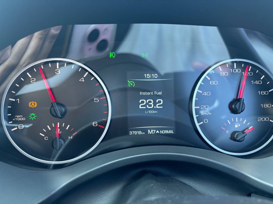

Averaged 12.4l/100km over the 4850km we did.

If you’ve ever driven from Noordoewer into Namibia, you know that you are climbing for about 45km… this is what fuel consumption looked like. 🥹
