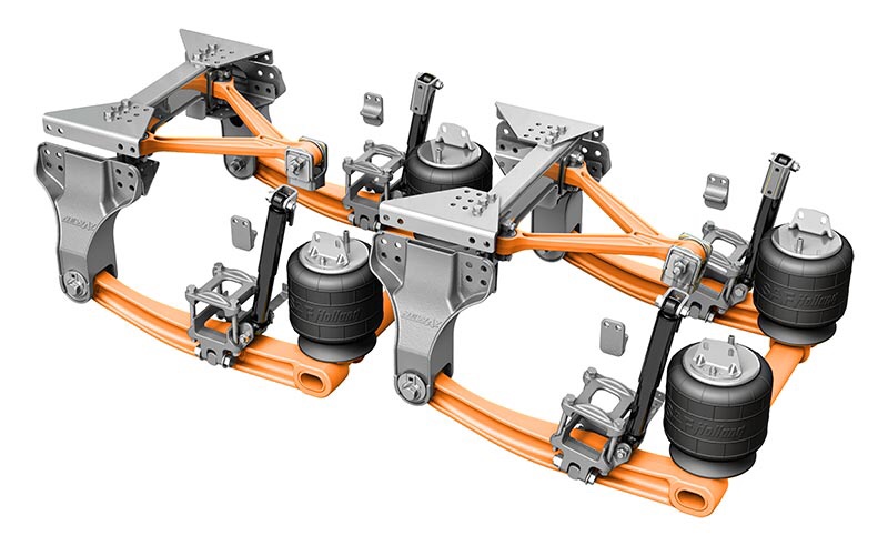

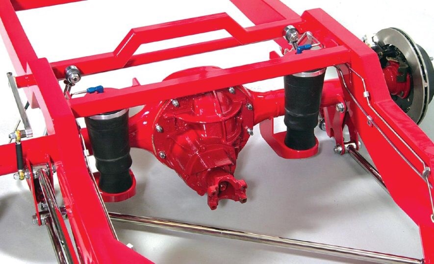

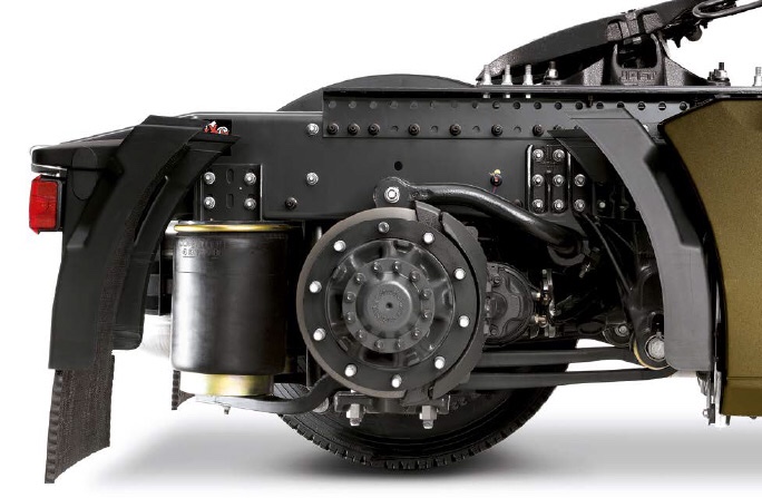

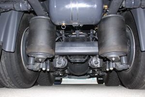

This is very true , and air suspension / air assisted leaves have been around for decades in trucks .
But always on beam axles in trucks . Leaf springs provide the axle location if equipped or it’s trailing arms which tends to mean more maintenance issues.
Airsprings have also featured in luxury sedans since the sixties - the Merc w100 limos spring to mind - and are incredibly reliable . Sadly air suspension has developed a bit of a bad name in recent years thanks to things like the disco 3 and 4 .
Trailing arms
