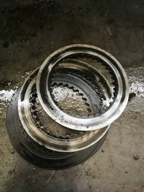

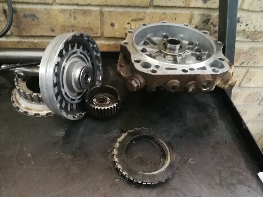

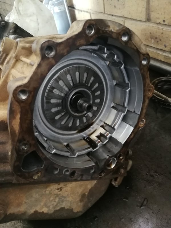

So I got to do the hospital visit today. Overland Worx is one busy place but Peter and his guys took time to show me the disassembled gearbox as well as around the workshop.
The clutch packs were totally stuffed as expected with some of them having as good as no friction material left on them at all. While we were there the new spares arrived so it should all get reassembled and the gearbox refitted quite soon.
From what I have been able to find during my research into the possible causes of this type of damage, low oil level is the most likely culprit. When I bought the Disco, I was told that the gearbox had been previously serviced by some specialist about 6k km before. Soon after I got it I drained and serviced the oil in the box. The oil was full of friction material and the quantity was a lot less than it should have been. This is what I feel caused the failure of the gearbox.
I have faith that the work done now will allow me to have a good few more years of fun with the Disco.
