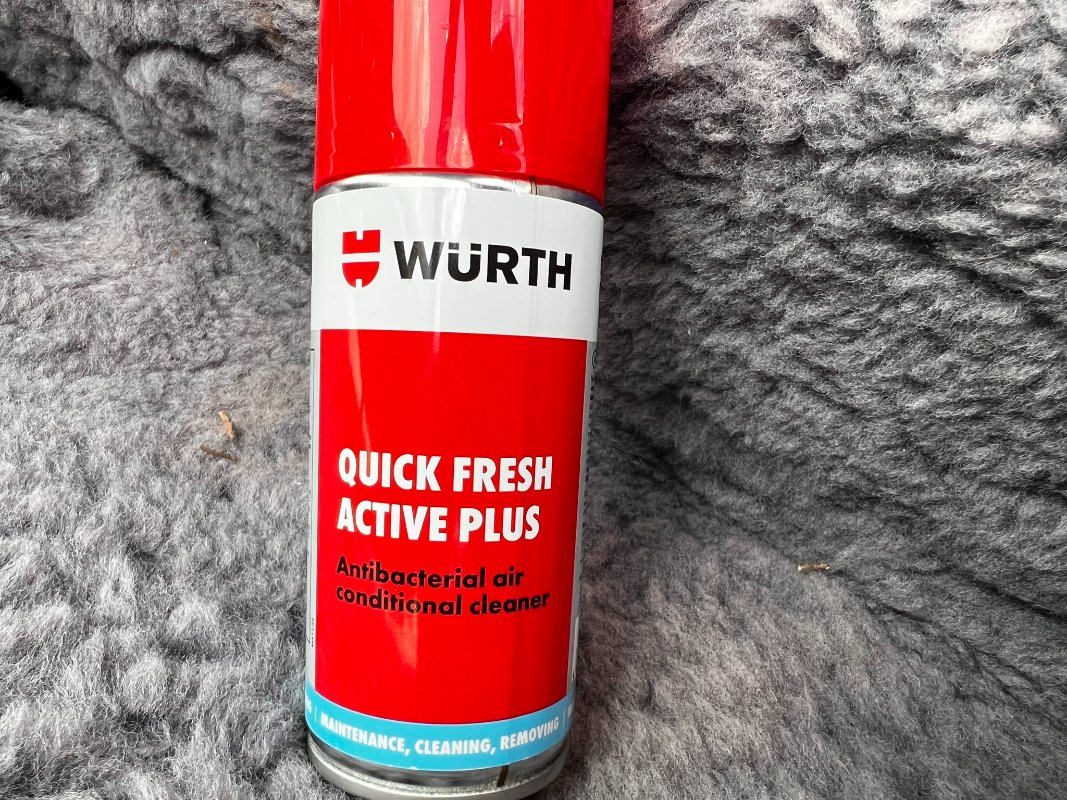

One thing I always do to keep my vehicles fresh is a deep clean of the air conditioning system. Wurth offers fantastic products for this. I recently used their Antibacterial Air Conditioner Cleaner. It’s super easy to use just remove the cabin air filter, turn on the fan (AC off on circulation mode), and spray the cleaner into the footwell.
To make the process even easier, I removed the glove box on my Fortuner (and previously my Hilux). It simply unclips and slides out, allowing the cleaner to circulate more effectively.

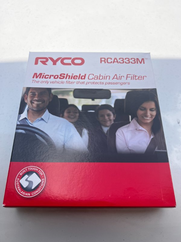

While you’re in there, it’s a great time to replace the cabin air filter. I’ve been using Sparesbox for ordering of parts (Same blokes that 4WD247 have been punting on their channel www.sparesbox.com.au). The Toyota OEM filter can sometimes compress under heavy air conditioning load, but the Ryco filter I got from Sparesbox is much more sturdy and maintains its shape better in my opinion.
New Ryco
