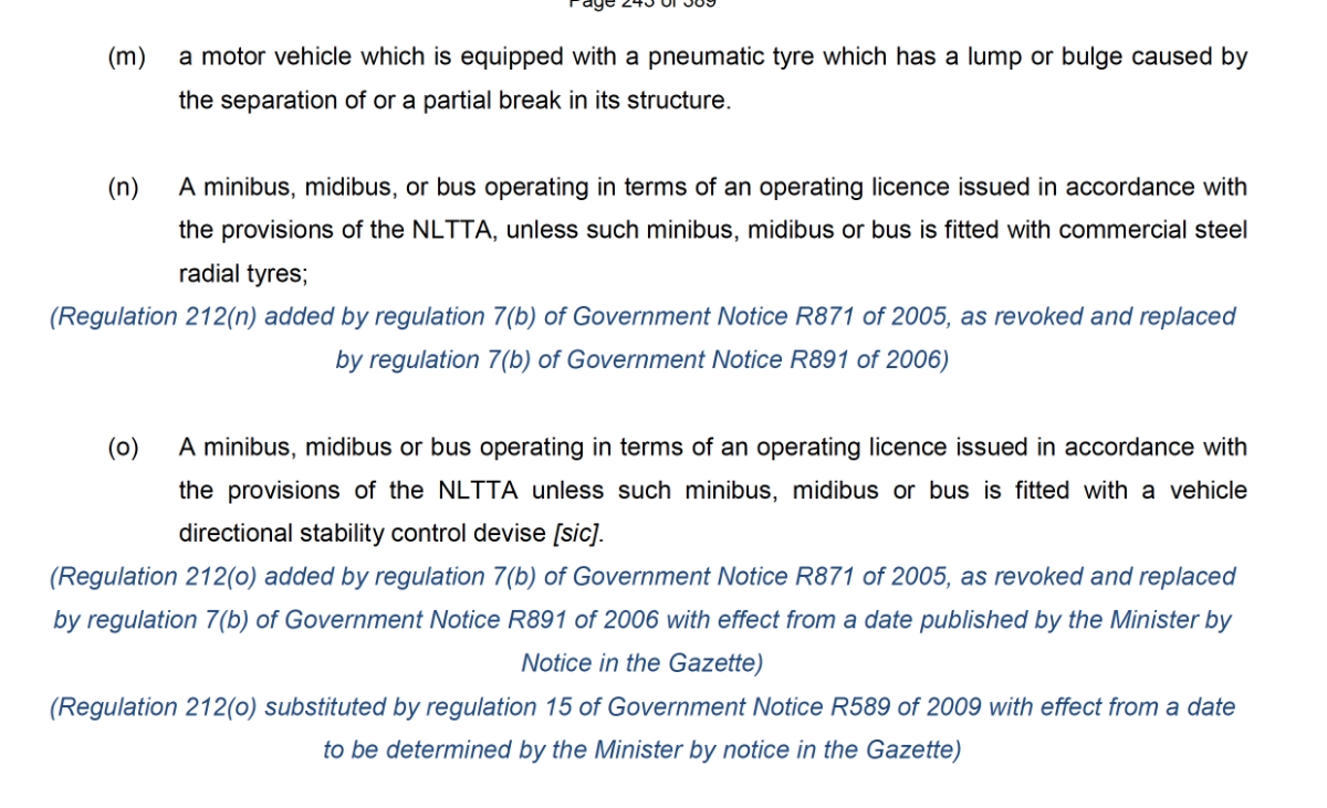

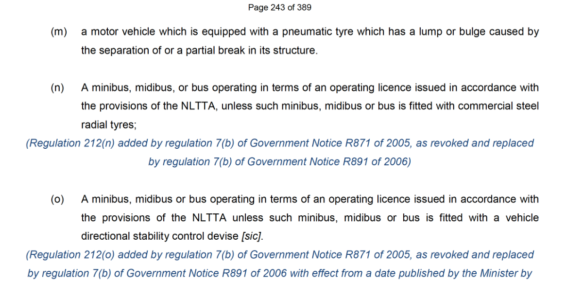

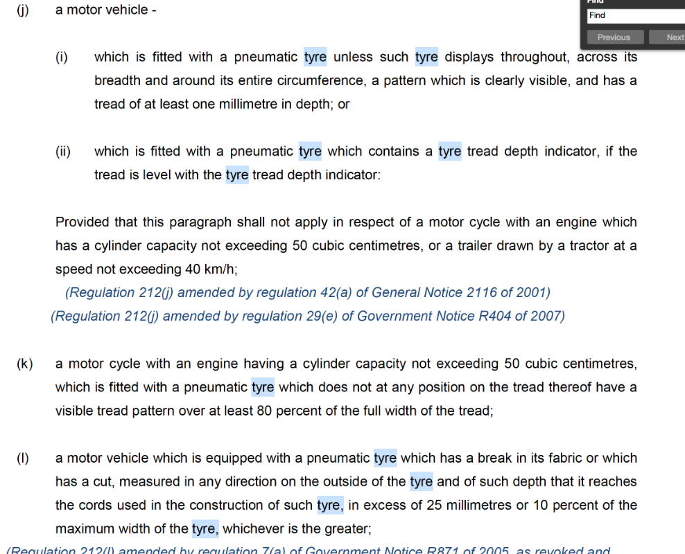

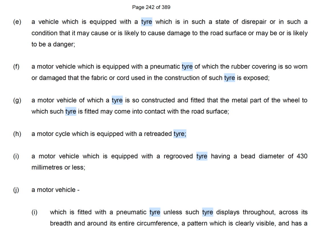

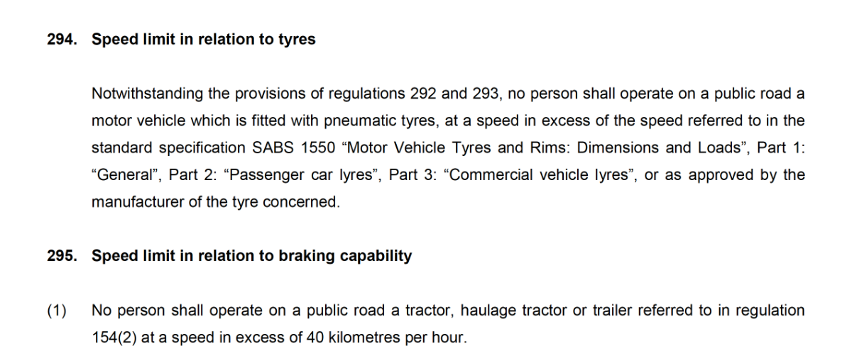

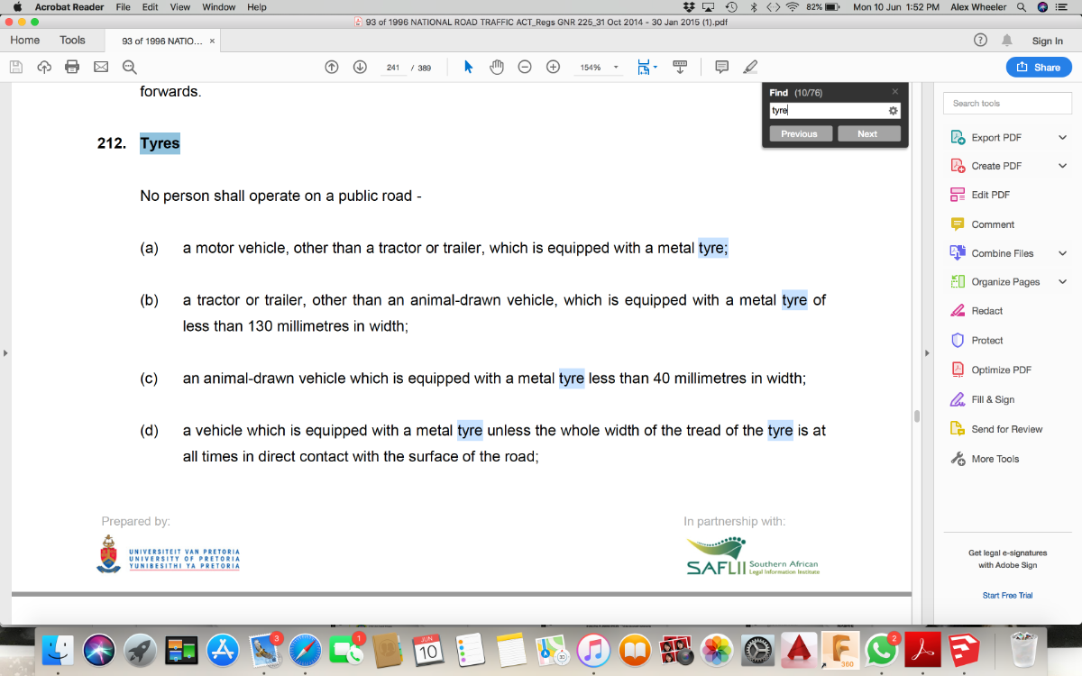

Who decided on this rule of thumb?
To whom does it apply? see, the NRTA is easy. it applies to anyone who uses a public road.
This made up tyre rule doesn't...
Here are some actual enforceable rules about tyres...
