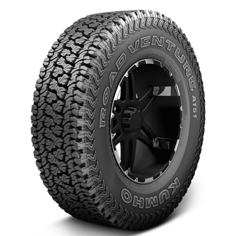

On the mommy Rocky I went for Kumho AT51. Very happy, they don't mind being deflated (lowest I had them is 0.6bar), and grip on a trail quite good. Little road noise and grip in wet is good.
