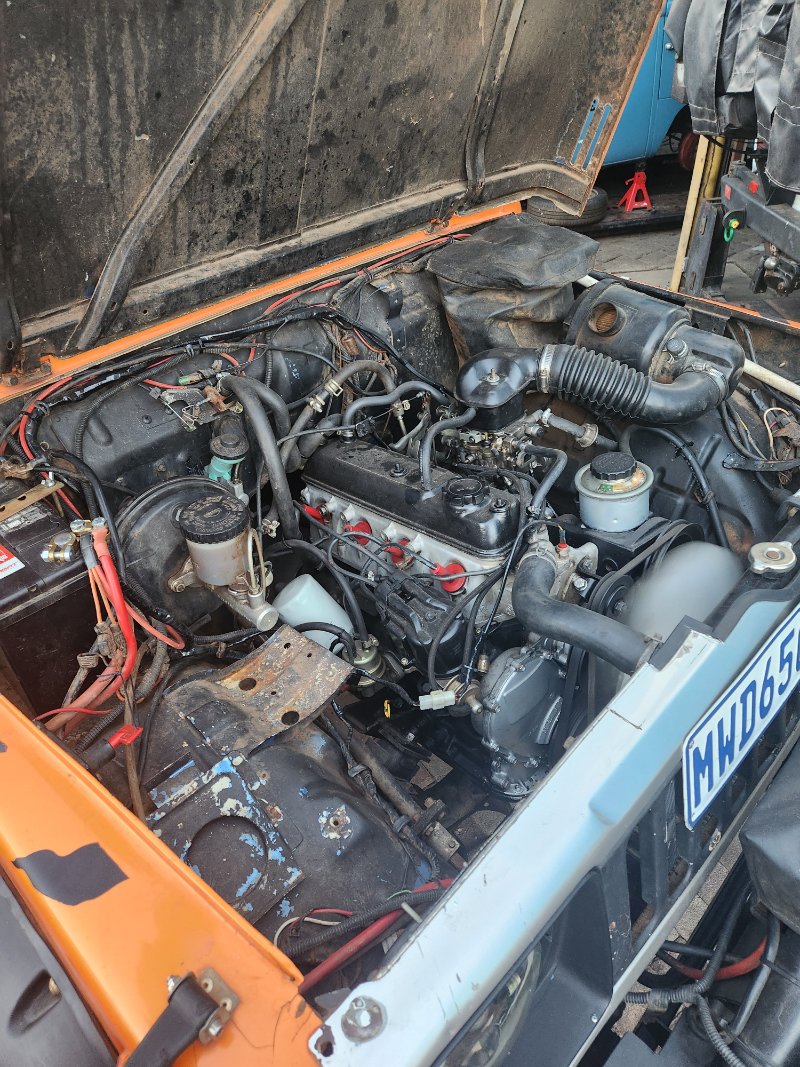

Done some home work and even if I replace the really Kapoet Suzuki Transfer case
Chanses it will strip the gears again was a given fact
So choices started
What Engine and Gearbox and TC options
2ct Turbo diesel Toyota
22R Toyota
4Y Toyota
3SGTE Turbo Toyota
I own enough fast toys so I wanted cheap and Reliable carburetor
Engine choice was Y4 due to cheap and good condition
Then obviously a Hilux gearbox with Hilux Transfer case
But 5 or 4 speed
Choice was 4 speed as the shorter gearbox help with propshaft angles and making conversion easiest
Ok.a tiny Hilux at the end of the day :D
Chris from Pta cote 88 done the work for me as he have built many in his lifetime
And Time I did not have at our shop to do the conversion

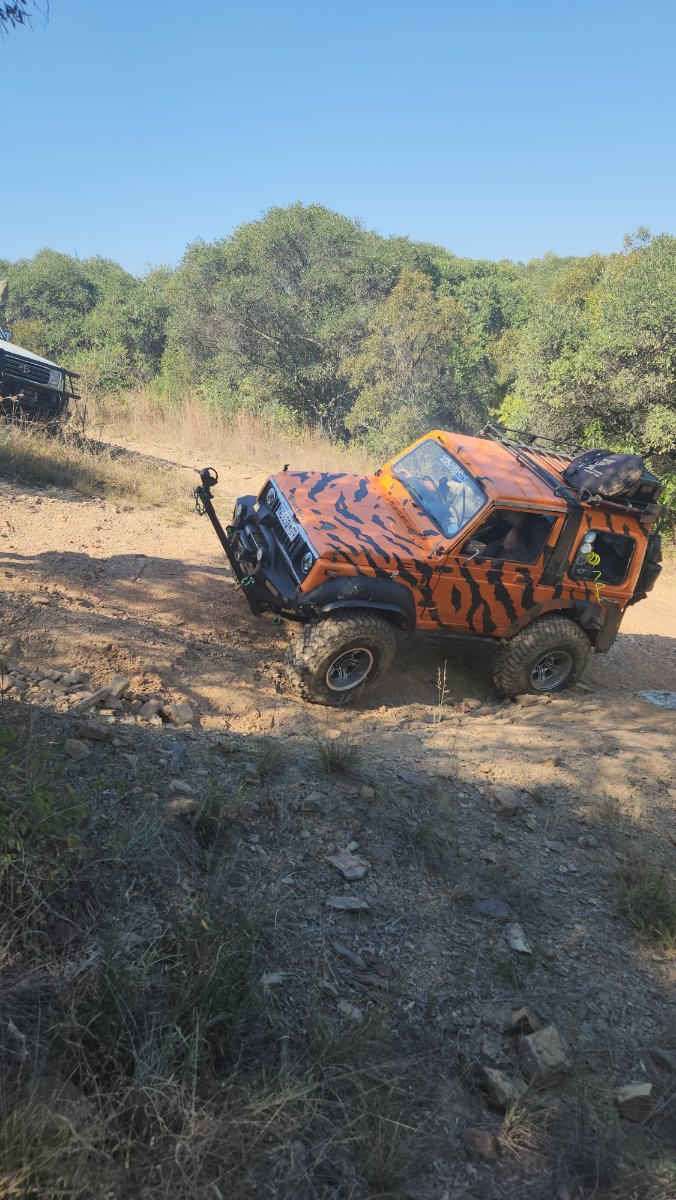

And Turned left up.Hill 49
Some large water erotions and steep

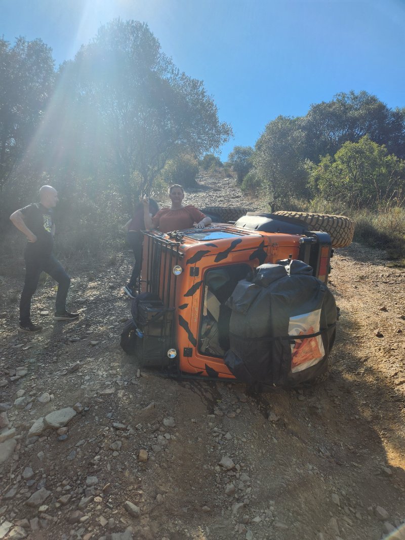

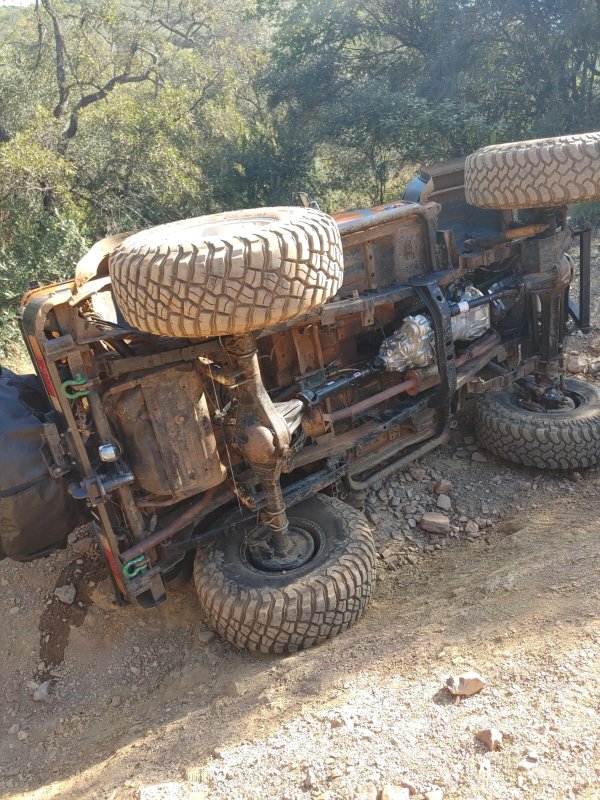

Took the red track and tried to go over the rut and diff lock pushed me to the left in to the tree as the back also slid in the Rutt
I backed a bit but turned steering to slow left to go out of the Rutt
But All slow motion.

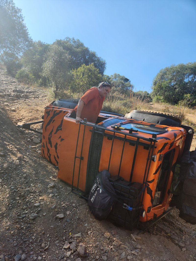

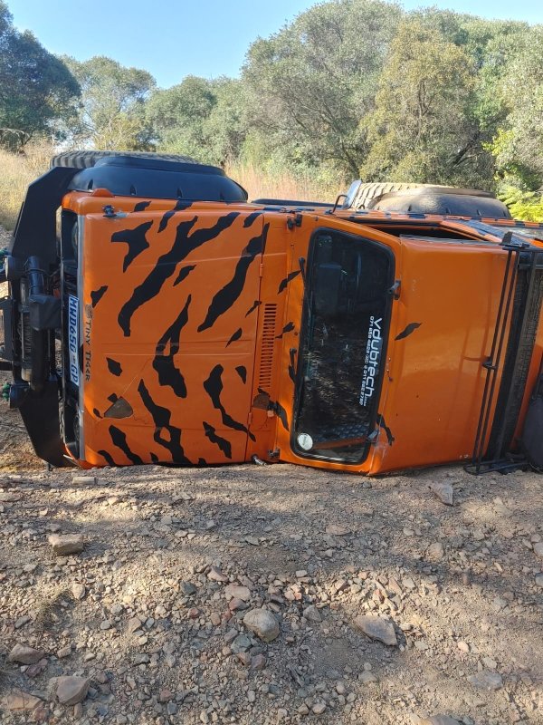

Tiny Tiger πŸ… slowly went on its left side to Sleep
As we go over I was looking that Renays hands is not out the window to brace here self but she was holding on to 2 grab handels with both handels
I gripped the steering and kicked against the floor board
Not to Fall on here :shock:
On our sides
I ask if she was ok and said sit still hold on
Let me just get my feet out and out down that I could stand up and get out driver window

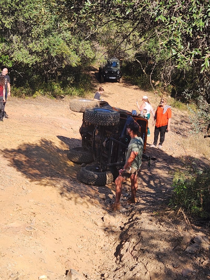

Then here turn and I managed to snap a pic
Very lucky no injuries

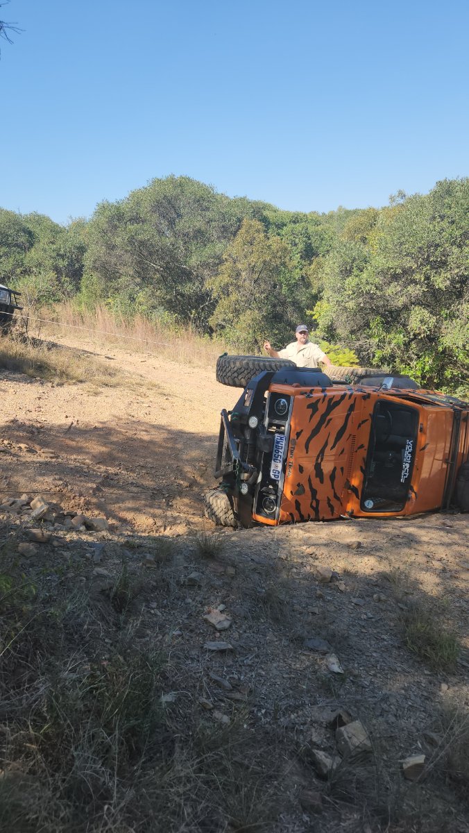

Derick and myself drove back to Lapa area to ask JP to assist us with his Vx and winch
And Ruan with his Jimny offers to help
Back at Sleepy Tiny Tiger I anchored the Jimny to the front of Tiny as when we pull him back on its wheels we don't have a vehicle running away You have seen those on Tic tic and YouTube
But before I got out I made sure I left Tiny in gear and Pulled the Handbrake up
Then JP positioned his Vx to the Driver side
And I attached his winch to a welded hook on my Rock slider
But due to no re enforcement it broke off very easy
I repositioned the Winch line around my Rock slider at mounting Point and 2nd try.
With no effort we winched Tiny back on his wheels
Very lucky with little damage

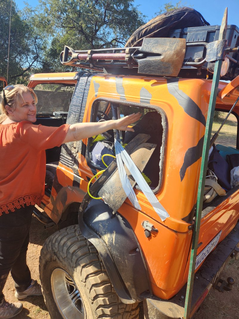

Back canopy window broken

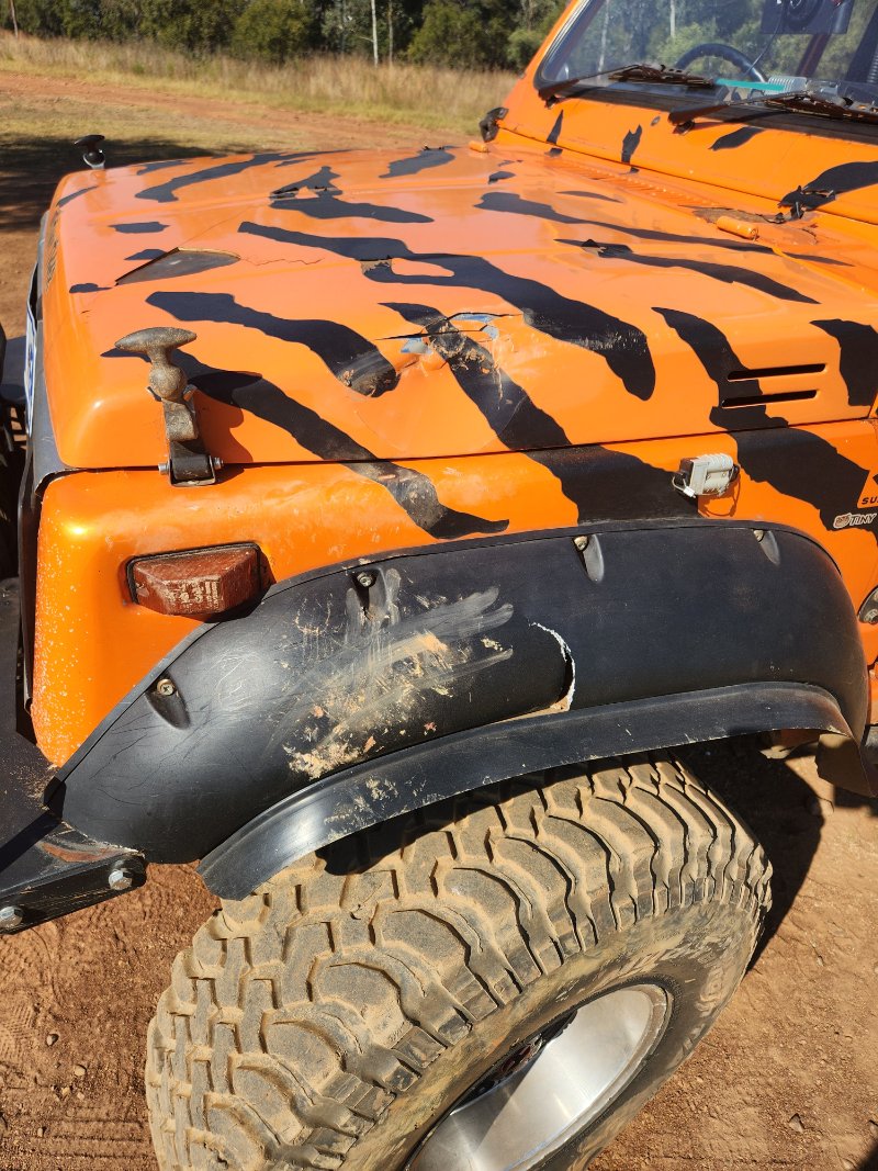

Both left wheel arches damaged
And a dent in the Bonnet
