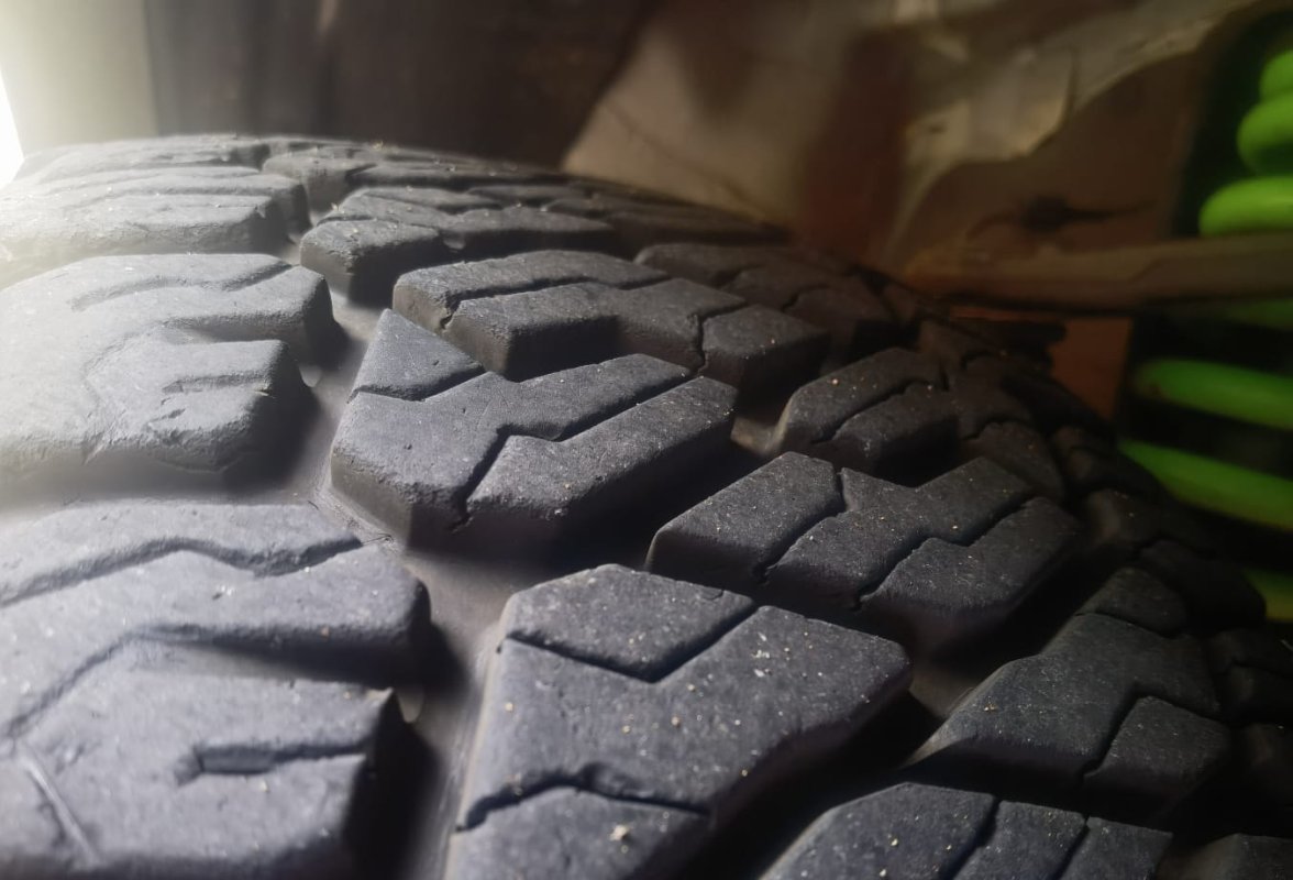

Let me begin by saying that I am not a brand ambassador for Maxxis.
But I wanted to share my experience on the Maxis RAZR A/T
I have always been a BF Goodrich man and have had many sets on previous vehicles. Very hard tyre, but gives you lots of kilos. On a previous set of A/T's, I once got close to 100k KMS on a set and that was at just about every possible pressure and terrain driving from sand to mud to dunes to rocks..
For those that know, I think we can agree, BF's A/T are the ^s%^ est tyres in wet and rain and as for Mud, they will leave you bogged.
On a V6 with lots of power on tap, in wet or slippery conditions. you will go nowhere on BF's.
I ran a set of Maxxis Big horns on a previous vehicle and I was very happy. But is just happened that everytime I bought a new car, they came with BF's.
A few months ago, I took the 24k Plunge and fitted a set of Maxxis RAZR A/T 265/70/17.
Now I am again reiterating, I am not a MAXXIS brand ambassador and I am also not saying it is the best tyre as I have not tried Patriots or Renegades or Coopers or Appolos, so I cannot speak about the performance of those tyres.
I am super impressed with the MAXXIS RAZR A/T.. ( Cannot speak for the MUDS as I have not used them)
The compound is softer than BF's and this molds better especially over rocks. Due to the fact that it is softer, it does not slip as easy as the BF's. if the rocky terrain is wet.
The MAXXIS also do not "chip" on the edges or the threads as the BF's does. I have lost chunks out of the BF's.
Wet weather driving, This where IMO the Maxxis beat the BF's hands down.
Returning from Botswana last week, I exited the pans running at 2bar and due to sheer lazziness I did not deflate back up.
I drove back to Martins drift the next day and hIt a storm of epidemic proportions as I got to Palapye, so much so that one could not see the Bullbar or Ariel.
Due to the opening of the new Kazangula bridge, the entire A1 and A3 is ridiculous with trucks and these that know, the spray from these trucks in the rain is very dangerous. Hit a convoy of ZALAWI copper transport trucks and you know what I am talking about.
The Maxxis stuck like glue to the tar road that was probably a few cms covered with water. My ave speed was 90/100 in the wet due to visibility.( Yeah I know.. very irresponsible) But the point is the confidence I had in the tyres and knowing what it can and cannot do. Okay sometimes you can argue, Its not the car or the tyres, Its the driver.(VIN DIESEL)
As I have experienced driving BF's in wet, I can say, the Maxxis beat the BF's by far in terms of traction and road holding. The Maxxis did not skip a beat.

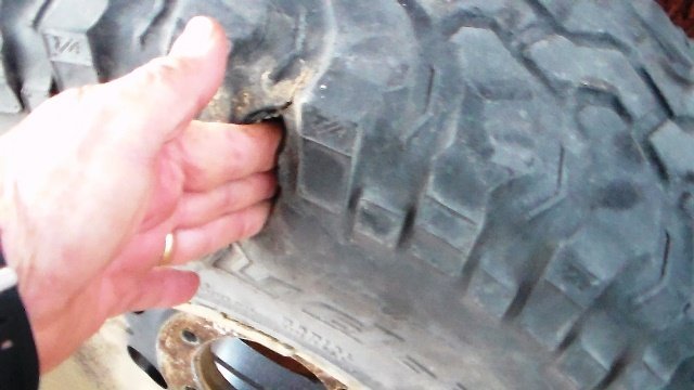

I am also not a MAXXIS brand ambassador. But the set of MAXXIS RAZR A/T's I've got are fantastic. I currently rate them as the best tyres I've had on the truck.

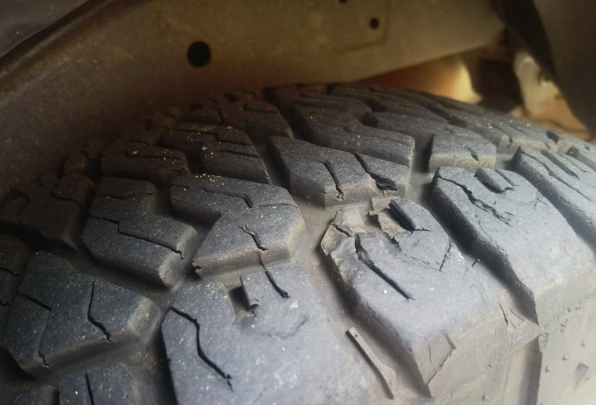

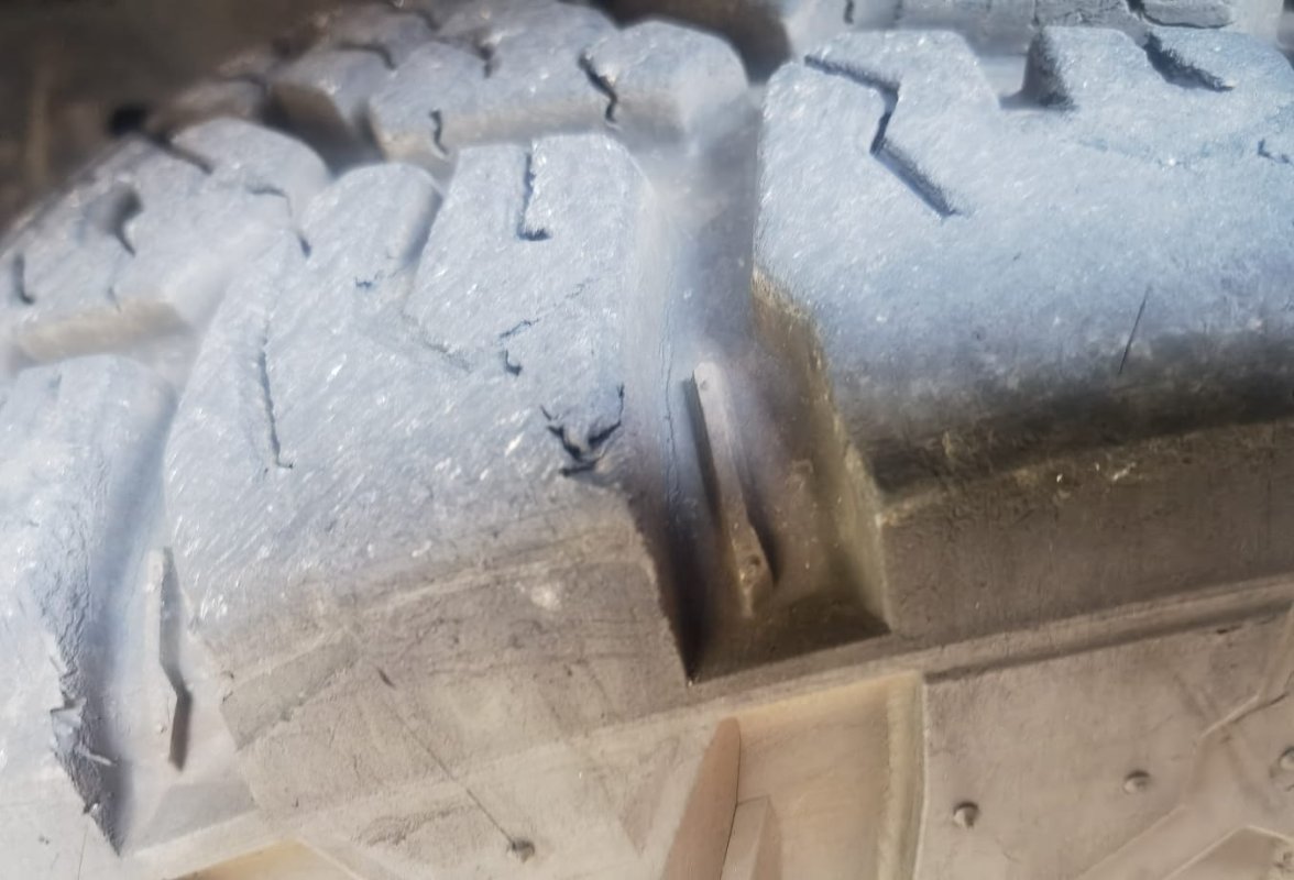

Got about 30 000km on mine.
Lekker things. About 9mm thread left. No punctures, bubbles etc and sometimes I am in a hurry offroad and just need to drive without worrying about what the tyre is up to.
1.8 bar
I checked all 4 now and if I had to nitpick, there are about 3 cracks / chunk issues I can see. Not close to what some of my previous brands were.
Looks like its time to rotate actually...
1.8 bar

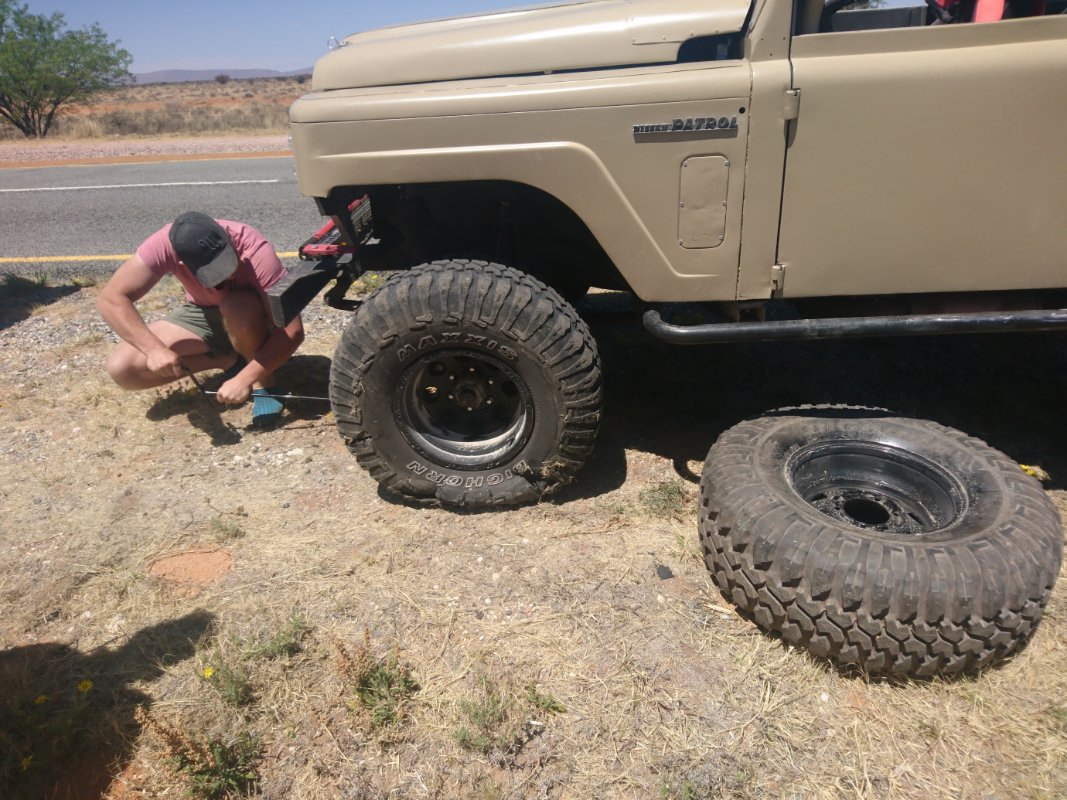

I am also not a brand ambassador, but I only use Maxxis nowadays.
Softer compound compared to BFGs means it does not last as long, but I rather stay alive and being survived by my tires!
Another factor not mentioned in the OP is sidewall. Stronger sidewalls may be better for side cuts, but strong (meaning stiffer) sidewalls means that it can potentially de-bead easier too.
I find that although Maxxis bulge more than BFs, they do not cut easily on rocks or dry sticks, provided pressure is right.

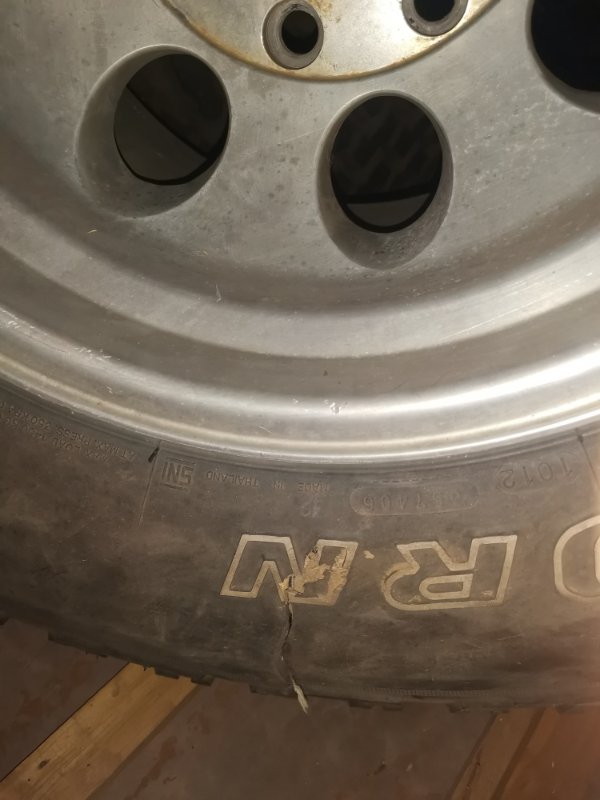

My sets of tires thus far have given me interesting data so far:
1. Continentals World contact A/T -Worst tires I have ever owned by far! No grip wet, dry and tears off when off-roading, threw them away after 20k km 2. Bridgestone dueler A/T - Great mileage, over 110k km of mixed road, tear on the sharp threads and not the best sidewalls 3. Falken Wildpeak (AT01) - Absolutely brilliant tires! Best grip wet and dry, almost 9 years old when I changed them, got them with my Fortuner and did not think much of them, decided I would just drive and trash them, but they would just not let up, drove them personally for more than 60k km, still the best tire I have ever used (AT3W in picture) 4. Cooper AT3-LT - Current tires on my vehicle, about 30k km done on them, not impressed, does well on dry tarmac and not too bad on wet, but showing its age very quickly with sidewall cracks and chuncks torn after some rock driving, also very heavy and has decreased my fuel consumption about 0.8km/l (which is quite bad if you only get 7km/l max). Not the easiest tires to deflate, but fairly strong sidewalls. Had the opportunity to do some testing on the Maxxis AT 811's, very impressed with them! If you have a look at the build of them and pattern in which they increase when deflating, combined with the profile (Like BF) they do not raise any sharp corners, which makes it less susceptible to tear over rocks. Should I have the choice of my next tires it would be a difficult choice between Maxxis AT811 and Falken Wildpeak AT03.
