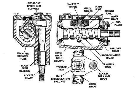

… Maybe check main (often castellated) nut on the
tapered rocker shaft of/below steering box,
If theres any play or movement there it would
be particularly noticeable going through a dip .
