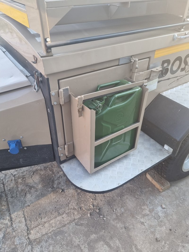

My trailer std have 2 Jerry cans fitted just before the front fenders
I'm looking at building a kitchen cupboard lhs and clothes cupboard rhs
Above the fender
Lhs is fitted to the swing out door so that one might stay
But the RHS one I thought of removing for fitment of a larger clothes cupboard
The actual question is
How often do you use your extra Jerry cans
I was thinking
Seeing they are fitted before the Axle I could build a 50L Ally tank for fuel fitted under the chassis
This will only filled when needed
Then I can still fit a belly water tank above the Axle for weight distribution
My Tow vehicle is a V10Tdi Touareg 90L tank
Average range 800km

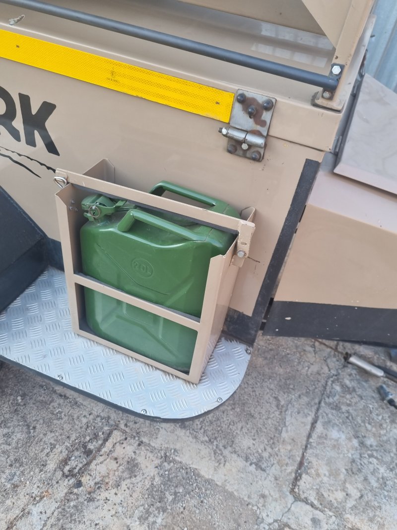

Both Namibia and Bots trips we did I had the 2 x jerrys filled but never needed them.
If you venture into far northern Nam or Kariba area in Zim you will need extra diesel.
Check out one the pictures I sent you. I mounted the rhs jerry can behind mudguard. I had to do some surgery to the anti theft bracket but it worked out fine

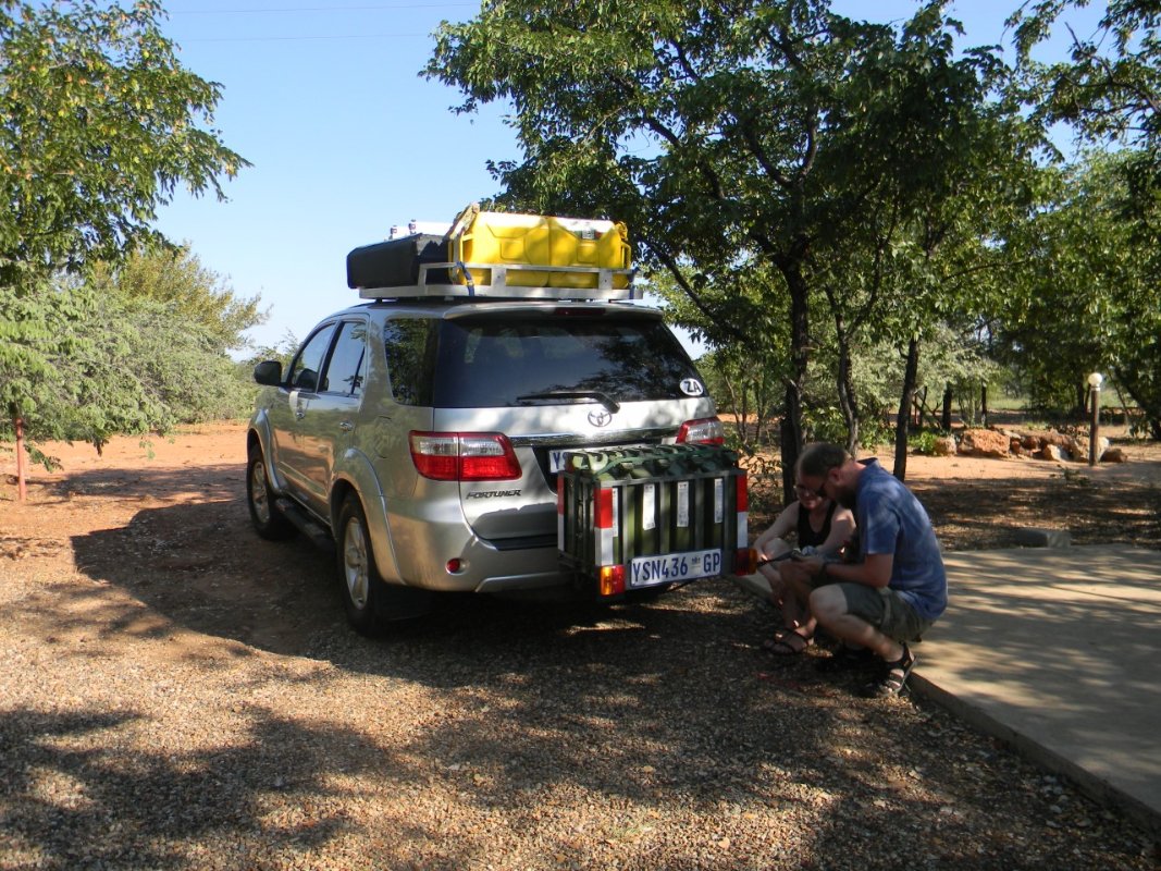

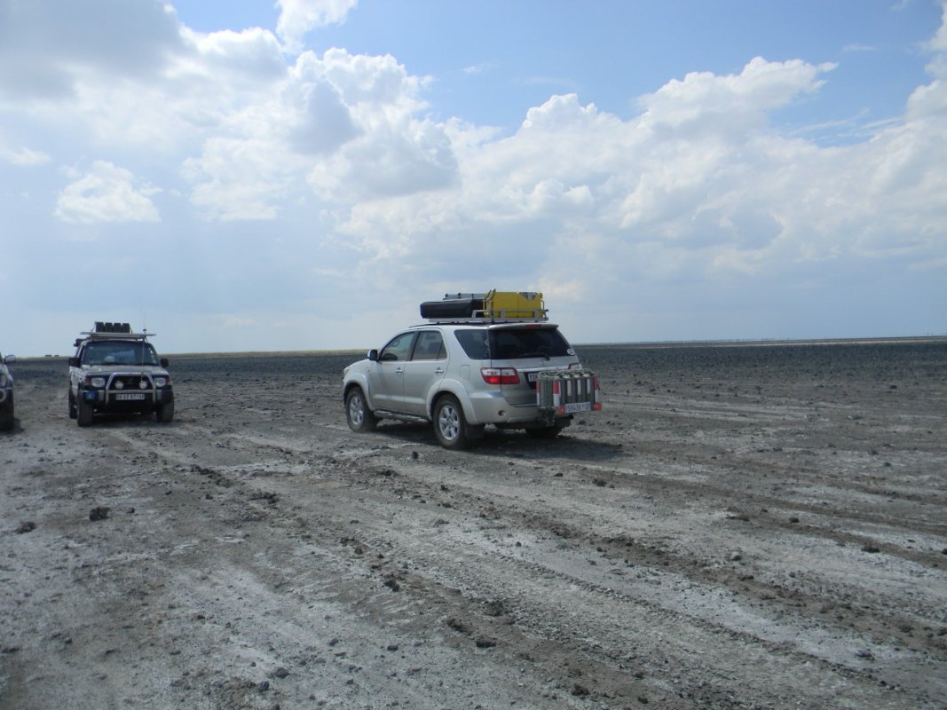

So in 2020 a week before lockdown I did a Botswana trip. We decided to go to Kubu and then OVER the pans ranging north-west over the pans from Kubu. Having lost injectors in the past(on my hardbody) to bad fuel, I am full of nonsense about where I choose to fill up etc...
Thus I decided to build myself a Jerry can bracket that fits on the towing hitch of my vehicle(or any vehicle in the future) that fits 4 Jerry cans. Lights number plate, all as legal as possible.
In this specific trip when we exited the pans, no fuel was available when we exited, and I ended up using 3 of the 4 Jerry cans before filling up again. (The two diesel cans were also used by my fathers Prado who was travelling with us).
So looking at figures, my vehicle gives me 6km/l safely, with its onboard 80-90l tank giving me 500km which is sufficient most of the time. Hitting soft sand I have gotten it down to 1.8km/l average! Thus 144km. Very temperamental when playing.
In most cases I also try to stay out of the dreaded empty zone because the fuel pump does not cool efficiently.
My usual setup when over landing remotely is 2 Jerry cans on the roof when there are large town nearby(200km) and when travelling to very remote areas where you are also staying extended times, I would take my 4 cans again...
