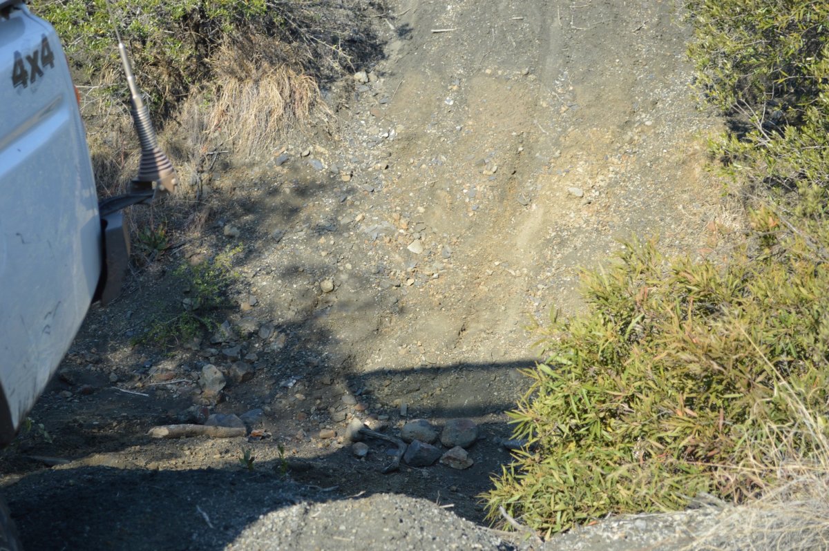

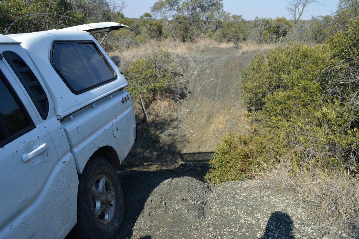

down side of Mahindra
almost to become top view,or so i thought.
turning circle is enormous.to make one in the video
took some maneuvering forward and back until
forgetting where i am on the obstacle.
i did walk it before attempt.
https://www.youtube.com/watch?v=lXeu5ebVgoU
- Location: Krugersdorp
- Has thanked: 89 times
- Been thanked: 142 times
- Posts: 279
- Joined: Mon May 03, 2021 11:25 am
length,with replacement bumpers and tow bar,....very long.
front one,if one takes a look on mahindra plates thread ,acts as a spear.
rear one acts as bulldozer scoop and tow ball plate as a spade.
in a video is narrow ditch and i went until all 4 wheel lost traction and spun free in a air.
im not unhappy about pikup.only giving a warning to what to expect and not to freak out if it happens.
https://www.youtube.com/watch?v=85avx1dsEwU

This is normally an issue with all long-wheel base vehicles. Larger wheels / a lift kit should help in most scenarios. I would also recommend taking a different line - ie: approaching the obstacle at an angle and not head-on. I'm not sure what the towbar on the Mahindra looks like and neither am I sure if you've got a drop-plate installed. But my towbar (and drop plate, as the Patrol is considerably higher than the caravan) is easily removable. This makes a considerable difference in the departure angles. I have forgotten to remove it before a trail on the odd occasion (I think only once - Hennops comes to mind) in which case I've also ploughed massive holes in the ground behind the vehicle...

thanks Ian
bigger wheels-done
lift-done
drop plate can not be removed
distance between center of rear wheel to drop plate,in straight line,1430mm
and this makes departure angle terrible.
bigger wheels-done
lift-done
