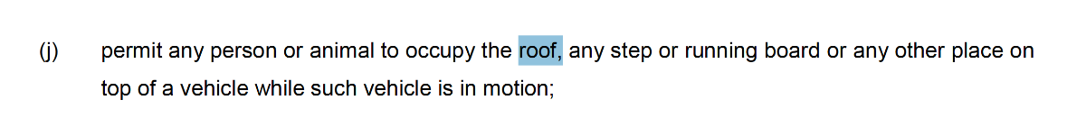

the actual roof load is determined by the manufacturer - and don't be surprised if they suggest zero. Most vehicles are not made to have a load on the roof at all, and the manufacturer will simply not support fitting one at all, and if it causes damage, they won't be liable.
The NRTA makes the following provisions however:
! - you may not transport live animals or people on the roof rack

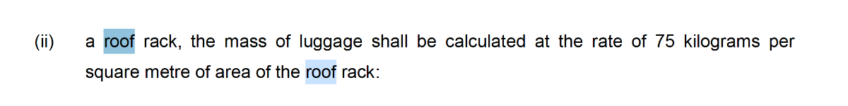

3 - This is for calculating mass, so it's a bit vague, not a regulation as such. It is taken that the load should be 75kg/sqm, in the same way that each person is assumed to be 68kg. but it's not a regulation,

Obviously, you may then not exceed the mass loads on axle and overall - and often those limits are not very high.
Ideally keep the weight low!
