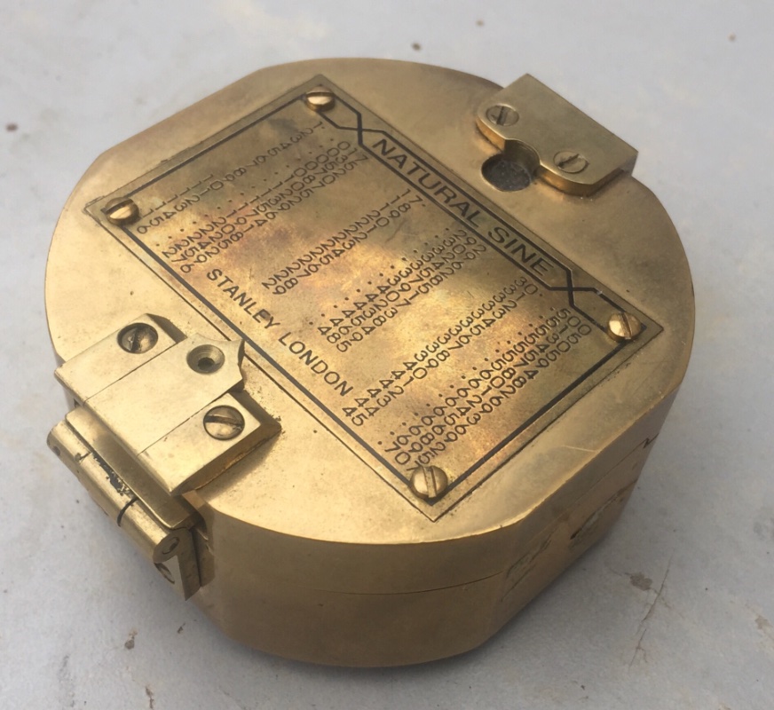

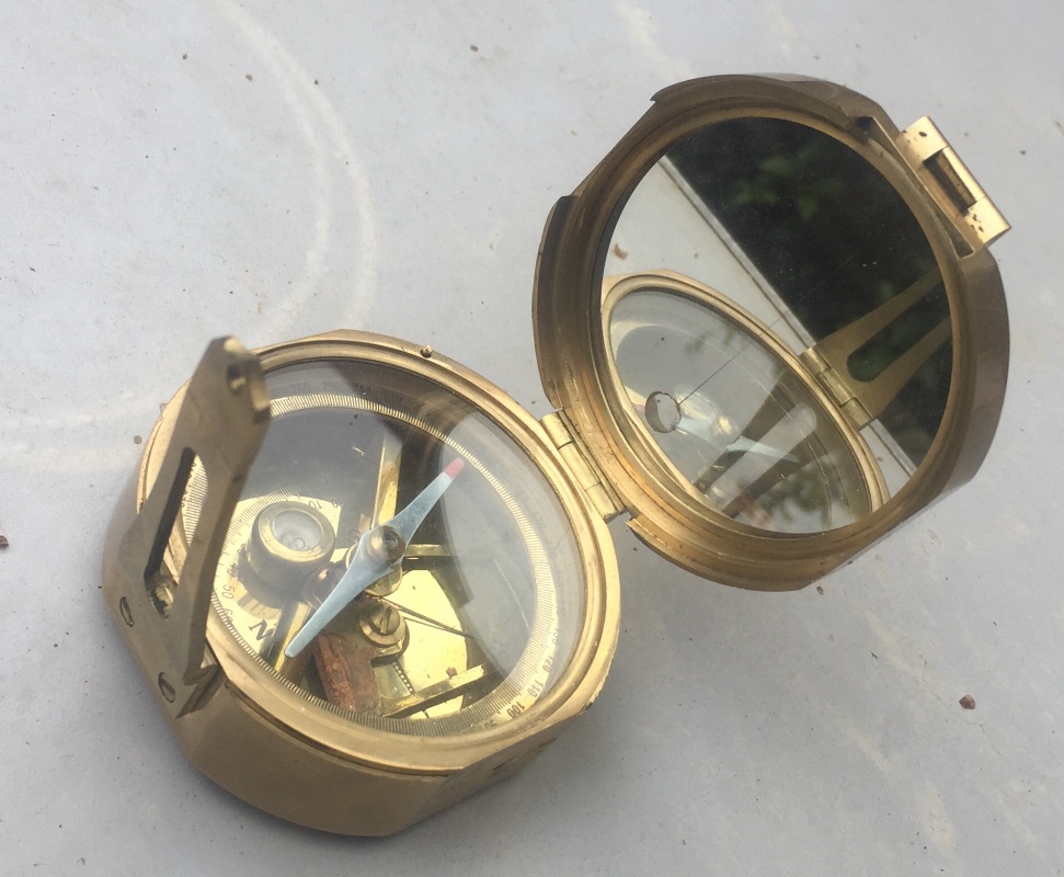

... Im sure there’ll be a way with my
fancy Stanley (Brunton Style) Compass ...
Wooky
Location: JHB
Posts: 335
Post by Wooky »
Nice compass. Those are worth a fortune now days.
