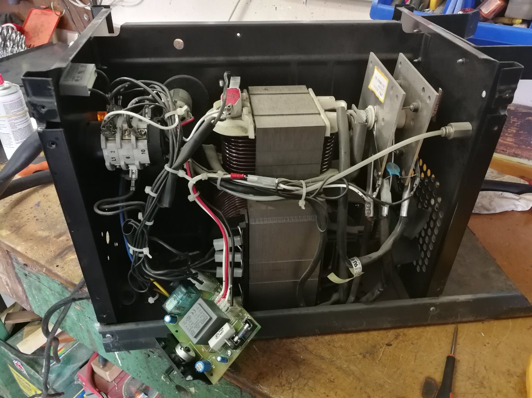

Halfway through building a new security gate for the back door and my welder has died. Why couldn't it have handed in its lunchbox 2 days ago when I could have replaced it. It has lasted 20 years so it isn't bad for a small hobby MIG machine.
attachment=1]IMG_20200327_094317.jpg[/attachment]
#52
I also have a small MIG welder of about the same age that has died a few times. Check the spade connectors on the controller wiring - they sometimes lose "tension" due to old age and heat. Easy fix

I've checked all the connections and put external power onto the drive motor, which works, but still no joy. Seems to controller has died.

Have you test the on/off switch ?

It turns out that thermal cutout switch that failed Grips. As a temporary fix until I can get spares I have bypassed the switch. I'll leave the one cover off the machine and have an external fan blowing into the internals as additional cooling.
